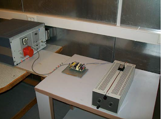

The photo below shows the same power supply undergoing EMC testing, and it can be noted that the unit is connected to a metal plate with metal standoffs.

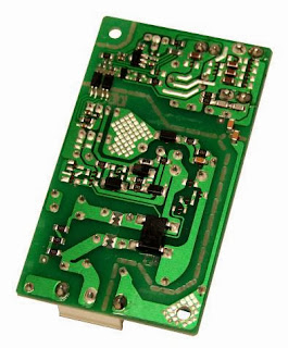

A quick glance of the underside of the printed circuit board will show which mounting holes have traces that need to be grounded. This smaller model has only one grounding point at the bottom right hand side of the board.
2.  Wiring harnesses
In the test photo, it can be seen that the cable harnesses are neatly dressed and are kept away from the power supply.  Wiring that is positioned above or below the unit will pick up radiated noise, thus defeating the purpose of having the EMI filter components.
If I am assisting customers on site, I always pack some tie-wraps in my tool kit to re-route any offending harnesses.
