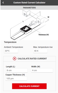

In order to define the rated current for components when measured on different sized PCB conductor traces, Würth Elektronik now has online Rated Current Calculator available through REDEXPERT which allows the user to input the desired copper conductor dimensions (Figure 1).
Figure 1: User interface of Rated Current Calculator with IEC62024-2 Class A 5 mm dimensions entered.

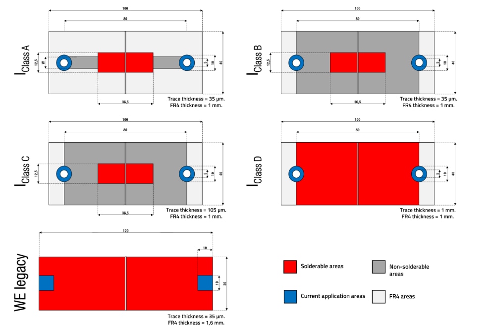

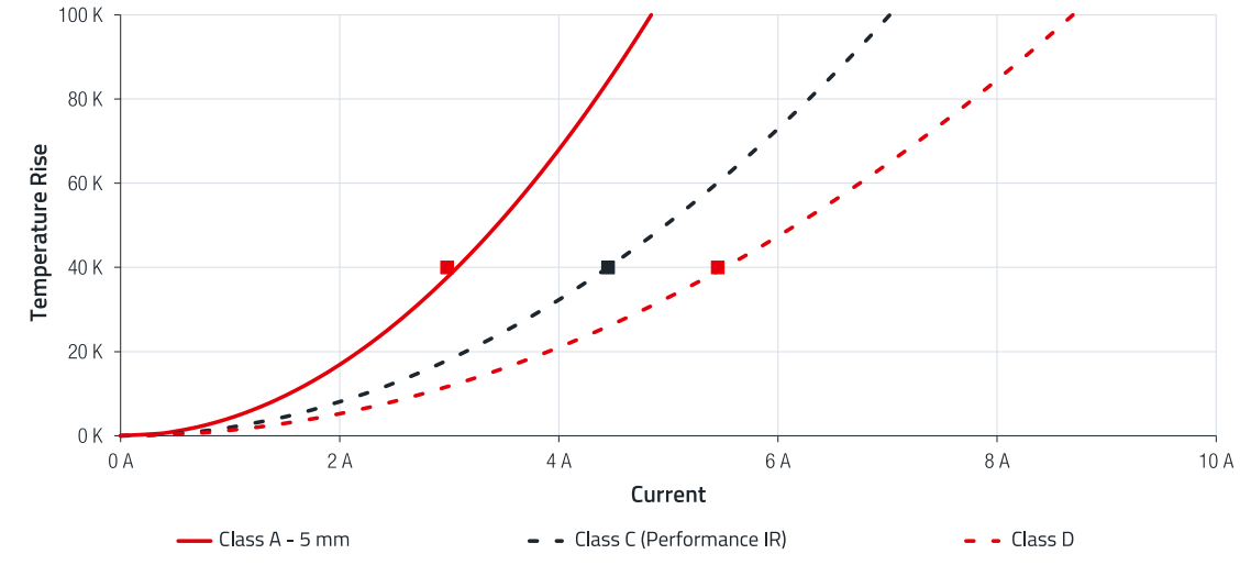

Consider the inductor WE-LHMI (74437346068) which has a performance rated current of 4.45 A (Figure 4). This is measured on an IEC 62024-2 IClass C PCB (Appendix). The graph displays the temperature rise as a result of the DC current for this component on the IClass A 5 mm, IClass C, and IClass D PCB. In addition the chart displays the output from the Rated Current Calculator in the REDEXPERT user interface available online as the data points. As can be seen, the calculated values are comparable to those gathered from component measurements.
This comparison demonstrates how the Rated Current Calculator determines the current with relative accuracy when compared to rated current measurements. It also demonstrates how the rated current of a part is highly reliant on the PCB conductor dimensions with the inductor being able to be operated at even higher currents than the rated current on the datasheet. Additionally, the comparison demonstrates that rated current are values to compare and guide in the selection of inductors before prototyping. It should be remembered that these are basic parameters, considering only DC currents with no additional heat generating parts on the PCB. In real conditions, AC losses and the thermal effects of surrounding components would also have to be considered, which account for most of the losses at higher switching frequencies. The actual temperature rises seen in the end applications will vary considerably dependent on the conditions.
Figure 4: Self heating comparison of WE-LHMI 744 373 460 68 on different IEC 62024-2 PCBs and the calculated current for a 40K temperature rise using the Rated Current Calculator (data points).

Figure 5: Diagram of PCBs used for rated current measurements in the IEC 62024-2
