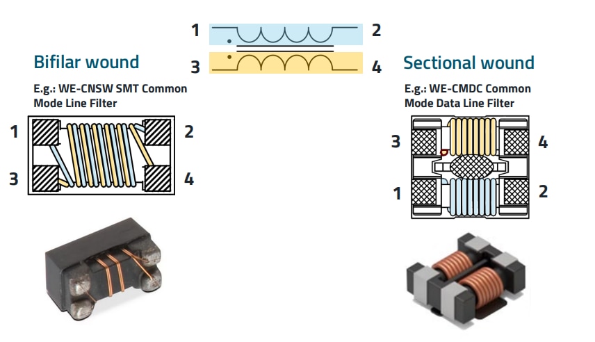

Figure 1: Basic structure of a CMC. Left hand side: Bifilar winding style, right hand side: Sectional winding style.
In bifilar winding style, two wires (or more) are wound together closely in parallel on the core (left in Figure 1). Bifilar winding provides excellent magnetic coupling between the windings, which enhances the inductance for common-mode currents. Since the wires are wound together, the design is compact and easy to manufacture. The chokes are effective at blocking high-frequency common-mode noise due to the high coupling and resulting inductance. The close coupling cancels the inductance for differential-mode currents, making it less effective at suppressing differential-mode noise. The proximity of the wires increases interwinding capacitance, which can degrade performance at very high frequencies. In sectional winding style (inductor on the right in Figure 1), the windings are separated into different sections on the core. The wires are wound in physically distinct layers or areas, with spacing between them. The separation of windings lowers interwinding capacitance, improving high-frequency performance. Due to less coupling, the choke provides some differential-mode inductance, aiding in suppressing differential-mode noise. The separation can improve heat dissipation. The inductance for common-mode currents is lower compared to bifilar winding. Sectional winding often results in a larger choke, as the windings are spaced out.

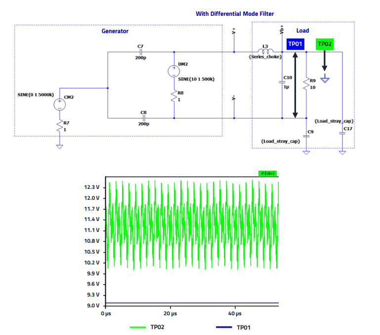

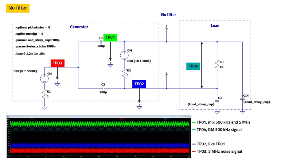

In the following analysis using LTspice, the common mode attenuation and the differential mode attenuation are considered separately. The simulation circuit diagram without choke is shown in Figure 2. The common mode interference signal source (CM) generates a signal with an amplitude of 1 V at a frequency of 5 MHz and is coupled into the circuit via two 200 pF capacitors. The useful signal, the differential mode signal (DM), has an AC voltage amplitude of 1 V at a frequency of 500 kHz and an additional DC voltage amplitude of 10 V, for better visualization in the diagram. Both signals can be viewed at the load R3.
To illustrate how the CM choke acts as part of a filter, the component is considered under different functional states in the time and frequency domain.
The measurements in Figure 3 clearly show that when a single choke (L3) with capacitor (C10) is implemented in one of the two paths, there is no attenuation of the signals with respect to ground, which is the CM signal.
Figure 2: Circuit diagram without CM choke. TP01 to TP04 show the respective voltages
Figure 3: Visualization of the amplitudes of the measuring points in the time and frequency domain (L3 = 1000 µH, C9/C17 = 100 pF).
Both the time and frequency domains are shown; in the time domain, the offset of the signals in the choke path due to the DC voltage can be seen. The time domain shows the 500 kHz and 5 MHz spectral lines at the various measurement points. The levels at the measuring points do not differ in amplitude.

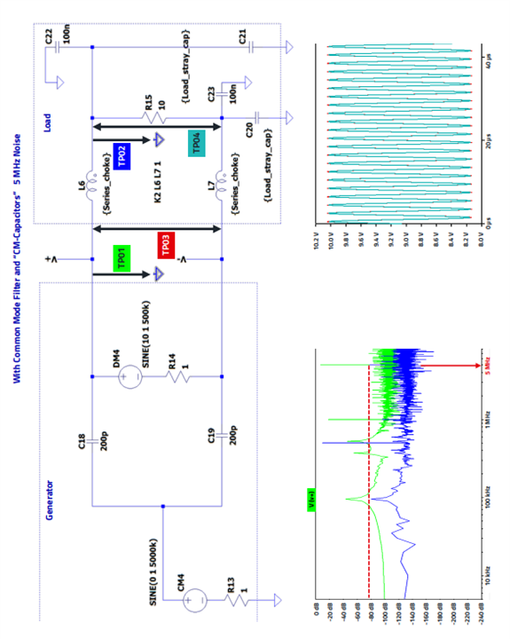

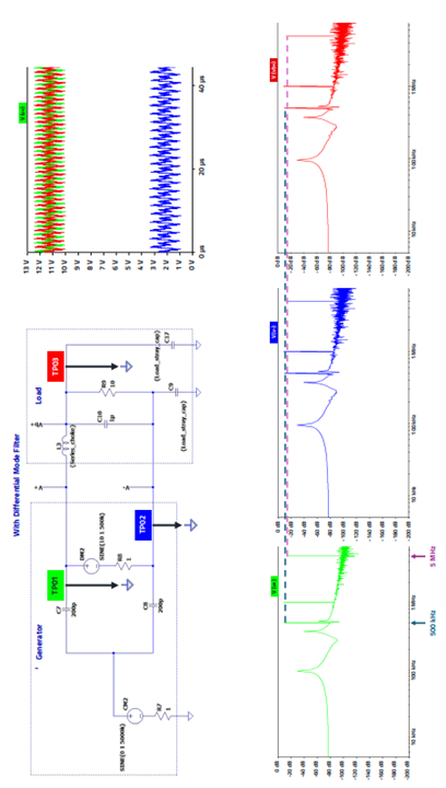

Figure 4 shows that only the differential signal is strongly attenuated in its AC voltage amplitude (TP01, blue).

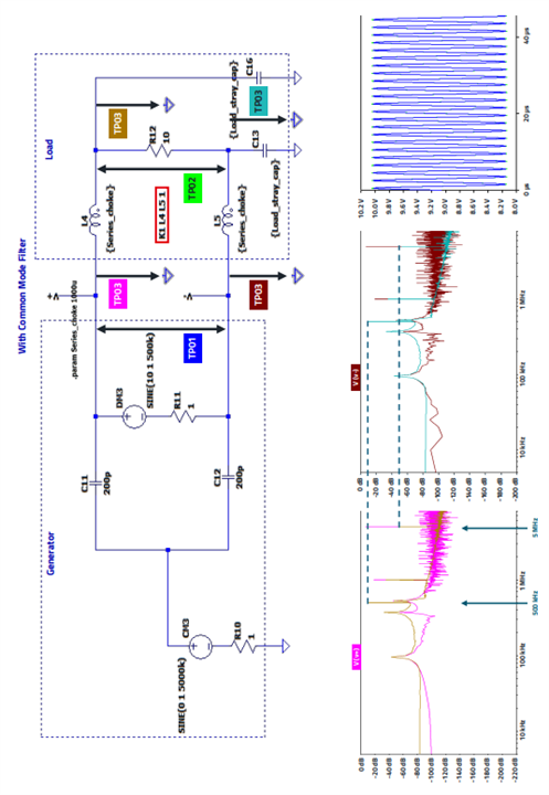

As the CM interference signal is on both paths, i.e. V+ and V-, both paths must also be provided with filter components to attenuate the interference in relation to ground. For this reason, an unbalanced filter (e.g. LC low-pass filter) cannot be used here. Two chokes were used in the setup in Figure 5.
There is a clear attenuation of the interference signal by approx. 30 dB, but the useful signal is also strongly attenuated, as the diagram clearly shows in the time domain. Therefore, the concept of current compensation must be introduced in order not to attenuate the DM signal.
In a common-mode choke, the windings act in such a way that the magnetic fields of the currents in differential mode cancel each other out, while they add up in common mode. The current in differential mode flows through the windings in opposite directions, whereby the magnetic fields generated ideally compensate each other completely. As a result, the inductance for differential currents approaches zero, which does not attenuate the normal signal flow. With common mode currents, the currents flow in the same direction through both windings, whereby the magnetic fields are added together, and a high inductance is created.
Figure 4: Visualization of the amplitudes of the measuring points behind the filter in the time domain, (L3 = 1000 µH, C9/C17 = 100 pF).
Figure 5: Filter with two chokes (L1, L2), Both DM and CM signals are attenuated. TP05/TP06 show the differential-mode attenuation (signal at 500 kHz), TP01/TP02 and TP03/TP04 show the common mode attenuation (“noise” at 5 MHz).
This high inductance provides a high impedance for high-frequency common mode interference and effectively attenuates it.

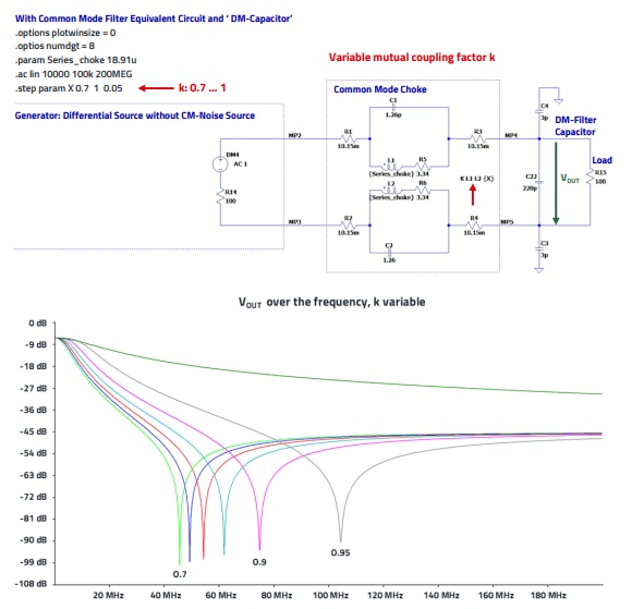

As mentioned before, the mutual coupling factor K quantifies the coupling between the two windings of the choke. On the other hand, the mutual coupling factor K of a CM choke not only indicates the strength of coupling between windings, but also reflects the level of stray inductance. A special “trick” can be used for additional differential mode attenuation. When the mutual coupling factor is reduced, a leakage inductance (stray inductance) is created which can be used as part of the DM inductance and thus as a DM filter; again, with an additional capacitor (X-capacitor) connected in parallel to the load. In many cases, the Y-capacitors, which add up to half their value as an X-capacitor, are already sufficient. A high K means strong coupling and minimal stray inductance, which reduces the choke’s impedance to DM currents, lowering its DM attenuation. A lower K corresponds to higher stray inductance, increasing DM impedance and improving DM noise suppression. However, a high K is critical for maximizing CM attenuation, as it increases the choke’s impedance to CM currents. The design must balance K to manage the trade-off between CM and DM attenuation or use additional components to address DM noise such as SMD ferrite beads, to increase the attenuation in high frequency range, but to minimize the influence of attenuation on useful signals in the lower frequency range. However, the statement is fully applicable to sectional winding, where K can be adjusted to balance CM and DM attenuation. For bifilar winding, K is inherently high, so the trade-off does not apply in the same way. Instead, additional measures like ferrite beads are needed for DM attenuation.
Figure 6: Filter with two inductors in mutual inductive coupling. The signals of TP01 and TP02 overlap in time domain, the signal of TP02 is behind the signal of TP01 in the graph.
Figure 7: Common mode choke filter with additional Y-capacitors (C22, C23). The signals of TP03 and TP04 overlap in time domain, the signal of TP03 is behind the signal of TP04 in the graph.
Figure 8 shows the influence of the coupling factor K on the attenuation of the DM attenuation, for better visualization the CM source level was set to 0. Figure 8 shows that even a small reduction in the K-factor can have a major effect on the attenuation of the differential signal. In the present simulation, an inductor without the non-linear behavior of the ferrite material on the impedance over the frequency is used. In practice, however, the course of the complex permeability over the frequency and thus the non-linearity of the inductance over the frequency must be taken into account. Furthermore, the parasitic parameters, such as the parasitic capacitances of the windings, must be considered. The first step in acquiring these parameters is to determine the equivalent circuit diagram of the CM choke
Figure 8: Influence of the K-factor to the DM attenuation.

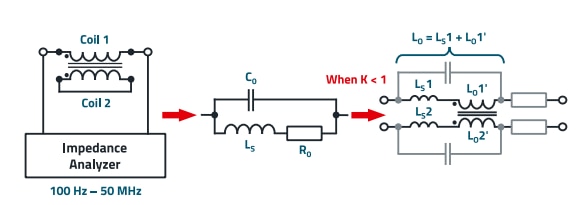

2.2 Measurement and calculation of the parameters for the equivalent circuit diagram of the CMC.
The equivalent circuit diagram of the choke is required not only for the simulation of the CMC but also for understanding the component if the filter insertion loss is to be considered taking into account the real properties. Data can be taken from the data sheet, but some parameters must also be measured and calculated. The following is a summary. When developing the equivalent circuit diagram of a CMC, the parameters of the equivalent circuit diagram are mainly determined by measurements, which are carried out in three steps. Figure 9 shows the equivalent circuit diagram used here.

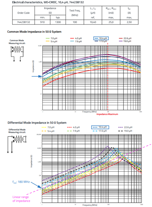

The selected common-mode choke is the WE-CMDC, Order Code: 744238132, the data sheet shows the following parameters that can be used to further determine the missing values (Figure 10)
Figure 9: The equivalent circuit diagram of the CM choke used here. The equivalent loss resistance (RLOSS_X), in has been converted here from a parallel circuit to a series circuit
Figure 10: Electrical parameters from data sheet, CM choke WE-CMDC, 744238132
The choke has an inductance per winding of 10.40 µH, the inductance was measured at a frequency of 100 MHz. At this frequency, a scalar impedance in the range of 910 – 1300 Ω is specified. The DC resistance, i.e. the copper resistance of a winding, is a maximum of 25 mΩ.
The blue curve in the upper diagram in Figure 10 shows the CM impedance, which corresponds to the impedance of a winding (L1 or L2) with the ferrite core, as the windings are connected in parallel in the same winding direction. The maximum of the curve (dark blue) is at approx. 100 MHz, the resonance is not very pronounced. A direct linear increase in impedance from 1 MHz is not recognizable, i.e. the ferrite material has a lossy permeable part over the entire frequency range, which leads to the flat curved shape of the curve. The lower diagram in Figure 10 shows the DM impedance. Up to approx. 50 MHz the impedance increase is linear. The diagram also shows a resonant frequency at approx. 180 MHz. The resonant frequency is pronounced, it is caused by the parasitic coupling capacitances of the windings.

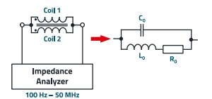

In the next step, the impedance of the primary coil is measured, and the ferrite loss resistance and the parasitic winding capacitance are determined. The basic measurement setup and the corresponding equivalent circuit diagram are shown in Figure 11.
Figure 11: Schematic measurement setup for determining the parameters for the equivalent circuit diagram of the CM choke.
The inductance L0, including the leakage inductance LS, the resistance R0, which corresponds to the ferrite loss, and the leakage capacitance C0 of the winding are measured. R0 and C0 are the total values of the primary and secondary coils. L0 is the sum of the magnetic fluxes generated by the primary and secondary coils. The inductance appears to double, but the primary and secondary coils are connected in parallel, so the result remains L0. The result of the impedance measurement is shown in Figure 12. To determine the inductance, an area of the impedance curve is selected, that is as linear as possible.

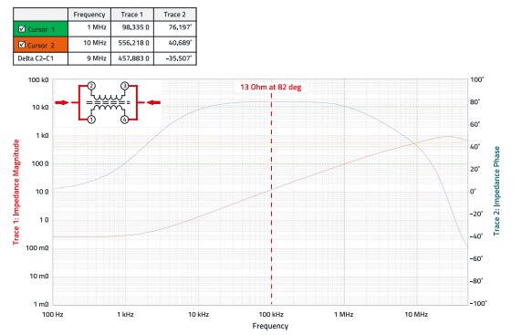

Figure 12: CM impedance of the coil in the frequency range between 100 Hz and 50 MHz, red: impedance, blue: phase.
In this area, the phase shift of the impedance should be over 80°, as this indicates a dominant inductance and capacitive and ohmic losses are negligible. This ensures that the inductance is calculated based on a realistic model. If the inductance were calculated in a range with significant loss components (phase components below 80°), larger deviations could occur, as the loss resistance falsifies the measurement.
The diagram in Figure 12 shows that at 100 kHz the impedance is approx. 12 Ω at a phase angle of 82°. This results in the following calculation:
Z at 100 kHz: 13 , θ = 82°
With
results in:
Resistance R: 1.67 Ω → RO = 3.34 Ω
Inductive Reactance XL: 11.88 Ω
Inductance LO: 18.91 µH

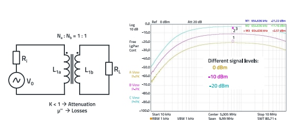

The parasitic capacitance is determined at the resonance point of the choke, which is above the frequency of 50 MHz. For this purpose, the insertion loss is measured as shown in Figure 15 using an RF network analyzer.
Three different signal levels were measured in order to take into account any shifts caused by the influence of the ferrite material.
The curves in Figure 15 all show a resonance at 241.77 MHz. The stray capacitance can now be calculated as follows.

Figure 15: Insertion loss of the DM impedance with three different signal/measurement levels.

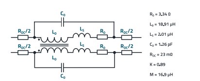

The measurement of the copper resistance RDC at direct current is still missing, which is surprisingly difficult, as this measurement of a very small resistance value depends on the ambient temperature and the test object contact (despite Kelvin terminals). Ultimately, the value was measured under controlled conditions; the setup and measurement results are shown in Figure 16. As the primary and secondary coils have the same number of turns, the measured value also applies to the secondary coil. The value determined for the copper resistance RDC of a winding including the connections is 23 mΩ.
Figure 16: Schematic measurement setup for determining the copper resistance of the windings.
Overall, this results in the following equivalent circuit diagram for the CM inductance (Figure 17).
Figure 17: Equivalent circuit diagram of the CM choke WE-CMDC, order code: 744238132.

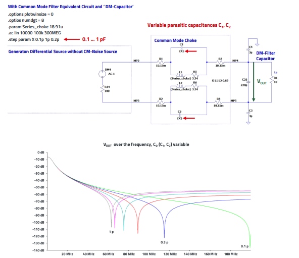

The influence of the parameters C0 and K on the filter properties are shown below. The circuit diagram shown in Figure 18 is used to show the influence of the parasitic capacitance C0 of the CMC
Figure 18: Circuit diagram and output voltage (VOUT) of the filter to show the influence of C0. As this is a simulation, no capacitive stray effects due to measurement set-up are included.
The parasitic capacitance in the windings of this inductor arises from the proximity of adjacent turns of the windings, leading to unintended capacitive coupling. This coupling forms a parallel resonance with the inductance of the windings, creating a self-resonant frequency which is clearly visible in Figure 18. Below the self-resonant frequency, the inductor exhibits primarily inductive behavior, providing effective common-mode noise attenuation. However, as the frequency approaches the self-resonant frequency, the parasitic capacitance causes the inductor's impedance to drop significantly. At frequencies above the self-resonant frequency, the inductor's impedance becomes capacitive, reducing its effectiveness in attenuating CM noise. This shift adversely affects the insertion loss, particularly at higher frequencies, where the inductor no longer provides significant attenuation. As can be seen in Figure 18, even small values of parasitic capacitance such as 0.3 pF lead to strong resonance effects at a frequency in the range of around 115 MHz. This pronounced parallel resonance has a high Q factor. For this reason, the presence of parasitic capacitances can introduce unwanted resonances into the circuit, potentially amplifying certain noise frequencies instead of suppressing them, and easily coupling into neighboring circuits. To mitigate these effects, careful design practices are used, such as selecting the proper inductor, minimizing coupling at the PCB, damping resonances with additional losses like resistors, and adding differential mode SMD ferrites that are lossy in this frequency range. These measures help minimize parasitic capacitance and extend the effective operating frequency range of the inductor.

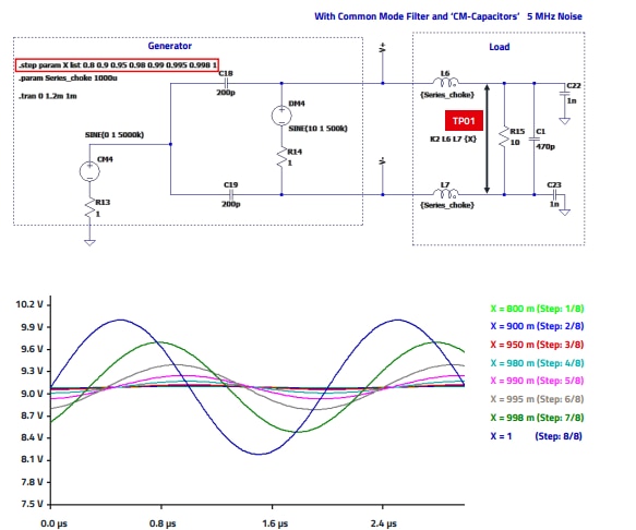

The circuit diagram shown in Figure 19 is used to show the influence of the coupling factor K, resp. the Mutual inductance M of the CMC over the DM voltage VOUT. A high coupling factor, close to 1, indicates strong magnetic coupling, meaning that most of the flux generated by one winding links with the other.
This enhances the inductance seen by CM currents, improving the inductor's ability to attenuate CM noise. Consequently, the resonant frequency for CM noise is lowered due to the increased effective inductance.
The resonant frequency is primarily influenced by the leakage inductance and the parasitic capacitance. Thus, as shown in Figure 19, a higher coupling factor reduces leakage inductance, which in turn raises the resonant frequency. With a higher K, the inductor provides better CM noise attenuation across a broader frequency range before reaching resonance.
Additionally, the insertion loss for CM noise improves because the inductor remains effective at higher frequencies. Conversely, if K is low, the leakage inductance increases, lowering the resonant frequency and potentially reducing the effective frequency range for noise suppression. This may also result in a lower insertion loss at higher frequencies.
In practical applications, a CMC needs to be selected which balances high coupling for effective noise suppression with a proper selected leakage inductance to prevent unintended impacts on DM signals
Figure 19: Circuit diagram and output voltage (VOUT) of the filter to show the influence of M (K).

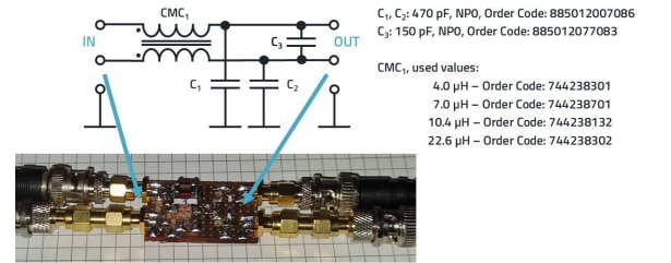

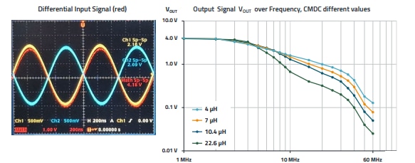

Figure 20 shows the schematic of a simple CM filter. To show the effects of selecting different values of the WE-CMDC series the insertion loss was measured. The filter is built on a breadboard with a GND layer; the GND layer was omitted in the area of the CM choke in order to keep the capacitive coupling small. The input signal is a differential signal with an impedance of 50 Ω to ground, i.e. 100 Ω differential impedance. The output was fed to the oscilloscope via a differential probe with 1 MΩ differential input impedance. Figure 21 shows the DM attenuation. The double logarithmic diagram in Figure 21 shows that the differential attenuation is low for all selected values up to approx. 5 MHz. Beyond this frequency rage, the attenuation depends not only on the selected inductance value, but also on the behavior of the imaginary part of the permeability µ'' of the ferrite material. Of course, the filter with the higher inductance also shows a higher attenuation, but the non-linearity, especially the kink at approx. 35 MHz, is due to the ferrite material. Above 35 MHz, the attenuation increases significantly for all 4 filters, as the ferrite material comes closer to its resonant frequency and thus its higher impedance range where not only µ', but also µ'' increases significantly.
Figure 20: Schematic and setup of a CM filter, using different common mode chokes of the WE-CMDC series. “IN” is the side on which the measurement signal (in practice the interference signal) was applied.
Figure 21: DM attenuation of the filter, shown in Figure 20.
Mutual inductance (M) decreases with frequency as the ferrite’s real permeability (µ') drops, increasing LSTRAY and DM attenuation. The ferrite’s imaginary permeability (µ'') increases at higher frequencies, introducing resistive losses that further enhance DM attenuation. Although LSTRAY behaves like an air-core inductor, its value is influenced by the frequency-dependent coupling (M) with the core material. As a result, DM attenuation depends on the ferrite material because its permeability variations affect both LSTRAY and resistive losses across the frequency range.
The CM attenuation is shown in Figure 22. A higher inductance leads to a higher impedance, the markers each show the 3 dB cut-off frequency. All chokes show no pronounced resonances, in the range around 80 MHz there is a weak parallel resonance due to the design. In the range between 200 MHz and 300 MHz the impedance turns the chokes into the capacitive range, the impedance increases. This range is also determined by the measurement assembly and can vary depending on the layout and setup.
Nevertheless, in the 50 Ω system of the network analyzer, with all inductance values, the setup enables at least an insertion loss of 40 dB at 100 MHz, with the 22.6 µH choke over 50 dB.

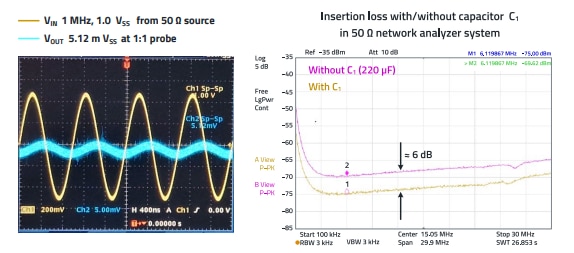

By coupling the second winding to ground, an additional reduction in noise can be achieved. One parameter for a high attenuation is of course the inductance of L1, another is the mutual coupling factor, which should be in the range below 0.9 as the stray inductance determines the attenuation. The higher the capacitance of C1, the lower the frequency range that can be attenuated. A typical value is 220 µF, which can be used to filter into the kHz range. The ESR of the capacitor should be low, which is why a polymer capacitor was used. Some measurement signals to illustrate the effectiveness are shown in Figure 24.
The signal attenuation at 1 MHz is approx. 73 dB; if capacitor C1 is removed, the attenuation is reduced by approx. 6 dB. This reduction in attenuation is practically constant from 200 kHz up to 30 MHz.
Figure 24: Signal attenuation and insertion loss of the filter with coupled inductor.
