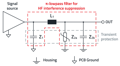

2. EMI FILTER OF AN ASYMMETRICAL SIGNAL INTERFACE WITH TRANSIENT PROTECTION
While unbalanced signal interfaces only use one data line per signal, interference emissions and interference immunity requirements are generally higher than with balanced signal interfaces.
Figure 1 shows a possible filter circuit for attenuating interference emissions and ensuring interference immunity.
Figure 1: Unbalanced signal interface filter.
A digital (square wave) signal with amplitude of 5 VPP and frequency of 5 MHz on the data line is considered below. The standard value of 90 Ω is assumed for the impedance of long data signal lines. There is a voltage of 5 VDC at 2 A on the supply voltage line.
Since the requirements for the filter circuits for the data line and the supply voltage line differ, the filtering of the data line will be described first.
2.1 Filter circuit of the data line
To attenuate high-frequency interference on the data line, the two impedances Z1 and Z2b in Figure 2 form a low-pass π filter with the inductor. Protection against transient overvoltage is ensured by a transient protection device Z2a.
Figure 2: Filter on the data line of an unbalanced signal interface.
The component selection is explained below using the example of the signal driver described above.

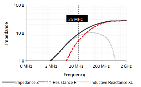

Step 1: Determination of L1
First, L1 is dimensioned and selected, where an SMT ferrite or an RF–ferrite can be used. Further information on the use of inductors or SMT ferrites is given in ANP025 and in ANP129.
The ohmic, or resistive, component of the impedance of the SMT ferrite should be as low as possible up to the fifth harmonic of the signal frequency, and the impedance at this frequency should be less than one-tenth of the system impedance to avoid affecting the useful signal. In our example, the fifth harmonic is at 25 MHz, as the signal frequency is a 5 MHz square wave. Since the system impedance in the example is 90 Ω, the impedance at 25 MHz should be at most about one-tenth, i.e., no more than 9 Ω.

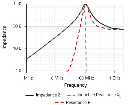

Figure 3 shows a typical impedance curve as seen in the data sheets. The proper inductors, in the example a SMT-ferrite can be selected with the help of REDEXPERT.
Figure 3: Impedance characteristics WE-CBF SMT ferrite 74279273.
From Figure 3, it can be concluded that WE-CBF 74279273 SMT ferrite can be used.

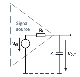

Step 2: Determination of Z1
Z1 is a capacitor that can be optionally used to attenuate interference frequencies in the RF range above 500 MHz originating from the driver. Based on practical experience, a desired attenuation of 10 dB should be achieved at 500 MHz, resulting in a voltage ratio of VOUT/VIN = 0.316. The capacitor impedance Z1 (capacitive reactance) can be determined using the voltage divider in Figure 4.
Figure 4: Voltage divider for calculating the capacitor Z1
image(1)
Where:
  • VOUT is the voltage across the capacitor Z1 (V).
  • VIN is the total input voltage to the circuit (V).
  • VOUT/VIN is the voltage ratio from the attenuation.
  • Ri is the internal resistance of the signal source or system impedance (Ω).
  • Z1 is the capacitor impedance (capacitive reactance) (Ω).
Given Ri = 90 Ω, the calculated Z1 from (1) is approximately 42 Ω. Next, the capacitance value (CZ1) required for attenuation at f = 500 MHz can be calculated as follows:
image(2)
Substituting the known values in (2),
Based on these calculations, the WCAP-CSGP 885012005040 MLCC capacitor with a value of 10 pF and a voltage withstand rating of 25 V is suitable. This capacitor is an NP0 ceramic type, offering more stable voltage and temperature behavior compared to X7R ceramics. When considering critical factors such as signal integrity due to the cutoff frequency of the filter and the capacitive load, it's important to account for parasitic capacitances of the conductor tracks and, if necessary, interface connectors.

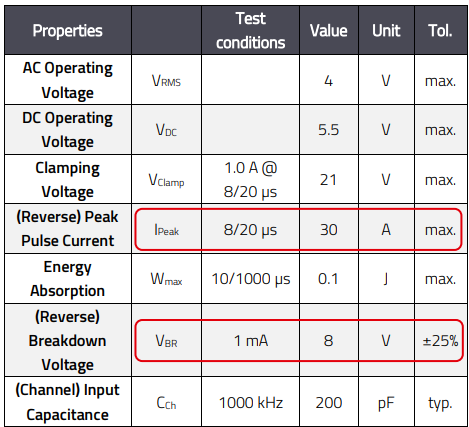

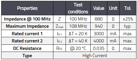

Based on this value and the available space in the application, an SMT multilayer varistor is selected, which serves as the basis for the decision. In this case, the WE-VS 82536040 (Table 1) varistor is selected, whose operating voltage (VDC) is 5.5 V and is therefore slightly below the required operating voltage. Once the varistor has been selected, the following calculations determine whether the correct selection has been made or not.
According to the IEC/EN 61000-4-5 standard, the test pulse for surge between line and ground is VSURGE = 0.5 kV and the source impedance is 42 Ω.
Table 1: Electrical properties of WE-VS 82536040.
To simplify our calculation, we specify the clamping voltage during the current surge as twice the breakdown voltage VBR. This value (2 x 8 = 16 V vs. clamping at 21 V) is slightly lower than the actual clamping voltage of the varistor at the surge current.
Approximation: VCLAMP ~ 2 VBR.
The varistor voltage (VVAR or VBR) can be found in the varistor data sheet (see Table 1).
The peak varistor current can be calculated as follows:
image(4)
Where:
  • ICLAMP, MAX is the peak current of the varistor (A).
  • VSURGE is the test pulse voltage for surge (V).
  • VBR is the varistor voltage or breakdown voltage at 1 mA (V).
  • ZSOURCE is the source impedance as per IEC/EN 61000-4-5 (Ω).
Substituting the known values in (4),
Considering the varistor tolerance of 25%, the maximum clamping current is 11.62 A and is therefore below the maximum peak current of the varistor (30 A).
Energy consumption and power loss calculation:
To simplify our calculation, we assume that the pulse is a square signal with a pulse duration of 20 µs and the maximum clamping current of 11.6 A. The approximate energy can be calculated with twice the breakdown voltage and ICLAMP, MAX:
image(5)
Where:
  • ICLAMP, MAX is the maximum clamping current.
  • WMAX is the energy consumption of the varistor (J).
Substituting the known values in (5),
For the example above, the SMT Varistor WE-VS 82536040 with a capacitance of 200 pF for Z2a can be used.
To achieve the necessary capacitance, an additional capacitor with 47 pF in size 0805 is also used for Z2b in this case. The selected capacitor is the WCAP-CSGP 885012007080.

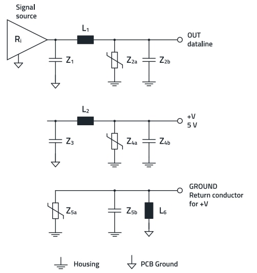

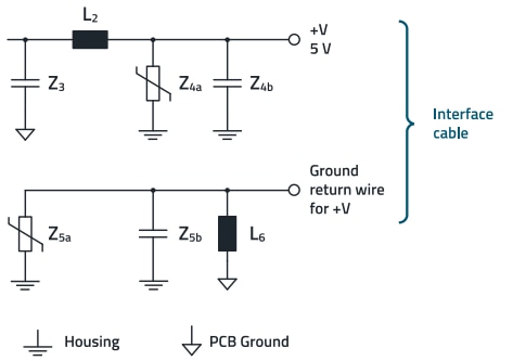

2.2 Filter circuit of the supply voltage line
In this section, the filter for the supply voltage cable entering the device is developed as shown in Figure 5.
Figure 5: Power supply line filter of an unbalanced signal interface.
Generally, transients are filtered at interfaces against the housing - shown with the “housing” symbol. To enable a connection between the negative wire (GND of the USB cable line) to the functional ground (GND of the circuit board) and still attenuate interference coming from the cable, an SMT ferrite is used between the housing ground and GND. The capacitor Z5b and the parasitic capacitance of Z5a drain RF emissions with respect to transient voltages coming from the cable to the housing ground.
Step 1: Determination of Z3
A decoupling capacitor with 100 nF is used as standard here. A X7R ceramic capacitor with sufficient high rated voltage should be used here, so as not to run into the voltage bias effect and to lose capacitance.
Step 2: Determination of Z4 and Z5
Z4a is a SMT varistor with CCh = 200 pF.
To achieve the necessary capacitance for the filter, an additional capacitor of 100 nF is usually used as standard for Z4b, which should be the same capacitor as Z3.and Z5b. Varistors Z5a and Z4a should be the same component.
Step 3: Determination of L2 and L6
L2 and L6 are SMT ferrites, where the rated current should be considered first. This must be greater than 2 times the output current. In this example corresponds to 2 · 2 A = 4 A.
Minimum rated current of SMT ferrite: Ir = 4 A
Supply voltage lines have no cutoff frequency and a very low source impedance of approx. ZOUT ≈ 2 ··· 9 Ω. As the noise source is the +V line, all other signal sources on the electronic board will create RF noise to the +V network which must be considered. This means that the impedance ZL2 or ZL6 should be as high as possible across the entire signal frequency range (typically 30 MHz to 1 GHz) to achieve sufficiently strong attenuation. The selection of the proper SMT ferrite should be done by REDEXPERT to get the right impedance over the relevant frequency range. The ferrite selected here is the WE-CBF SMT EMI Suppression Ferrite Bead 74279252. The impedance chart is shown in Figure 6 and the electrical properties from the data sheet are shown in Table 2.

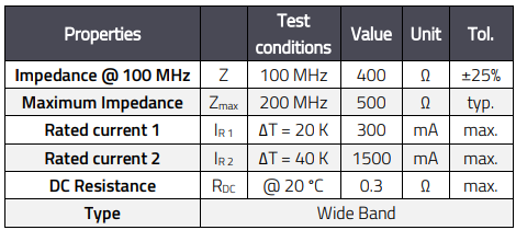

Figure 6: Impedance characteristics of SMT ferrite CBF 74279252
Table 2: Electrical properties of the SMT ferrite CBF 74279252.

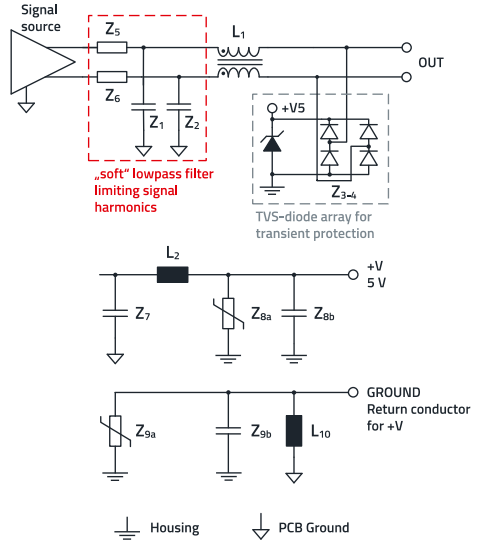

Figure 7 depicts a possible filter circuit for a balanced signal interface. The circuit utilizes a soft low-pass filter to pass the signal in differential mode while attenuating common-mode components.
Figure 7: Balanced signal interface filter.
The symmetric low-pass filter allows differential-mode signals, which carry the essential information, to pass through unimpeded. Conversely, common-mode signals, which are noise components of the signal, are attenuated or damped by the filter.
TVS-diode array provides transient voltage protection. These spikes are sudden, unwanted bursts of high voltage that can damage electronic components. When a transient overvoltage occurs, the TVS diodes limit the voltage and divert the transient impulse current from the circuit to ground (housing).
The next section provides a practical example of component selection for a USB 2.0 interface. The USB 2.0 interface is a widely used for data and power transfer between electronic devices. It provides a signal bandwidth of approximately 240 MHz (480 Mbps) and an impedance of 90 Ω. A typical power supply for USB 2.0 is +5 V with a maximum current of 1 A.

Capacitors (Z1, Z2) and matching resistors (Z5, Z6) form a "soft" low pass filter to limit signal harmonics or HF noise produced by the controller, resp. signal transceiver. The values of the resistors depend on the signal controller and its imbalance/mismatch and must be selected according to the measurement results. The values of Z5, Z6 are typically between 3 and 10 Ω. The capacitor values must be selected accordingly, the values vary in the range of 2.2 to 10 pF. Typical value for USB 2.0: 4.7 pF, e.g., WCAP-CSGP Ceramic Capacitor 885012005038.
The resistors Z5, Z6 (e.g., 3.3 Ω) are typically used for reflection damping and filtering in conjunction with the capacitors (Z1, Z2) to improve signal integrity and reduce interference. RF suitable types with a small body size should be used here.
Step 3: Determination of Z3, Z4, L2, Z7 and Z8
TVS diodes (Z3, Z4) and components like L2, Z7, and Z8 provide transient protection against voltage spikes and surges. To properly handle transient currents, consider the minimum rated current (Ir) of components such as L2 and the SMT ferrite (Z9a). L2, Z7, and Z8 are used for low cut-off frequency filtering, typically less than 1 MHz.
SMT Ferrite Bead (L2): Used for low cut-off frequency. Ensure the choke has an appropriate minimum rated current Ir. To achieve broadband noise reduction, the SMD ferrite WE-CBF SMT EMI Suppression Ferrite Bead 742792032 (see Table 3).
Table 3: Electrical properties of the SMT ferrite CBF 742792032.
Capacitors and Varistors (Z7, Z8): Z7 is a capacitor for low cut-off frequency filtering and Z8 is a SMT varistor for transient protection. An example of a suitable capacitor for this application is WCAP-CSGP Ceramic Capacitor 885012206120 and for a varistor, WE-VS SMT Varistor 82536040.
TVS Diodes Array (Z3, Z4): TVS diode arrays (Transient Voltage Suppression Arrays), such as the WE-TVS diode 8240136 from the "High Speed" series, are used to protect signal lines against transient voltages. It is important to note that these components also exhibit parasitic capacitance, which must not be too high relative to the data transfer rate or signal bandwidth. Information regarding suitable applications can be found in the datasheets.
Step 4: Determination of Z9a and Z9b
For high-frequency decoupling between housing and cable ground (GND), SMT ferrites (L10) and SMT varistors ( Z9a and Z9b), e.g., WE-CBF SMT EMI Suppression Ferrite Bead and WE-VS SMT varistor are used in combination with capacitors. This filter section helps reduce common-mode interference and improves system stability. Ensure that the current-carrying components are compatible with the required minimum rated current (Ir).

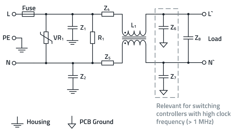

4. POWER LINE FILTER WITH TRANSIENT PROTECTION
A power line filter of protection class I with a protective conductor is considered below.
The circuit diagram in Figure 8 contains all components that are necessary for the filter circuit. The choke L1 decouples the load, i.e. the power supply, from the mains with its common-mode impedance. This means that the choke is RF-technically with Z1/Z6 and Z2/Z7 when the reference ground (PCB ground to housing) carries interference potential. However, Z6 and Z7 are capacitors with a low capacitance (typically 200 - 470 pF) that are inserted to dampen highfrequency harmonics of the switching power supply. The two capacitors should be placed on the circuit board of the power supply if the proportion of switching harmonics on the power supply side is high, or if the reference ground (case ground) does not form a high-frequency stable reference point.
The chokes Z4 and Z5 are already partially covered by the leakage inductance of the common mode choke L1; Z4 and Z5 can also be provided for additional attenuation in the frequency range above 10 MHz.
A mains filter for an interface with a 50 Hz mains frequency and a voltage of 230 VAC serves as a calculation example.
Figure 8: Circuit diagram of the line filter with transient protection.

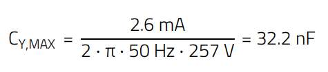

The maximum permissible leakage current on PE is 3.5 mA according to DIN VDE 0701-0702 for electrical devices with rated voltages up to 1000 VAC/1500 VDC. For safety reasons, a maximum leakage current of ILEAK = 2.6 mA is assumed in the example, from which the maximum capacitance of the Y-capacitors (CY, MAX) with the mains filter frequency f = 50 Hz and the worst-case voltage of VMAINS = 257 V is calculated as follows
image(7)
Where:
  • CY, MAX is the maximum capacitance of the Y-capacitor (F).
  • ILEAK is the maximum leakage current (A).
  • f is the mains frequency (Hz).
  • VMAINS is the possible maximum value of the mains voltage.
Substituting the known values in (7),
Thus, the maximum possible capacitance value of the Y-capacitor is therefore approximately 33 nF.

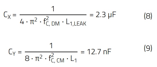

In the next step, the Y-capacitors Z1 and Z2, and the X-capacitor Z8 are selected.
Step 2: Determination of Z1, Z2 and Z8
Practical experience for the required minimum attenuation at 150 kHz is 20 dB in differential mode and 40 dB in commonmode. Common values for the filter corner frequencies are 15 kHz in differential mode and 10 kHz in common-mode. The corner frequency represents the frequency at which the attenuation of a filter is 3 dB. Given the required comer frequencies and required attenuation, the capacitances can be calculated:
Where:
  • fC, DM is the corner frequency of the differential-mode filter (Hz).
  • fC, CM is the corner frequency of the common-mode filter (Hz).
  • L1 is the inductance of the common-mode choke (H).
  • L1,LEAK is the leakage inductance (H), which derived from L1/200 (empirical value).
Based on these values, for this example a capacitance of 2.2 µF is chosen for CX and a capacitance of 3 × 4.7 nF = 14.1 nF for CY. For the Y-capacitors the MLCC Safety Capacitors are used (WCAP-CSSA Interference Suppression). This results for the attenuation are shown in Figure 9.

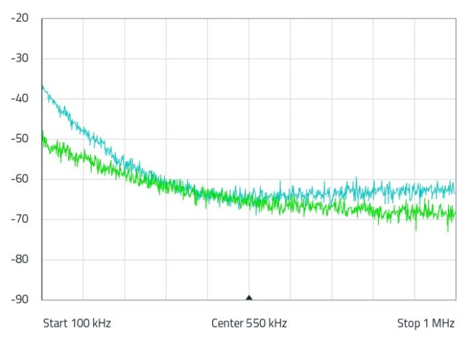

Figure 9: Differential-mode (green) and common-mode (blue) attenuation by Z1, Z2 and Z8.
The required attenuation of 20 dB at 150 kHz is exceeded by 32 dB in differential mode. The common-mode attenuation of 40 dB at 150 kHz can also be easily achieved with 43 dB.
For transient protection, a disk varistor is used in parallel to the X-capacitor, which is selected next.

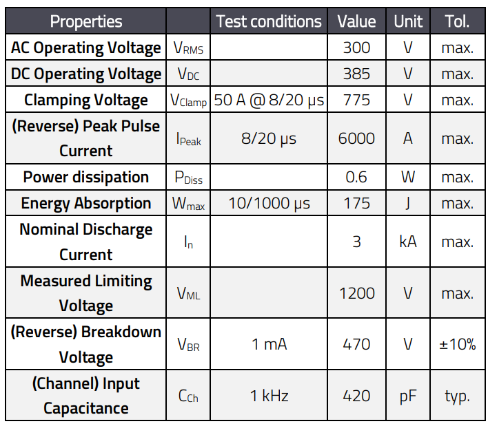

The disk varistor WE-VD 820443011E with a maximum operating voltage of VRMS = 300 V is used as the basis for the decision.
An excerpt from the data sheet can be seen in Table 5.
Table 5: Electrical properties of the disk varistor WE-VD 820443011E.
According to the IEC/EN 61000-4-5 standard, the voltage of the test pulse for surge between a conductor and a return conductor is VSURGE = 2 kV and the source impedance is 2 Ω for low voltage network connections between live conductor and neutral conductor.
The breakdown voltage (VVAR or VBR) can be found in the varistor datasheet (shown in Table 5). The peak current IPEAK can be calculated as follows:
