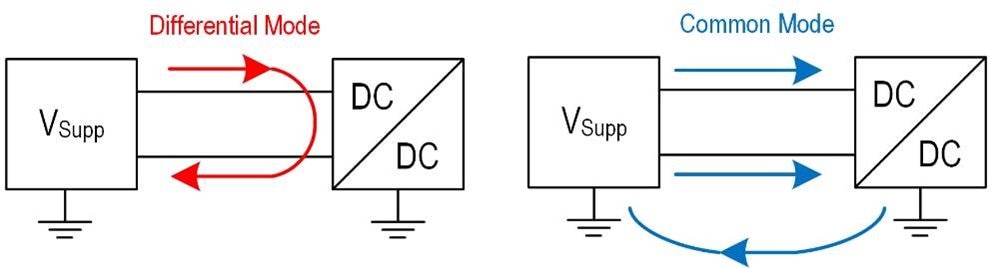

2.1. TYPES OF INTERFERENCE

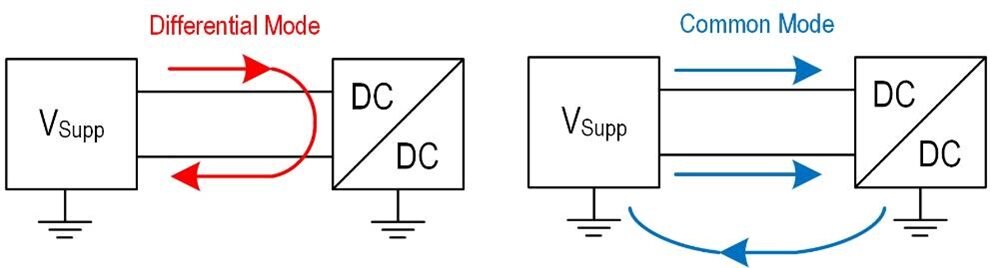

To understand the way in which radiated and conducted interferences can occur, a distinction must be drawn between the type of interference signal involved (common mode or differential mode) and to properly identify the feedback paths.
  • Differential-mode current is phase-shifted by 180°
  • Interference current loop closes via outward and return conductor
  • Suppression with LC, T, Π filter
  • Common-mode current is in phase
  • Interference current loop closes via the ground wire
  • Suppression with current-compensated choke
Figure 3: Difference between common-mode and differential-mode signal

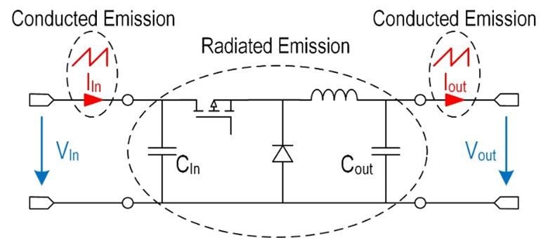

When it comes to designing an EMC-compliant layout, it is necessary to know just why and where the corresponding EMC interferences can arise. In the case of switching controllers, measurements in the EMC chamber (interference-field strength acc. to e.g. EN 61000-4-3) frequently show a broad-band interference spectrum ranging between 30 MHz and 400 MHz. One of the causes for this is the steep MOSFET switching edge (depending on the rise time, with a frequency spectrum of up to several hundred MHz), which for instance with the MOSFET output capacitance CDS, the junction capacitance, and the reverse recovery capacitance of the Schottky diode and the parasitic conductor-track inductances cause high-frequency LC circuits. When a single ground conductor track is not kept to a low impedance, or when single conductor-track wire conduct two currents and cause feedback in the common impedance, common-mode interferences can potentially be expected in the design. These interferences will then decouple capacitively in the direction of the interference source to form a high-frequency closure of the interference current.
Figure 4: Potential sources for conducted and radiated emissionimage

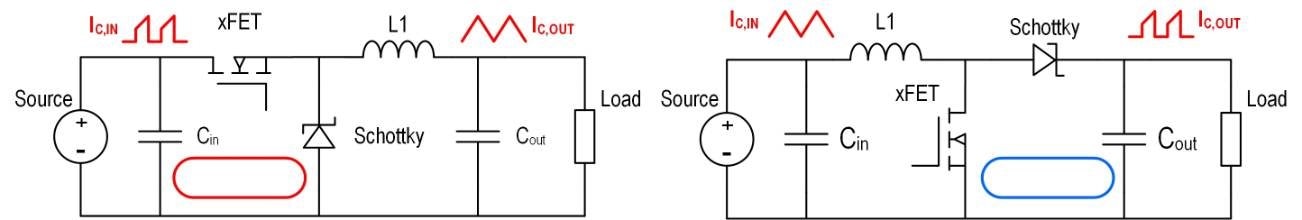

The measurement of the interference voltage (acc. to. e.g. CISPR 16-2-1) reveals the switching frequency of the controller and its harmonic waves up to a level of 10 MHz. Depending on the shielding and the length of the wire, these occur as a mixture of commonmode and differential-mode interference signals. The cause of the differential-mode interference signals lies in the discontinuous current consumption of the MOSFET, which then causes a drop in voltage at the ESR of the input and output capacitors.
Figure 5: critical current loop buck converterFigure 6: critical current loop boost converter
Beyond considering the impact of components and layout regarding the interference voltage, it is also necessary to bear in mind that the topologies of the switching controllers differ in terms of their potential to cause interferences more at the input or the output. As shown in Figures 5 and 6, in the boost converter it is the output that is the more critical aspect, since here the power inductor acts as a “current brake” (di/dt) between the MOSFET and the input. The buck converter, on the other hand, plays a more critical role at the input, since in this topology the power inductor is situated between the MOSFET and the output. This clearly demonstrates that a buck converter requires an input filter and a boost converter an output filter to suppress the discontinuous current curve. This does not mean, however, that the other, less critical loop should be neglected.

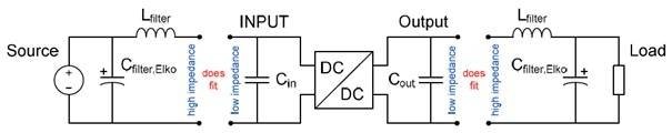

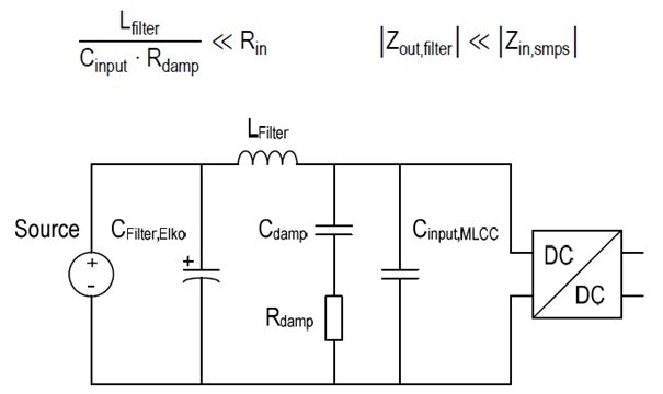

2.2. INPUT FILTERS, INTERFERENCE VOLTAGE
Modern converters generally feature switching frequencies from 250 kHz up to 4 MHz. LC filters are particularly suited to bring the fundamental wave and its harmonics in the spectrum under control. These filters are capable of achieving a suppression of up to 40 dB per decade, and also enable filter cut-off frequencies down to the low kHz range to be realized.
Filter resonance frequency:
An appropriate rule of thumb for practical applications is to set the cut-off frequency of the filter to approx. one tenth of the frequency of the switching controller, thus achieving a suppression of the spectral amplitude by approx. 40 dB at the switching frequency (fundamental). In the case that the EMC levels are still too high, the cut-off frequency should also be set even lower, a measure that, however, entails larger components or a poorer RDC in the filter inductance.
Filter inductance at the specified filter capacity:
Figure 7: Demostration of the input and output circuit for differential mode filtering

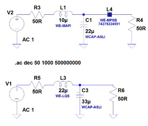

Suitable filter inductances in this regard are e.g. ones from the WE-LQS, WE-LHMI or WE-MAPI series. The criteria for selection include the maximum current-carrying capacity (ampacity) and the self-resonant frequency (SRF), which should be higher than the spectrum to be filtered. Care should be taken not to exceed the frequency spectrum with the inductively determined coil impedance, with a sufficient interval to the SRF, since this may be subject to fluctuations for production-related causes. In the practical area, generally inductance values ranging from 1 μH to 22 μH are applied, since these components already exhibit a sufficiently high impedance in the frequency range of relevance regarding differential-mode interference signals. In this inductance range, it is also possible to select components that in many cases offer a well-balanced compromise between size, ampacity, and costs.
Figure 8 Simulated(LT Spice suppression of a pure LC filter(22H 33F blue and a T filter(10H 22F MPSB  7427922455174279224551 red in a 50 Ω system (1kHz - 500MHz)
An appropriate measure for increasing the impedance of the input filter in particular in the frequency range over 10 MHz (Figure 8) is to complement the LC filter by a WE-MPSB ferrite. This ferrite is substantially superior to conventional ferrites in terms of maximum pulse current (see ANP028 for details) and thus constitutes an excellent choice when it comes to the suppression of high-frequency DC power-supply systems. What’s more, the inductor and the capacitor can also be dimensioned slightly smaller. As is the case for all SMD ferrites, when choosing the WE-MPSB the dependence of the impedance on DC current must also be taken into consideration.

However, when MLCCs are used as input capacitors in combination with a filter inductance or a parasitic lead inductance, in the event of voltage transients (e.g. a drop in the input voltage), oscillations may occur at the switching controller input. Such oscillations are caused by the so-called negative input resistance in combination with the LC circuit that is produced. Here the filter inductance and the MLCC input capacitor combine to produce an oscillating circuit with a magnified resonance peak. Since a negative impedance by nature does not absorb energy, but rather is capable of supplying energy, together with the parasitic and intentionally used inductances this results in the formation of an undesirable oscillating circuit. Here the LC circuit is fed by a residual energy that the converter does not absorb during the transient. Due to the switch at the input, the “C” is an absolute necessity. The “L”, however, can be due not only to a filter inductance, but also to the lead / layout / ESL. This means that undesirable oscillations can occur even in cases in which filters are not involved.
Figure 9: Since the output remains constant even in the case of a drop in the input voltage, it is logical that the input current must rise
This results in a brief negative input resistance during this voltage transient.
This negative input impedance can result in a series of problems:
  • Destabilization of the output regulation loop when the frequency spectrum of the negative impedance at the input overlaps the bandwidth of the control loop.
  • Voltage overshoots in the event of resonance, capable of causing damage to active and passive components.
  • Cause of other EMC interference signals
The risks posed by a negative impedance are greatest when the input voltage is lowest and thus the input current is largest. The best method currently available to avoid these undesirable effects is to actively suppress the LC circuit. This can be achieved by using an SMD resistor (this resistor has a low self-inductance) in series with a capacitor that blocks the DC voltage (cf. Fig. 10). The aim of this approach should be to achieve a resonant circuit factor of Q=1 or a damping factor ζ (zeta) of 0.707. In many cases, an electrolytic capacitor with a correspondingly high ESR is used instead. This is frequently, however, a “shot in the dark“, since the ESR is a value that is strongly dependent on frequency and temperature, and the developer often does not yet know in which frequency spectrum the undesirable oscillations will occur. Notwithstanding this, an electrolytic capacitor can be used as a “filter capacitor” in the manner shown in Figure 9.
The following general statement applies: the lower the “L” and the higher the “C”, the lower the hazards of the negative input impedance, since their contribution |Zin| drops accordingly.
Stability criteria:
Figure 10: Measures for filter suppression: SMD resistor in series with a capacitor
The damping capacitor should be approx. four times larger than the input capacitor to avoid any conflict with the input impedance. The damping capacitor must exhibit a lower impedance than the damping resistor at the resonance frequency to ensure that the damping resistor is capable of effectively attenuating the resonance peak of the filter.
A damping factor of 0.707 is sufficient.
Depending on the factor, values between 0.1 Ω and 4.7 Ω are conventionally used for the resistance Rdamp. The degree to which a stable design has been achieved can be simply measured using a current clamp, closely monitoring the amplitude of the current in the input capacitor over the entire dynamic range of the converter. When this current curve corresponds to the anticipated transients through the input capacitor, the converter is stable. In the event, however, that a too high amplitude occurs that does not correspond to the expected area of operation, the corresponding damping measures must be taken. In the following switching examples, such a damping resistor has not been used.

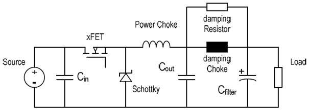

2.3. OUTPUT FILTERS
Output filters are frequently used to reduce the residual ripple of the output voltage further still. In the case that the drop in voltage over the filter inductance cannot be ignored, the output voltage must be captured downline from this filter and not, as is usually the case, at the output capacitor itself.
When a design makes use of an output filter that lies within the voltage feedback, the relevant frequency points should be considered. In this case, the output filter must be damped in all events so as not to endanger the stability of the control loop. In addition, the compensating circuit of the controller must also be recalculated, since the filter constitutes an additional pole.
Figure 11: Damping of the output filter with a parallel resistor to the filter inductance
Damping resistance output filter:

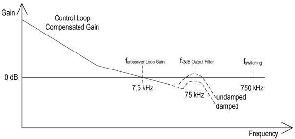

Typical values for a filter inductance at the output are 0.47 μH to 2.2 μH. In addition, the RDC should be small and the self-resonance frequency as high as possible. The WE-PMCI, WE-MAPI, WE-HCI or WE-LHMI series are excellently suited for this task. An important aspect in the selection of the Rdamp in this case is that this must be considerably larger than the RDC of the filter inductance so as not to reduce the damping of the filter.
Figure. 12: Setting of the various frequencies as a factor of the circuitry and switching frequency
Instead of a classic inductance, here it is also possible to use a WE-MPSB ferrite. Suitable for use as filter capacitors here are compact SMD electrolytic capacitors of the WCAP-ASLL and WCAP-ASLI series in the capacity spectrum from 10 μF to 100 μF. Here, too, ceramic capacitors using class 2 ceramics should also not be used in the design of the output filter, for the reasons already given above.
Figure 12 presents an example of how the frequencies can be set in a switching controller with an operating frequency of 750 kHz for:
  • LC output filters -3 dB cut-off frequency (damped)
  • 0 dB gain crossover frequency of the compensated control loop
Since the output filter in most cases is set at one tenth of the switching frequency, the 0dB crossover frequency of the control-loop compensated gain must be set at least one decade below this figure, since the phase already begins to rotate at this point in time, thus reducing the phase reserve in the system.

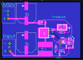

Initial analysis of the circuit-board layout of Design (1):
  • The PGND PTOs of the input and output capacitors (C1 & C2), IC, and shunt R1 are too distant from each other, meaning that there is a very large and critical current loop.
  • The C5 and C6 blocking capacitors are too far from the IC
  • All power connections are routed with connector tracks that are too thin and too long.
  • Connection (exception: COUT = C2) and routing of the feedback connector track highly unfavourable
  • No separation between AGND and PGND
  • Too few Vias are placed, especially regarding the PGND connections
  • Stub cable from C1 to the input wire.
Figure 14: Circuit-board layout of the critical design (Design 1)

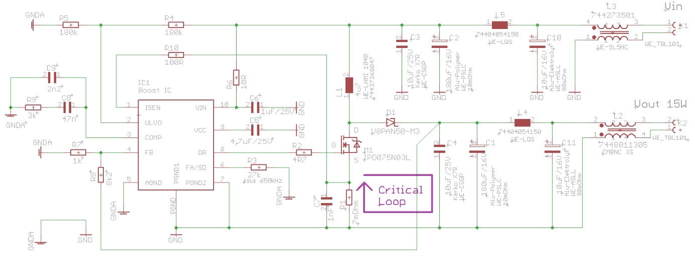

In the light of the obvious deficiencies, a second design (Design 2) was developed to test its efficiency in terms of the EMC.
2.5. CIRCUIT DIAGRAM „BETTER“ DESIGN (DESIGN 2)
Fig. 15: Circuit diagram of a good design (Design 2) with Uin = 9 V, Uout = 12 V, Iout = 1.25 A, fsw = 650 kHz
Initial analysis of the circuit diagram for Design (2):
  • Input and output capacitors are a combination of low-ESR MLCC (WCAP-CSGP) and low-ESR polymer capacitors (WCAP-PSLConly 180 μF)
  • LC filters (WE-LQS & WCAP-ASLL) at the input and output of the boost converter
  • Series gate resistor at the external MOSFET
  • Shielded power choke WE-LHMI of the latest generation
  • Separation between AGND and PGND already apparent in the circuit diagram
Since this is an open design without shielding, current-compensated chokes (WE-CMBNC and WE-SL5HC) were also designed in, since common-mode interferences that decouple via stray capacitance. The selection criteria here are the maximum ampacity and a commonmode impedance that can set in from the switching frequency over as broad a bandwidth as possible.

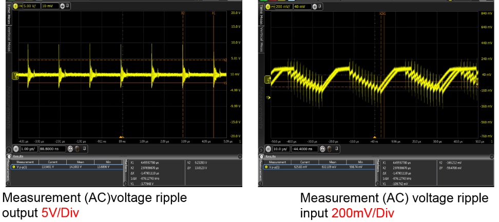

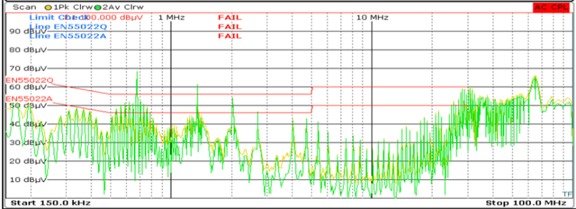

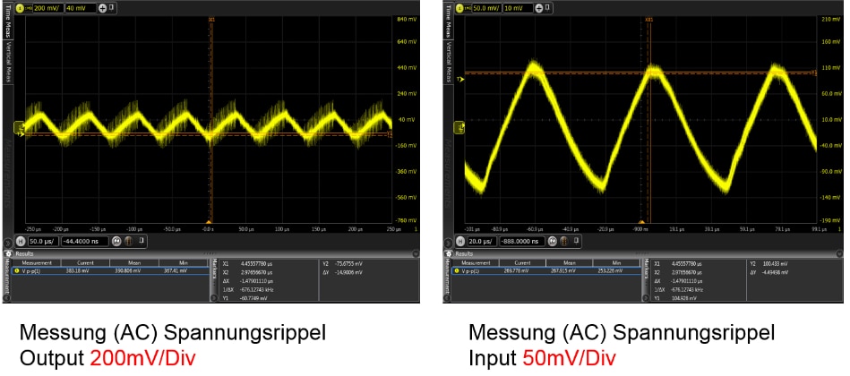

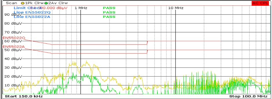

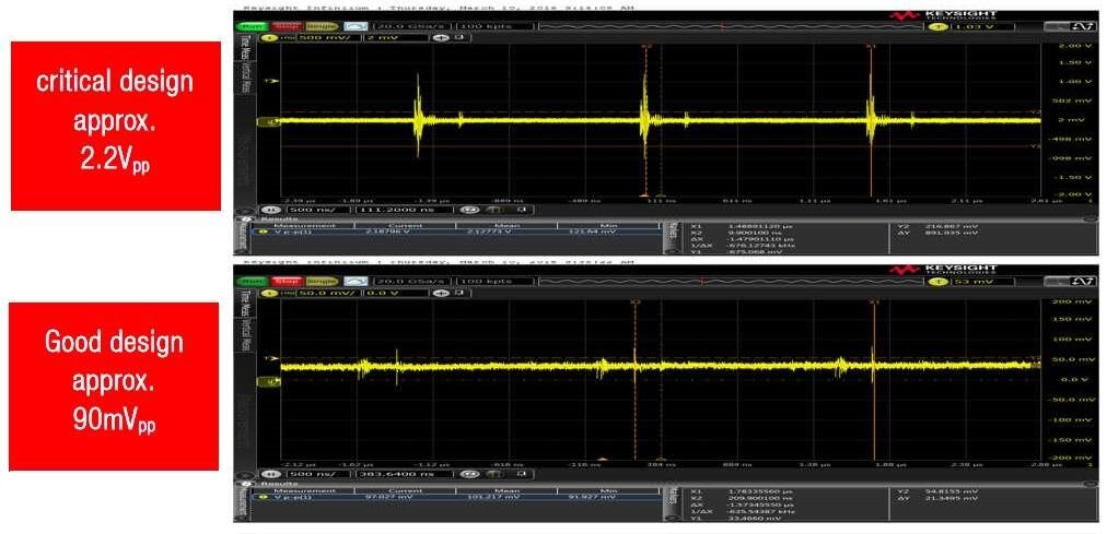

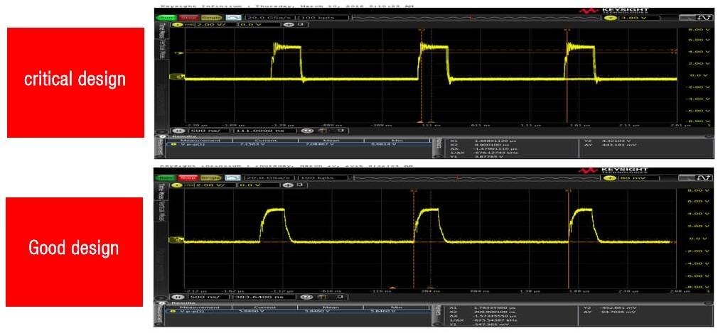

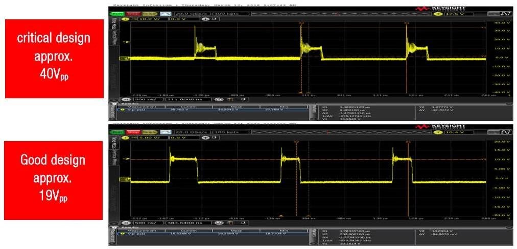

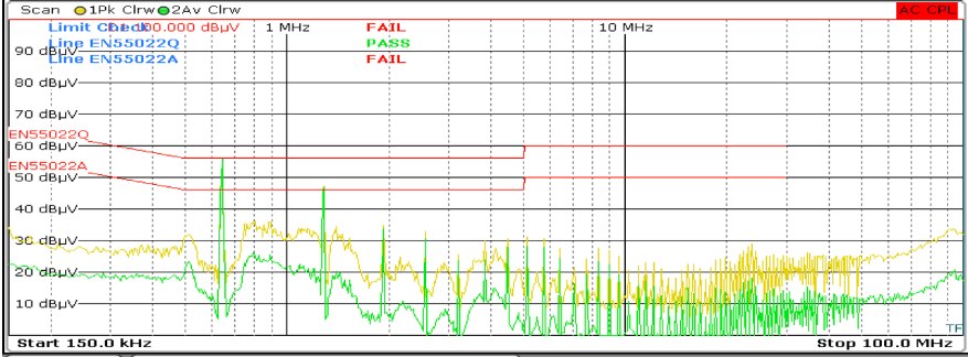

2.6. MEASUREMENT OF THE INTERFERENCE SPECTRUM: CRITICAL DESIGN (DESIGN 1)
Measurement of the interference voltage, critical design (Design 1), without filter
imageFigure 17: Measurement of the interference voltage of Design (1) at the output of the boost converter w/o filter
Figure 18: Measurement of the interference voltage of Design (1) at the input of the boost converter w/o filter
Figure 19: Measurement of the interferences in the time domain of Design (1) at the input and output of the boost converter w/o filter
2.6.1. ANALYSIS (A) OF THE MEASUREMENTS OF THE CRITICAL DESIGN (DESIGN 1)
As assumed, the output of a boost switching controller is more critical regarding the expected level. Nevertheless, without further filtering the levels at the input are far too high. Measurements were made up to 100 MHz to obtain a trend for the levels in the measurement of the interference-field strengths (30 MHz to 400 MHz).

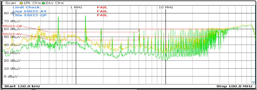

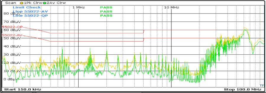

Measurement of the interference voltage, critical design (Design 1), with filter
Figure 20: Measurement of the interferences in the time domain of Design (1) at the input and output of the boost converter with LC filter (15 μH / 10 μF)
Figure 21: Measurement of the interference voltage of Design (1) at the output of the boost converter with LC filter (15 μH / 10 μF)
Figure 22: Measurement of the interference voltage of Design (1) at the input of the boost converter with LC filter (15 μH / 10 μF)
2.6.2. ANALYSIS (B) OF THE MEASUREMENTS OF THE CRITICAL DESIGN (DESIGN 1)
When a correspondingly large-dimensioned LC filter is used at the input and output of the boost converter, the level can be maintained up to 30 MHz and the interference-voltage measurement would be passed. The trend beyond 30 MHz, however, shows that problems must be reckoned with regarding the interference-field strength!

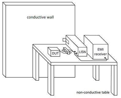

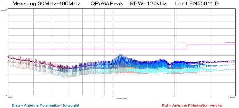

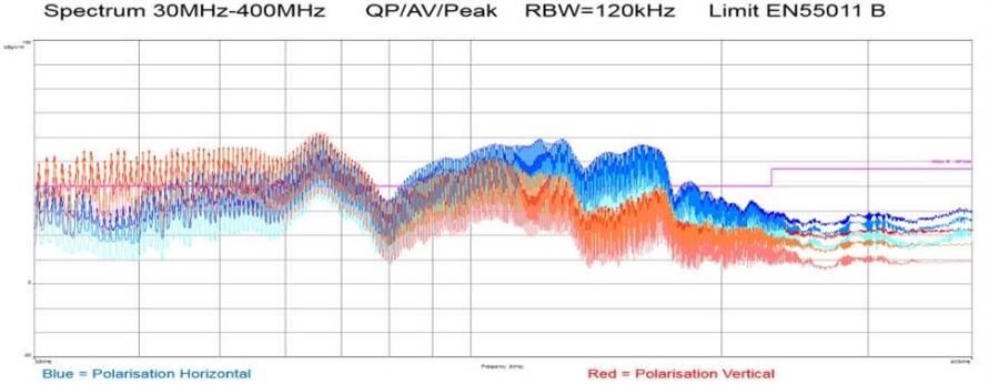

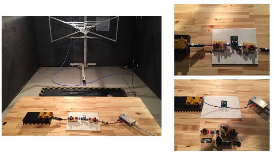

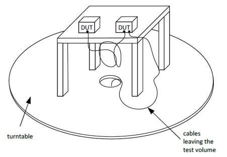

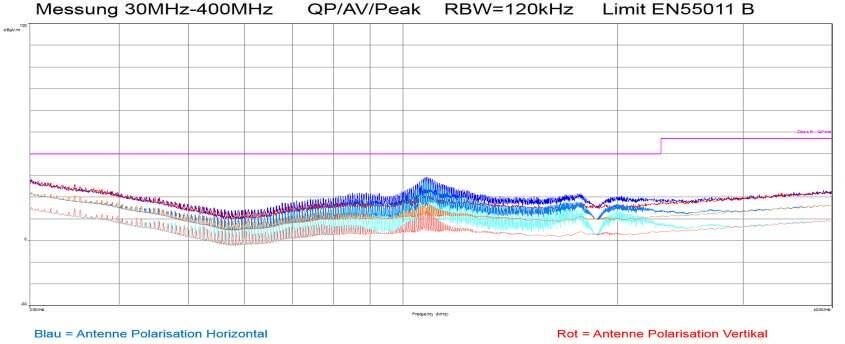

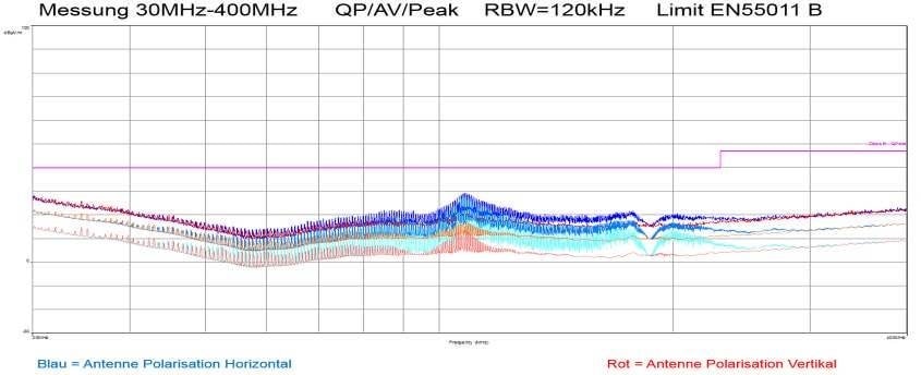

Measurement of the interference-field strength, critical design (Design 1)
Fig. 23: Set-up for the measurement of the interference-field strength with and without external filters. The external filters should
decouple the 20cm cable to ensure that only the emission of the circuit-board layout is measured

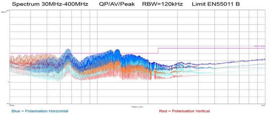

Fig. 24: Measurement of Design (1) with decoupling filters
Fig. 25: Measurement of Design (1) w/o decoupling filters
2.6.3. ANALYSIS (C) OF THE MEASUREMENTS OF THE CRITCAL DESIGN (DESIGN 1)
As already assumed in the measurement of the interference voltage, the levels specified in EN 55011 Class B are exceeded. When a few more centimeters of cable are involved, the levels rise over a very broad bandwidth over 10…15 dBμV/m. This clearly illustrates the negative impact of the critical layout with the large critical current loops and with excessive parasitical inductance.

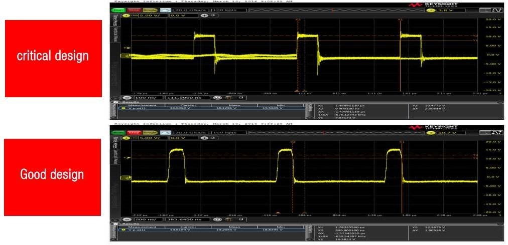

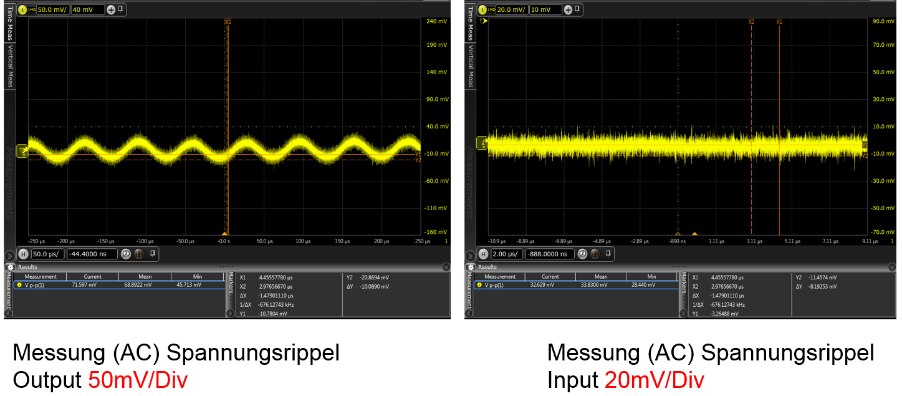

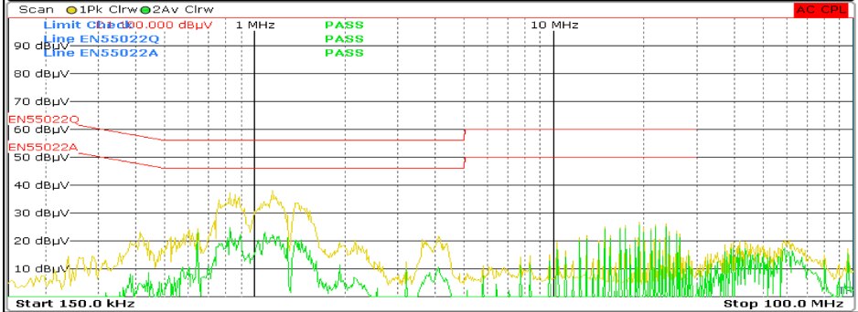

2.7. MEASUREMENT OF THE INTERFERENCE SPECTRUM: GOOD DESIGN (2)
Measurement of the interference voltage, good design (Design 2), without filter
Figure 26: Measurement of the interference voltage of Design (2) at the output of the boost converter w/o filter
Figure 27: Measurement of the interference voltage of Design (2) at the input of the boost converter w/o filter

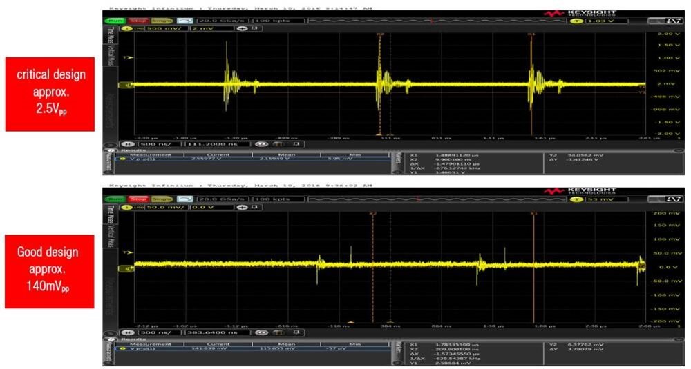

Figure 28: Measurement of the interferences in the time domain of Design (2) at the input and output of the boost converter w/o filter
2.7.1. ANALYSIS (A) OF THE MEASUREMENTS OF THE GOOD DESIGN (DESIGN 2)
For the first measurements, the filters were temporarily removed from the good design so that only the input and output capacitors were still in place. The levels and the background noise in the measurement of the interference voltage are considerably better than those measured for the critical design (1). The voltage levels are also far lower in the time domain. Nevertheless, without filters even the good design does not succeed in fulfilling the class B limit specifications.

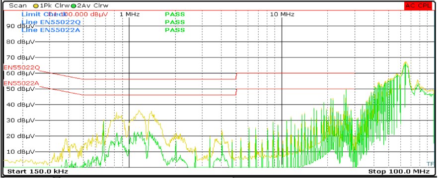

Measurement of the interference voltage, good design (Design 2), with filter
Figure 29: Measurement of the interference voltage of Design (2) at the output of the boost converter with filter (15 μH / 10μF / Stroko 5 mH)
Figure 30: Measurement of the interference voltage of Design (2) at the input of the boost converter with filter (15 μH / 10 μF / Stroko 5 μH)
Fig. 31: Measurement of the interferences in the time domain of Design (2) at the input and output of the boost converter with filter
2.7.2. ANALYSIS (B) OF THE MEASUREMENTS OF THE GOOD DESIGN (DESIGN 2)
Equipped with the appropriate input and output filters, the good design (Design 2) is easily capable of fulfilling the class B limit specifications in the interference-voltage measurements. Due to the good layout, no major challenges are to be reckoned with above 30 MHz in the interference-field strength. The time domain too shows that the combination of the good layout and the right components results in a substantially less critical design.
Measurement of the interference-field strength, good design (Design 2)
Figure 32: Measurement of design (2) with decoupling filters
Figure 33: Measurement of design (2) w/o decoupling filters
2.7.3. ANALYSIS (C) OF THE MEASUREMENTS OF THE GOOD DESIGN (DESIGN 2)
As was already assumed in the measurement of the interference voltage, the limits specified in EN 55011 class B are fulfilled. Even when the approx. 20 cm length of cable is included, thanks to the better layout and the selected components the good design is capable of fulfilling the specifications.

Figure 34: Measurement of the gate-source voltage at the MOSFET
High-frequency oscillations can be seen in the critical design, the result of an LC circuit formed by the gate capacitor in combination with the inductance of the thin and long connector track. What’s more, the series gate resistor in the good design helps to brake the steep edge to a certain degree when the device is switched on.
Figure 35: Measurement of the drain-source voltage at the MOSFET
The critical design exhibits high-frequency oscillations when the device is switched on or off. These are due to an LC circuit formed by the drain-source capacitor (CDS) in combination with the inductance of the thin connector tracks.
Figure 36: Measurement of the voltage over the Schottky diode
The reverse-recovery capacitance of the diode also causes very large high-frequency oscillations, which under certain circumstances may lead to the destruction of the diode or other components as a result of the high amplitude.
Figure 37: Measurement of the voltage at pin 10 (VIN) of the boost IC
The fact that the blocking capacitor in the critical design is located approx. 3 mm away from pin 10 and connected only by a thin connector track means that the boost IC cannot draw the necessary current swiftly enough. The inductance of the thin connector track acts as a current brake, resulting in a high-frequency voltage with a large amplitude at this site (cf. Figs. 9 and 10).
Figure 38: Measurement of the voltage at pin 9 (VCC) of the boost IC
