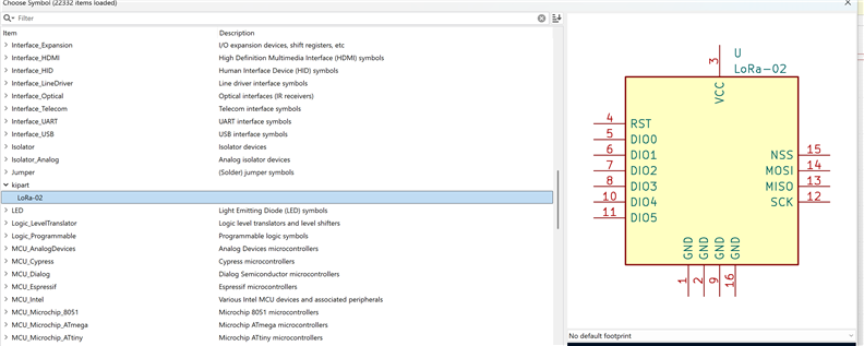

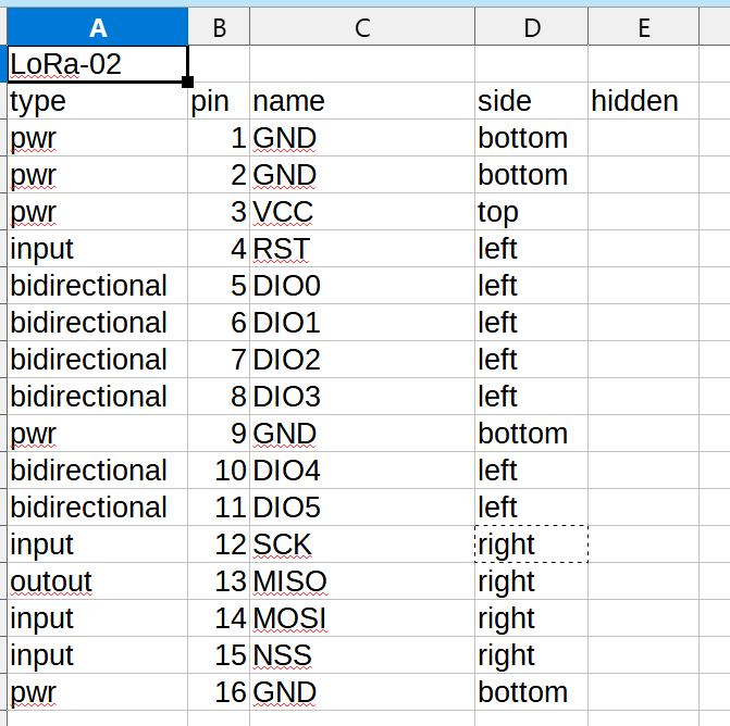

    Jan Cumps over 1 year ago
    I made a schema symbol with KiPart  KiCAD lovers, check out KiPart
    Imported the resulting library in KiCad, and migrated it (because KiPart makes legacy .lib libraries)
    LoRa-02.zip

    colporteur over 1 year ago in reply to Jan Cumps
    I vaguely recall this but never had a reason to invest. Looks like I do now. Thanks J.
    Jan Cumps over 1 year ago in reply to colporteur
    I attached the library to the comment above
