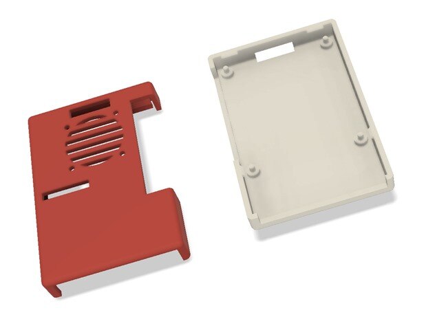

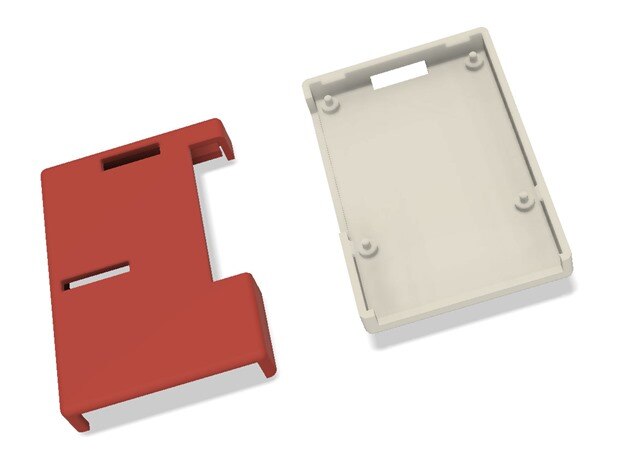

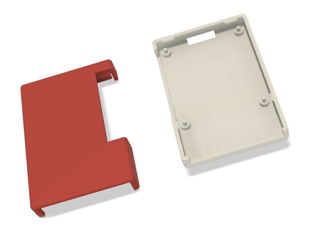

The new Raspberry Pi 4 will not fit in any of the enclosures I have at hand and while doing preparation for a RoadTest I found that my Pi was overheating and throttling back.  A quick web search did not find what was desired and besides designing one seemed like a good learning opportunity.  The resulting design, done in Fusion 360, has the following features:
  • Pi 3 also fits the enclosure
  • Snap fit with no screws
  • Base enclosure has a plain, solid top
  • Camera slot can  be added to the print
  • Display slot can be added to the print
  • 30 mm fan can be added to the print
The additional features are added by altering their individual parameters which are kept in an easily accessible table.  Changes to clearances and key dimensions can also be changed if needed by modifying their parameters.  This might prove useful in printers with different resolution or if for example the case height needs to be extended to fit a hat.
The basic design is similar to one that was posted right after the Pi 4 came out.  This enclosure was designed separately from the ground up however and is not compatible.  To accommodate the difference in USB, multiple HDMI, etc. between the Pi 3 and the Pi 4  the case slots in these areas is open without dividers.  A camera slot, display slot, 30 mm fan opening, or any combination thereof can be added in seconds.
{gallery} Raspberry Pi Enclosure Print Options
Plain Enclosure
Enclosure with Openings for Camera and Display
Enclosure with Openings for Fan, Camera, and Display

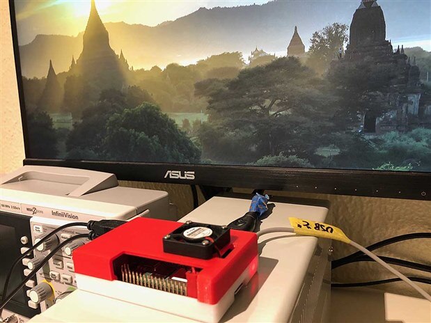

Total print time for the top and bottom is around 5 hours depending on the wall thickness chosen and the slots.  The photo below shows the Pi 4 mounted in an enclosure with a fan on top.  At this point a heat sink has not been added - just the fan.
As noted above, there was throttling prior adding the fan.  Raspberry Pi states that a warning is normally issued when 80 C is reached and throttling occurs at 85 C.  With the fan, temperatures did not exceed 72 C during the stress testing with the CPU at 100% for approximately 10 minutes.

    I have had the version with the fan working for about 6 weeks now, using it daily, and the case is fine.  The fan is on constantly and the air coming out of the case is only slightly above ambient.  The case itself does not feel particularly warm so it is not surprising that there is no problem.
    I suppose I should try the version with no fan and see what happens but then it will be subject to throttling which is undesirable for my experiments with Tensorflow.

    I went ahead and enlarged the width of the case 1 mm and the height of the top by 1.6 mm so it fits the Pi better.  I also added a full circular cutout to the parametric settings for the full opening fanboys (pun intended) image.
    I plan to use this case in a RoadTest of the Raspberry Pi 4B which will compare performance in face recognition using OpenCV to a Raspberry Pi 3B+.  Both will use the same SD card and be housed in the same case with a fan so they can run at full speed and to minimize differences other than the board itself.
    There are some nice cases showing up in the market now which minimizes the need to print your own, but this has been an interesting exercise in design nonetheless.  As for what could be improved, the clips / tab arrangement could probably be made to fit better although it is fully functional as is.  I am not sure the tolerances of my 3D printer will allow much more improvement.
