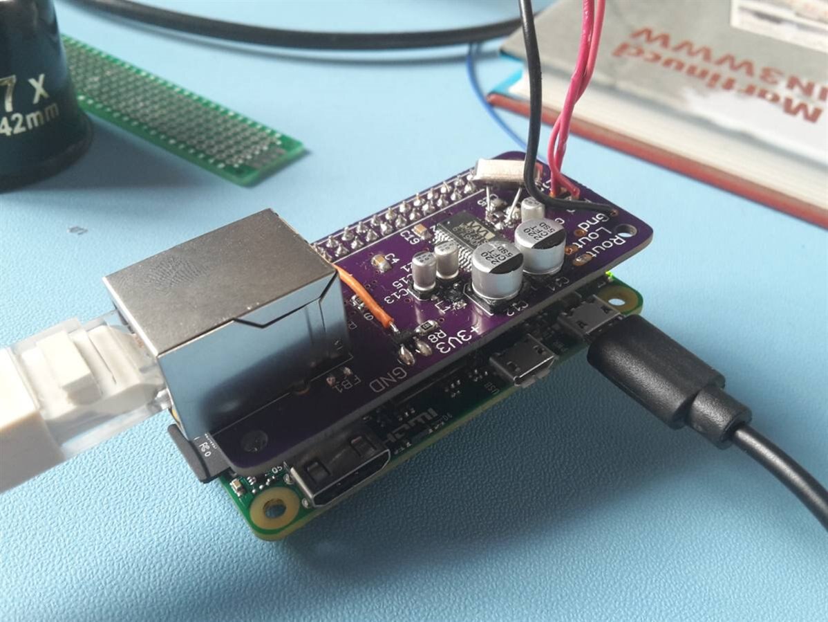

If you are here to see how to add Ethernet / soundcard functionality to the Pi Zero, this is a part to be used in my automated amateur radio WSPR transceiver. Explanation of which can be found here: WSPRpi part 0: Introduction and what is WSPR? If you are not interested in how I intend to use it and just want to see how to add Ethernet or a soundcard to a Pi Zero, skip to the Design section.
Finished result

I began by connecting the board (no Pi connected) to a 3.3V supply and it drew approximately 120mA which matched with a cheap Chinese breakout board for the same chip. If an Ethernet cable (connected to a router) is plugged in, the orange LED on the Ethernet connector should turn on and the green LED should flash, indicating network activity.
Mistake No. 1
I did not get any flashing LEDs, and got errors in the next step, Setup on the Pi, with a non responsive device. Due to the simplicity of the connections between the Pi and the ENC28J60, this pointed at bad soldering, incorrect power supply, wrong pinout or something wrong with the crystal. I double checked my soldering with decent magnification and it looked fine.The Eagle footprint was download from Farnell / element14 so was reasonably confident with that. Power supply was straight from my bench PSU so again unlikely. Probing with an oscilloscope showed both pins at about 1.1V DC. It turned out I had got my footprint for the crystal wrong, shorted both of the oscillator pins of the IC to the can and connected both ends of the crystal to ground. Oops!. Minor surgery later and this was fixed.
Bodge on the crystal. Please excuse the slightly melted pin header due to trying to fix this! This is a prototype board which is not quite right mechanically (connector locations and such) for the WSPR so I corrected this for v1.1 which will hopefully be the final version in the WSPRpi.

Mistake Number 2
Again I didn't get this working first time. Once again, device not responding which produces an output in dmesg which look like:
[ 5.710350] audioinjector-audio soc:sound: ASoC: CODEC DAI wm8731-hifi not registered
[ 5.710381] audioinjector-audio soc:sound: snd_soc_register_card failed (-517)
[ 5.746090] EXT4-fs (mmcblk0p7): re-mounted. Opts: (null)
[ 5.847273] audioinjector-audio soc:sound: ASoC: CODEC DAI wm8731-hifi not registered
[ 5.847304] audioinjector-audio soc:sound: snd_soc_register_card failed (-517)
[ 5.855053] wm8731 1-001a: Assuming static MCLK
[ 5.855425] wm8731 1-001a: Failed to issue reset: -5
[ 5.855535] wm8731: probe of 1-001a failed with error -5
[ 5.857826] usbcore: registered new interface driver brcmfmac
[ 5.858302] audioinjector-audio soc:sound: ASoC: CODEC DAI wm8731-hifi not registered
[ 5.858312] audioinjector-audio soc:sound: snd_soc_register_card failed (-517)
Again, the connections were very simple so: soldering, power supply, footprint or crystal.
Soldering: Checked with magnifying glass. It was fine.
Power supply: Fine
Crystal: Fine
Footprint: Turns out I had accidentally deleted a traced and left the mode pin floating. It needed to be shorted to ground to set the input to be I2C for the configuration instead of the default three wire protocol. One of the pins next to it (CSB) was grounded so I manually shorted these. This was surprisingly difficult on SSOP to selectively short just two pins! This has also been corrected for the version 1.1 PCBs.
