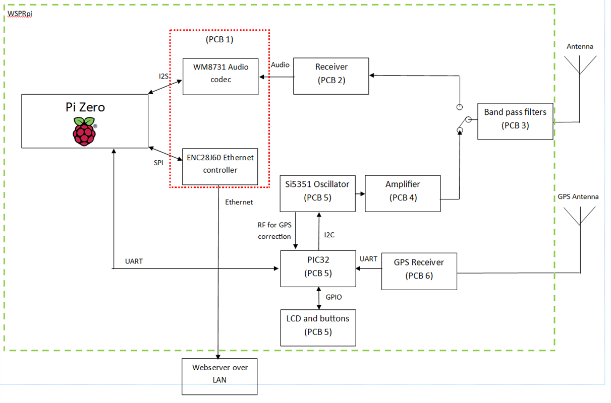

Hi, my name is Dan and my ham radio callsign is M0WUT.
I am developing an automated Raspberry Pi Zero based transceiver for the WSPR amateur mode.

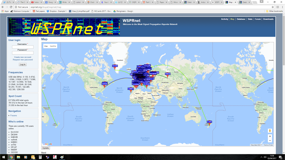

In short, amateur stations transmit data packets containing their callsign, their location and how much power they are transmitting with. Once received, these can be decoded by a computer who uploads them to a central database Database | WSPRnet This can then be used to see whether conditions are good for working certain places on certain bands or not. It is also used as it is very bandwidth efficient (approximately 5Hz bandwidth) as well as time division multiplexed and due to the large amount of error correction built into the code, it allows contacts to be made using very low power.
The map below shows all stations received by my friend George M1GEO in a 24 hour period. Nearly all these stations were running <5W output power. George has a very good article explaining the coding side of the WSPR protocol and using an Arduino to generate the tones from a frequency synthesiser board off eBay which can be found here: https://www.george-smart.co.uk/arduino/arduino_wspr/

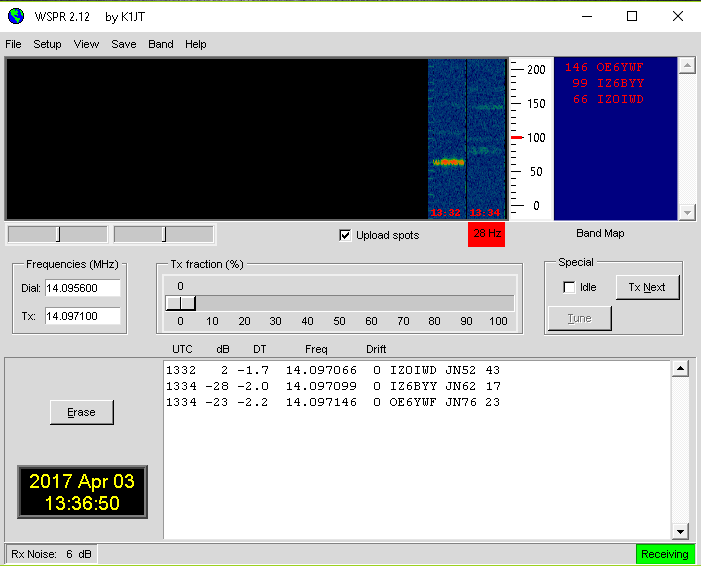

In receive, the radio will convert the received WSPR signal down to audio frequencies which are then fed into the soundcard of a computer. Once a two minute receive window is complete, the software will decode any WSPR signal that were received and upload them to the WSPR database, allowing maps like the one above to be produced. By only transmitting 20% (this is adjustable but 20% is the standard) of the time this allows even more users to use the same frequencies as different stations will transmit at different times.
WSPR GUI receiving Austria (OE6YWF) and Italy (IZ6BYY and IZ0IWD) on the 20 metre (14MHz) amateur band.

The solution I have gone with is a Pi Zero, adding Ethernet and a sound card via the GPIO (I want small size and no messy cables), and adding a PIC32 (Arduino only has 32 bit precision floating point numbers which is not accurate enough) with a Silicon Labs Si5351 synthesiser IC. This little chip cost 60p and is capable of generating 3 independent clock signal up to 100MHz. This plus an amplifer for the transmit side, some switchable filters to allow different bands to be used and a simple receiver should allow this to be possible and entirely self contained. A nice feature I added was a GPS receiver (I am most of the way through this project by now so this is currently working) to allow the unit to know when the two minutes transmit /receive windows were starting, to automatically know the location and to allow the frequency to be corrected using the 1pps output from the GPS receiver. The system knowing the actual time means that it can be set to automatically switch bands at certain times of day and the Ethernet socket is important even with the Pi Zero W having Wifi as the Pi will host a web server showing all of the received stations and the configuration for the WSPRpi so it (should!) be entirely driverless and need no extra software to run. If the trip is somewhere remote and there is no Internet, often a wired LAN is set up to allow the operators' logs to be synchronised but often there is no wireless network which is why the Ethernet connection is still important. I have named this project WSPRpi. The intended plan (a reasonable amount of which has already been built) is below.
