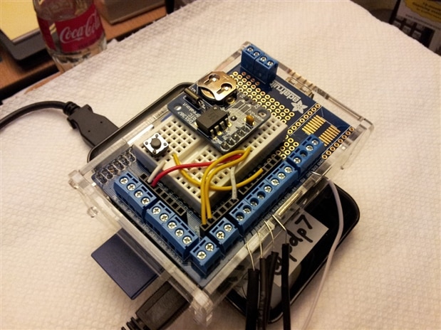

I thought the simplest approach would be to just control power to each of the LED candles in order to turn on and off as needed.  This could have been implemented with a simple 8-bit microcontroller.  However, I've been enjoying learning Python recently, so I decided to use a Raspberry Pi along with the Adafruit DS1307 Real-Time Clock (RTC) module .  The RTC is needed to make sure the Pi has the correct date when powered up as it won't be connected to a network.  I'd already built a Raspberry Pi time and temperature display earlier this year, so I was familiar with how to set the system clock during boot using the RTC.
I choose the Adafruit Pi Plate to connect all the components to the Pi.   The prototyping area on the Pi Plate is large enough to stick on the Adafruit tiny breadboard which makes it easy to experiment while developing a circuit:
I used the Adafruit Pi Box case as the top cover is removable which is perfect for use with the Pi Plate.  To avoid being tethered to an AC outlet, I decided to power the Raspberry Pi with a battery-powered USB charger which I previously wrote about in my blog post: Portable Pi
Diagram:
I made this diagram with Fritzing to show how I connected the RTC, a pushbutton and the four LED candles:
I couldn't figure out how to place the tiny bread on top of the Pi Plate in Fritzing, so I just show the connections to the pushbutton and RTC as being soldered.  The 4 LED candles are represented by the yellow LEDs in the diagram.
Real-Time Clock WARNING:
For the Adafruit RTC module, it's very important to make sure the 2.2k Ohm resistors are not installed.  I had previously soldered them in, so I had to snip them off before using with the Pi.  With the resistors removed, the 5V RTC can safely communicate with Pi's 3.3V logic level.
Candle circuit:
Originally, I had prototyped using a NPN transistor to turn on one of the LED candles.  However, the Pi's GPIO pins can individually provide 16mA max and 51mA total.  Each candle only drew a max of 11mA when testing which is within those limits.  Avoiding transistor circuitry gave me the advantage of being able to wire the candles to the screw terminals on the Pi Plate.
I only had one set of candles so I was cautious of providing too much voltage or current to candles.  Since the GPIO pins are 3.3V, I added a diode (1N1418-TR ) in series to drop the voltage down to around 2.7V.  I also added a 100 ohm resistor in series as well to limit current.  I couldn't tell if there was a current limiting resistor integrated into the candle's LED or not.  I wanted to play it safe in case the LED's design was depending on the coincell's internal resistance to limit current.
I measured a maximum current of 3.66mA with my DMM in this configuration (although it is always fluctuating as the LED flickers).  This correlated approximately with the maximum voltage I measured across the resistor of 350 mV (350mV / 100Ohm = 3.5 mA).   The maximum voltage drop across the LED was 2.5V.  These readings indicate the configuration is safe for both the Pi's GPIO pins and the LEDs.

Shutdown Button:
The Pi won't be connected to a screen or keyboard (e.g. "headless), so I wired up a push button which will cause Linux to shutdown when pressed.  The one contact of the switch is wired to GPIO pin #23 and the other to ground.  There is no pull-up resistor as the pin's internal pull-up is enabled via the RPi.GPIO Python module.
