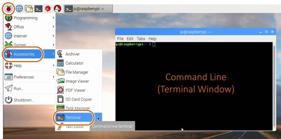

Using the Shell (Command Prompt or Terminal)
When a PC runs Windows it isn’t just running an operating system, it is also running a graphical user interface. Daily interaction with the PC is through the graphical user interface but users can bring up a command prompt in Windows and just type instructions. A similar thing is possible with the Pi. The operating system happens to be Linux, and the graphical user interface is called PIXEL. The entire thing can be called Raspbian which is the name of the combined distribution of Linux, PIXEL and any other stuff bundled by the creators of the Raspbian release.
The shell can also be loosely referred to as a command prompt or a terminal window; they all mean the same thing. It can be invoked from the Pi’s desktop as shown here.

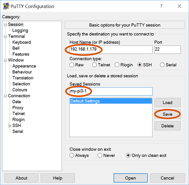

Simplifying access to the Pi with SSH
If you’re not able to get access to the TV always and wish to use your Pi from your PC, then something called SSH is very handy. It allows you to write and edit your code on a PC, and then transfer the code across to the Pi and run it remotely. To use this, first follow the steps to enable SSH capability.

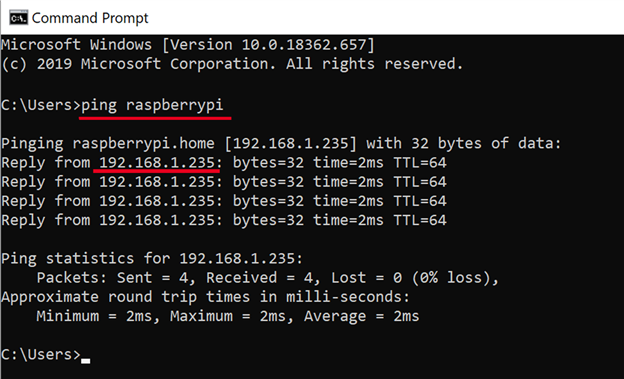

You'll also need to know the IP address of the Pi. There are two easy ways:
  1. If you only have one Pi connected to your home network, then try going to a Windows command prompt (or a Linux or Mac terminal) and typing ping raspberrypi because often that will reveal it.
  2. Alternatively, navigate to your home router using a web browser and check within the pages there. The address of the home router is usually http://192.168.0.254 or http://192.168.1.254
Here's an example using the first method:

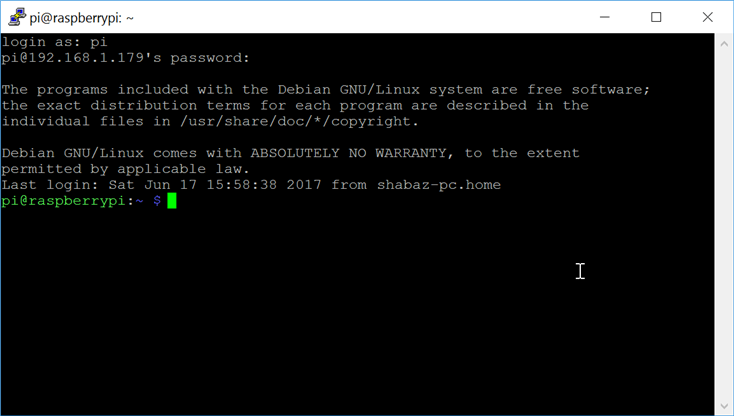

Next, ‘SSH client’ software is needed. The free option for Windows is called PuTTYhttp://www.putty.org/and it works well (for Mac and Linux PCs, SSH client software is built-in, it is accessed from the Mac/Linux command prompt by literally typing ssh). After PuTTY is installed, type in the IP address of the Pi (obtainable as described above) and type a name for your Pi and click Save.
From now on you can access the Pi by double-clicking the name, and it will bring up a window where it will prompt for the username/password (pi/raspberry by default).
The screenshots further below happen to use software called SecureCRT merely because I’m more familiar with it, but the same result can be achieved using PuTTY. I’ve customized my display so that the Pi appears in a blue screen. You can do similar things with PuTTY.

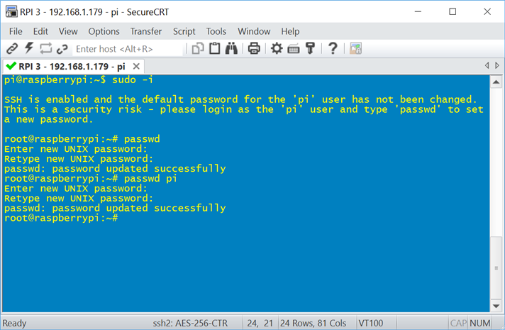

The steps here are quite important! Once Raspbian is up-and-running, it is advisable to change the password for the default ‘pi’ user. To do this, get to a command prompt and type passwd and it will prompt for the old password (raspberry by default) and then the new password. Simple passwords won’t be accepted.
Enabling the root user account (Superuser)
Some things are privileged and cannot be accessed by someone who has logged in as the ‘pi’ user. However, sometimes it is necessary to perform a privileged task. One method is to type sudo before entering the command for the privileged task.
Another method that some would find more preferable is to enable the root user account. It is easy to do using the sudo -i command. As pi user, do the following:
Now you have a Pi which you can log into as the pi user, or as the root user.

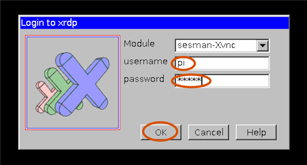

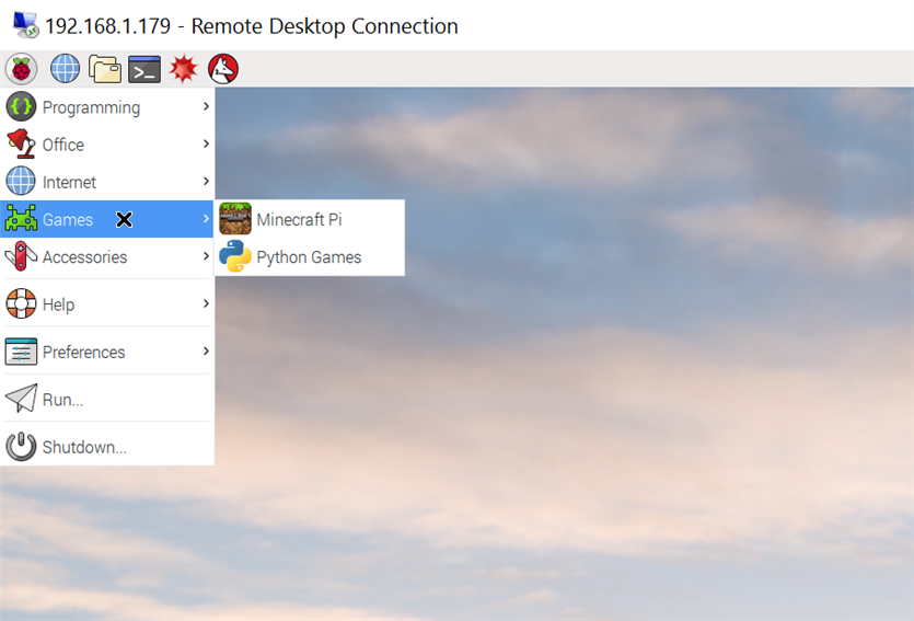

Remote Desktop (Accessing your Pi from a PC)

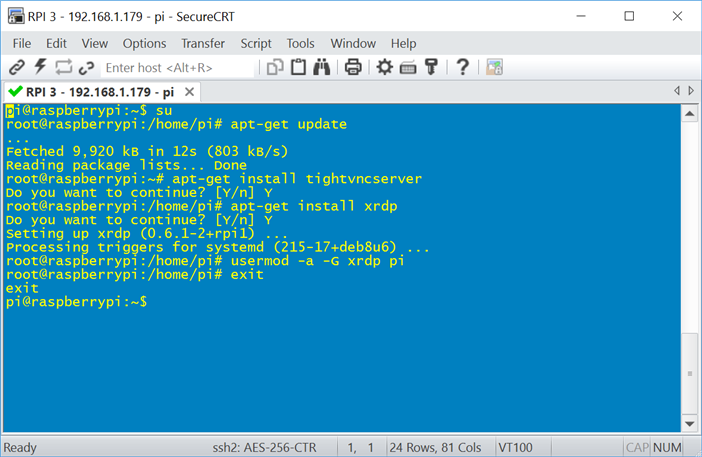

When the Pi is connected to a network there are many ways to connect to it. One method, SSH, has already been discussed. It provides a command line interface and the ability to transfer files to/from it. Occasionally the graphical capabilities of the Pi may be needed, and for that a TV can be plugged in using the HDMI connection. However, it is also possible to use the network to display the Pi’s desktop and any graphics on a PC. There are several ways to do this. One method called Windows Remote Desktop is described here. Another method is called VNC and there are online resources on it.

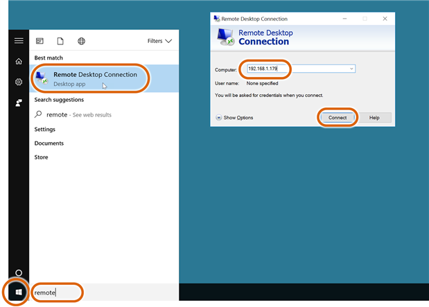

To enable the Pi to be able to send graphical display information, software called xrdp needs to be installed as shown here:
Next, go to the Windows start bar and type remote desktop and it should find the application. Click on it.
Type the IP address of the Pi and click on Connect. A large blank window will appear, and a prompt for the username/password for accessing the Pi.
Once the details are filled it, the usual Pi desktop will appear on the PC.
If you’re not using a Windows PC and are instead using a Mac or Linux PC then software needs to be installed (Windows already has the correct software installed). For a Mac, install Remote Desktop Client from the itunes store,  and for Linux PCs install rdesktop.

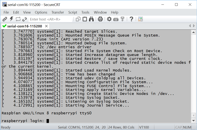

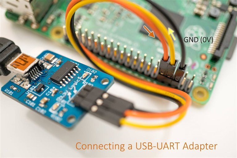

Using a Serial Console
If you look around the back of most computers and computer-based products in business and industry, you’ll see a port marked ‘Console’. It offers a last-resort method of connection if more sophisticated methods like keyboard/mouse, wireless and Ethernet fail. The console on such computers can be connected to a PC using an RS232 serial cable, or can be connected to an old-school dial-up modem if the computer is at a remote site and no-one can get to it in any other way. The Pi does have a console connection, but it needs an adapter before it can be attached to a computer. It is known as a USB-to-UART adapter and it converts from a PC USB connection to a three-wire connection where one wire is ground, and the other two wires send data to/from the Pi using digital values of 3.3V and 0V to represent 1’s and 0’s, and groupings of these representing ASCII characters. The end result is a text-based connection much like with SSH, but using a relatively simple communication method compared to SSH over the network. When all else fails often the serial console connection continues to run and provides entry into the computer to examine the cause for failure of the other connection methods for example.

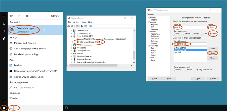

There are many suitable USB-to-UART adapters, but they come in different voltage versions. A 3.3V compatible adapter is required which most are (some older ones might only support 5V which will damage the Pi’s serial interface).
A suitable flying lead USB-to-UART adapter (the functionality is embedded within the USB connector housing) is TTL-232RG-VIP-WETTL-232RG-VIP-WE and it has six wires. Only four need to be connected (two are 3.3V power and ground, and the other two are the transmit/receive wires for the digital data). You could even make your own USB-UART adapter on stripboard. The photo below shows a home-made one on a printed circuit board (PCB).
Setting up the console has a few implications due to some discrepancies between the Pi 3 and earlier Pi releases that won’t be discussed here, and a power user will probably want to read up to understand them. Anyway, to enable the serial interface on the Pi for now, as root user, go to the /boot folder and append the following at the end of the config.txt file:
# initialize the uart (mini-uart on pi 3, PL011 on earlier pi's)
enable_uart=1
As an optional (but recommended) thing, in the same folder (still as root user) edit the cmdline.txt file and remove the text quiet there. By removing this text, the serial console will provide lots of useful debugging information when it starts up. The Pi must be rebooted for the changes to take effect. Still as root user, type reboot to do this.
On the PC, ‘serial terminal software’ is needed. On Windows PCs PuTTY can be used for this. Go to the Start button and then type device manager and click on it. Scroll down and expand the ‘Ports’ section. Plug the USB UART adapter in and you’ll see a new port appear. The name of the port (COM16 in the screenshot below) will need to be noted, and then in PuTTY select the ‘Serial’ connection type instead of the usual SSH, and type in a speed of 11500 and enter the name of the port to match the COM name from the device manager window. The settings can be saved and then the saved session can be started at any time by double-clicking on it.
When the session is run a blank window appear, press Enter and you should see the Pi’s usual login prompt. As mentioned earlier if the Pi is now rebooted then upon startup a whole load of information will appear.
