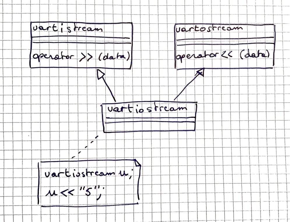

Pico UART Stream classes: in, out and io
The code for the stream classes is surprisingly simple.

class uartiostream: public uartistream, public uartostream {
These classes are small in code size. And small in runtime resource use. Using them is similar for the Pico as calling the API uart_puts() and uart_getc() functions.
In essence: 30 lines of source code to get the streaming abstraction. And no runtime (memory, clock ticks, code size) overhead.

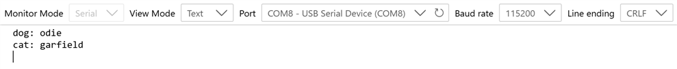

Example, with a few of the use cases mentioned above:

int main() {
    uartiostream u(pico_init_uart());
    u << "hello element14!\n" ;
    dog d("odie");
    cat c("garfield");
    u << d << "\n" << c << "\n" ;

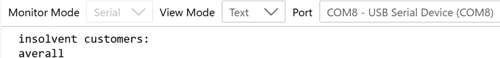

    std::array<customer, 3> customers {{{"joe", 3}, {"jane", 500}, {"averall", -8}}};
    u << "insolvent customers:" << "\n";
    for(const auto &c : customers | std::views::filter([](const auto& c){ return c.credit < 0;})) {
                u << c << "\n";
    u << "rich customers:" << "\n";
    for(const auto &c : customers | std::views::filter([](const auto& c){ return c.credit > 100;})) {
                u << c << "\n";
