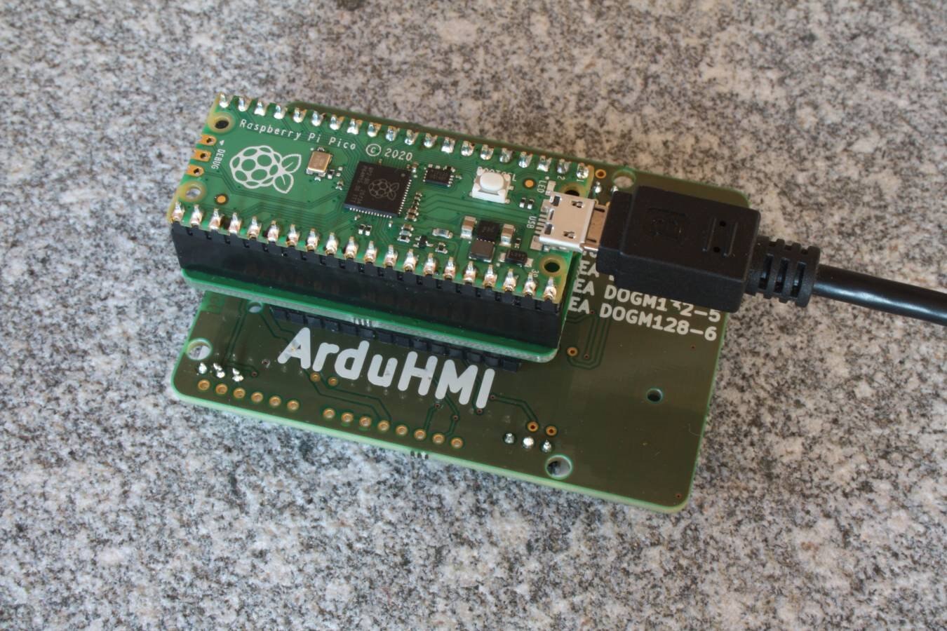

For previous projects I have already made an Arduino MKR shield with the display which I described here: NFC-Badge - Update your badge with your smartphone - Design data of the HMI shield The design data of the project is available on github: https://github.com/generationmake/ArduHMIShield
Additionally I have design an adapter to use Arduino MKR shields with the Pico: PicoMKRAdapter - connect Arduino MKR Shields to Raspberry Pi Pico
So the hardware was no big deal, just stacking the boards ontop of each other.

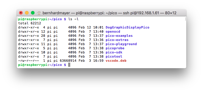

Unfortunately this seems not to be so at the moment. There exists a document how to get started ( https://datasheets.raspberrypi.org/pico/getting-started-with-pico.pdf  ) which shows you how to create your own projects. But as far as I have seen there is no concept how to use third party libraries.
The only way is to make your own directory along-side the examples directory and place all your project files in this directory.
I named my project DogGraphicDisplayPico. This screenshot shows where the project directory is located. If you use a raspberry pi as build system it should be in /home/pi/pico

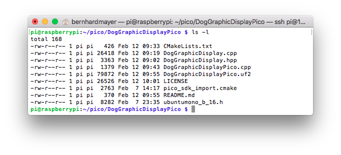

The files are all in one directory and glued together and connected to the pico sdk by a cmake file.
This project is highly based on my library for the Arduino https://github.com/generationmake/DogGraphicDisplay
The adoption for the pico was quite simple. Just replace the functions to access the GPIO pins. So change from digitalWrite() to gpio_put() and the same for the hardware SPI access.

The complete source code with the make file is available on github: https://github.com/generationmake/DogGraphicDisplayPico
Build process and programming
The build process is also very straight forward. Just create a build directory and generate the make files there.
mkdir build
cd build
cmake ..
make
This generates a file DogGraphicDisplayPico.uf2 (amongst others). Then connect the Pico to your computer in the bootloader mode by holding the BOOTSEL switch while plugging in. The Pico will appear as a mass storage device. Just copy DogGraphicDisplayPico.uf2 to this device and it will be programmed and you are ready to go.
