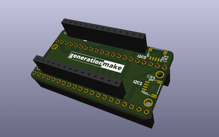

There are already a lot of Arduino Shields lying on my desk, some of them official, some of them designed by me and my friends. So I decided to get them running with the Raspberry Pi Pico and see how it is performing. To simplify the test setups I decided to design an adapter and this is it:
The Raspberry Pi Pico plugs into the one side and the Arduino MKR Shield plugs into the other side. Additionally it has two Qwiic connectors for I2C0 and I2C1 and a third connector for serial.

  • wolfgangfriedrich
    wolfgangfriedrich over 5 years ago +1
    Love the idea. I am a big fan of adapters like this. Did some shields that work on Uno and Feathers. An improvement might be to add resistor option to cross RX/TX and make the power rails directional with…

    bernhardmayer over 5 years ago in reply to wolfgangfriedrich +1
    Hallo Wolfgang, thank you. Yes, the square pads are GND. I saw this on the Raspberry Pi Pico and really liked it. The reset lines seems to work also. I have some shields with a reset button on them. And…
  • bernhardmayer
    Hallo Wolfgang,
    The reset lines seems to work also. I have some shields with a reset button on them. And pushing this button resets the Pico.
    At the moment it is only to connect Arduino Shields to the Raspberry Pi Pico.
    I am always afraid of connecting to processor boards together as they might drive against each other and the magic smoke might come out.
    Bernhard
  • wolfgangfriedrich
    An improvement might be to add resistor option to cross RX/TX and make the power rails directional with Schottky diodes and then be able to plug in a Pico and a MKR controller and have a multiprocessor system.
    I did not check, but do have RESET and RUN correct directions/polarities to not block the other part?
    Oh, and silkscreen on the pins to label their function would be nice. Are the square pads GND? Nice detail.
    Good work,
    - Wolfgang.
