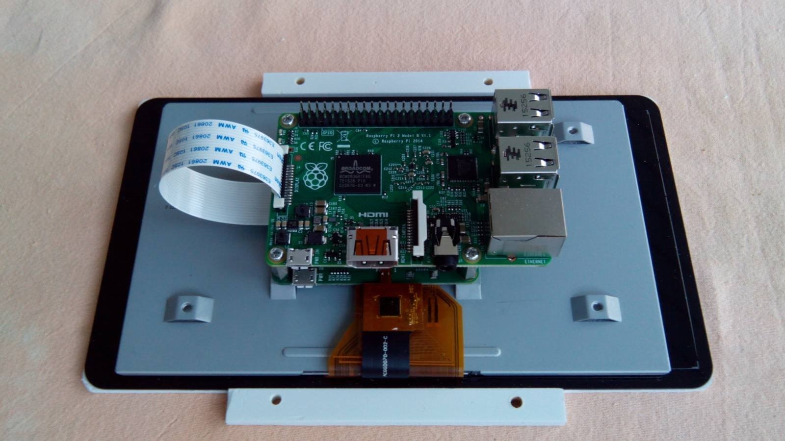

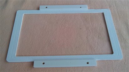

Measuring the display on both sides I have created three different frames: one front-frame and two back frames.

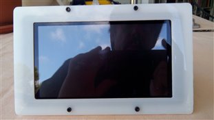

Front frame

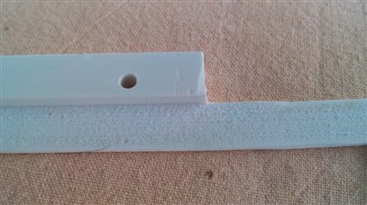

Front view of the front-frame; the two extra-area corresponding to the top and bottom sides are used to keep the front and back frames together. This model is so shaped because these are also the supports that keep the display inside the info-pointsupport. A further version with a full thick border will be producer with the same characteristics.

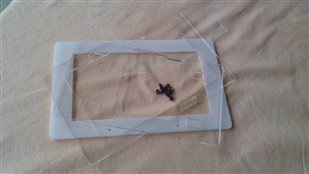

Back of the front-frame. The two elements that are part of the structure will also help to keep correctly positioned the touch surface over the LCD surface.

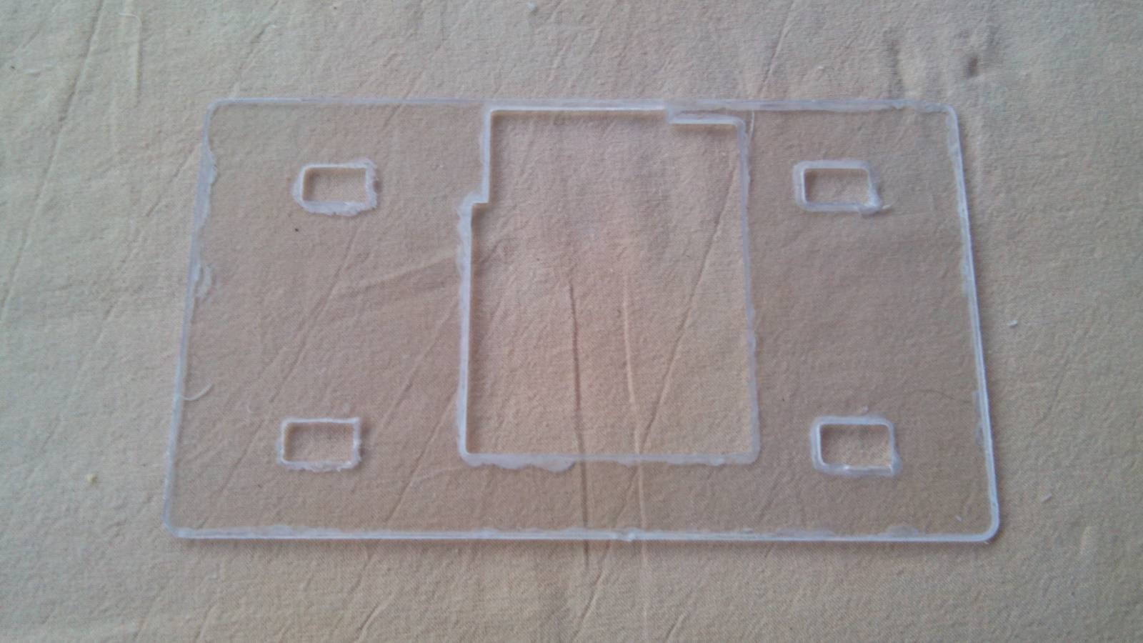

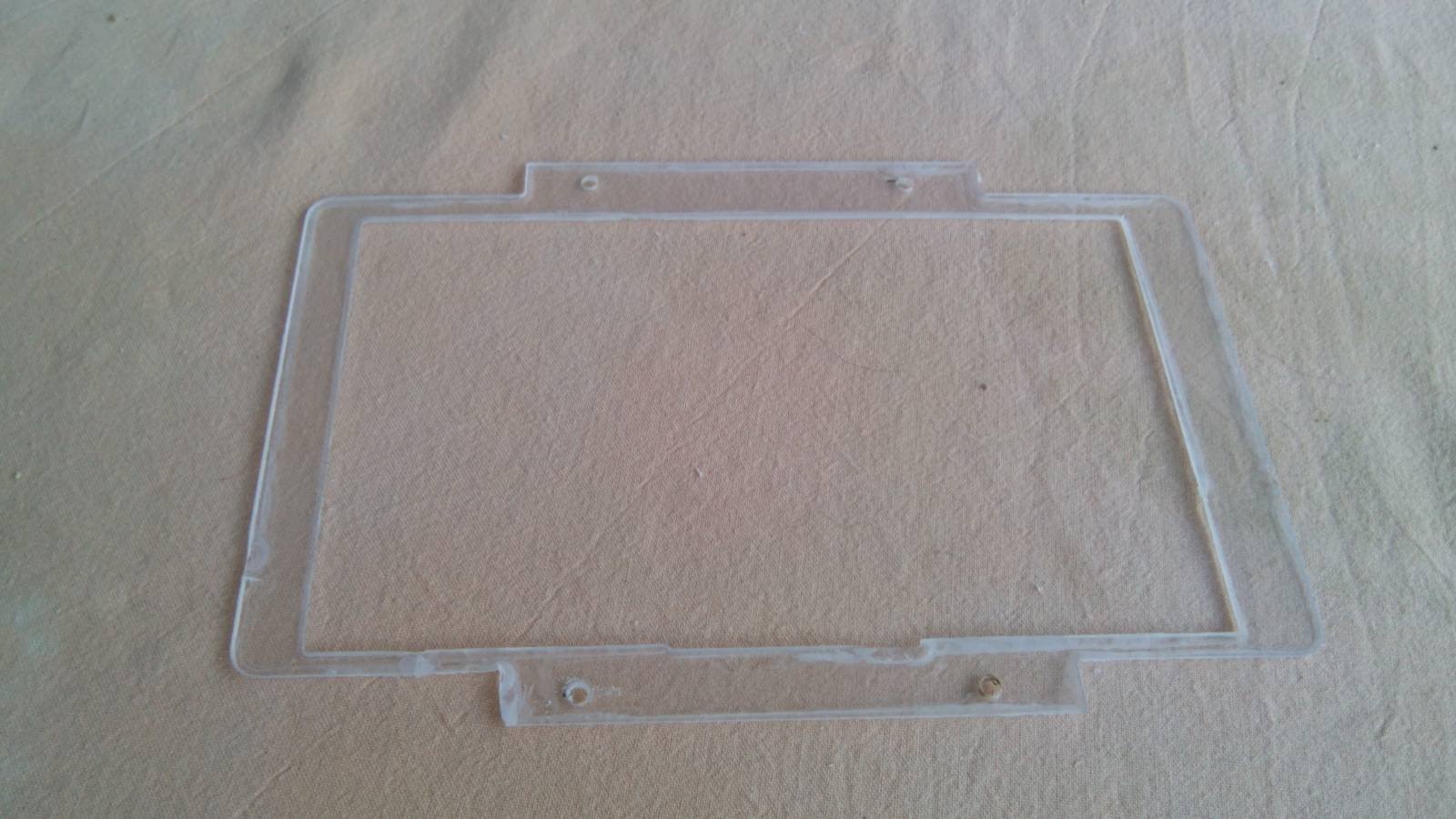

Back frames

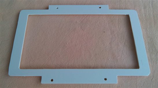

There are two frames on the back side of the screen. The first is locked with four allen screws with the front-frame while the second frame protect the remaining part and offers the base for the back cover of the electronic parts (cables, dipslay control board and Raspberry PI). The opacity in the frames of the images below depends on the prototype manual refining. In this prototype I have used a 2.5 mm thick acrylic but the right final material should be opaque, white 3 mm thick.
First back-frame, the nearest to the screen surface.
Second back-frame.

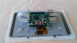

1) Put the front-frame on a flat surface and the screen device on it (the Raspberry PI should not yet be fixed with screws on the display controller board) remember to remove the protective label from the front side of the screen.
2) Place the first back-frame on the screen and insert the four allen screws. Then close firmly the four nuts.

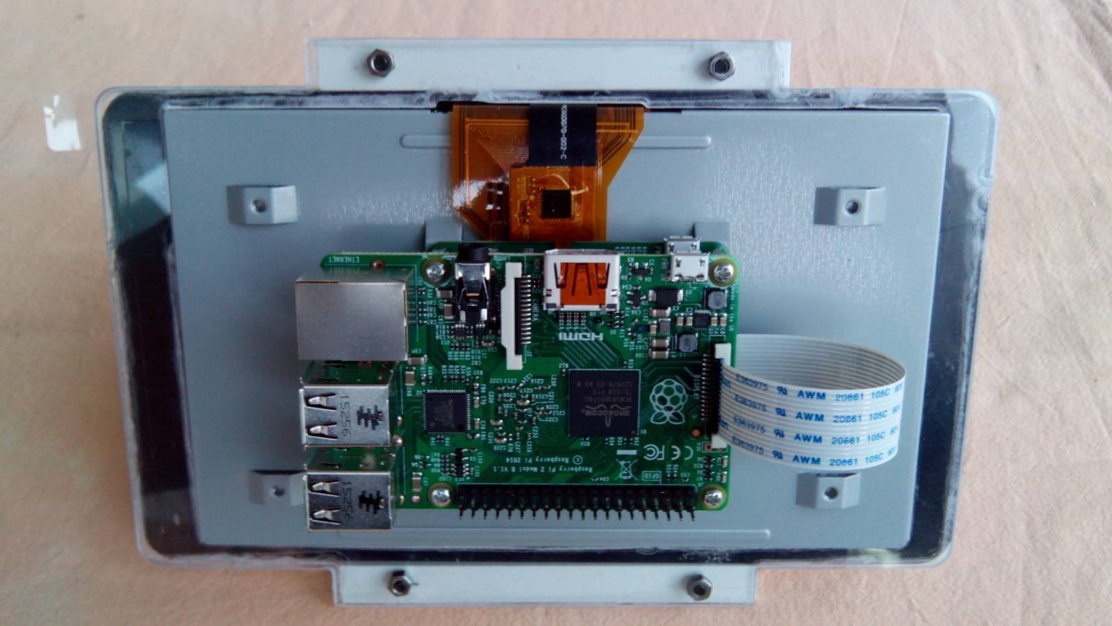

3) place the second back-frame and fix it to the aluminium display four holes with screws. Last, fix with the four screws the Raspberry PI over the display control board.

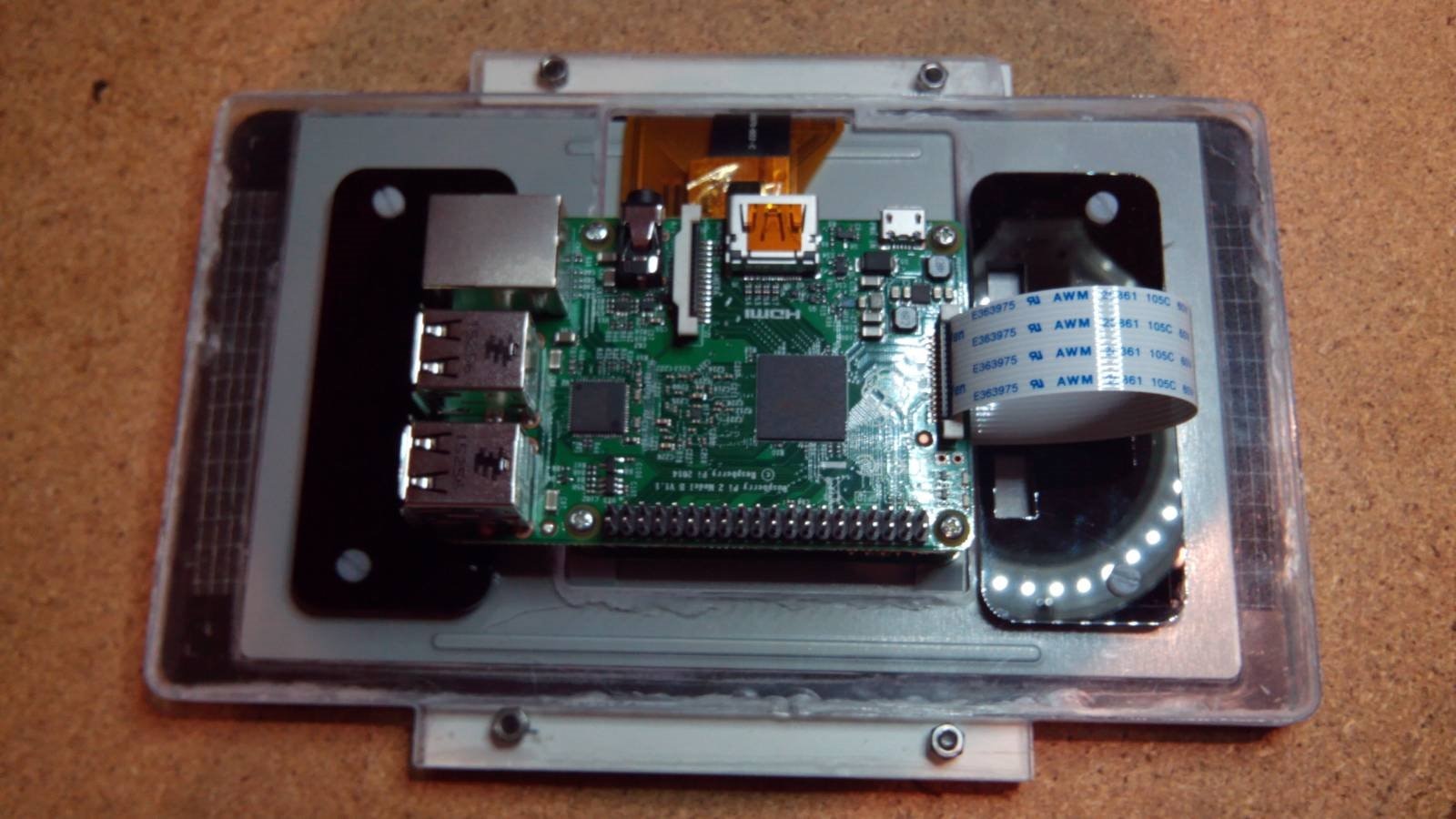

In the image above the top frame is locked with two black pieces of plastic, that can be replaced with a 3D printed cover to protect all the electronic parts.

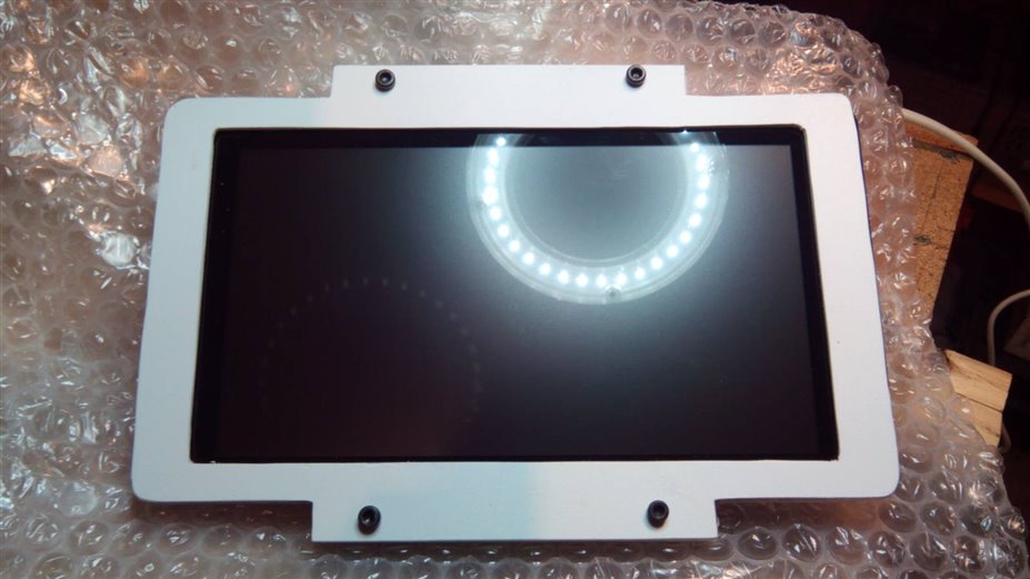

Ready to use
The following image shows the finished frame.
