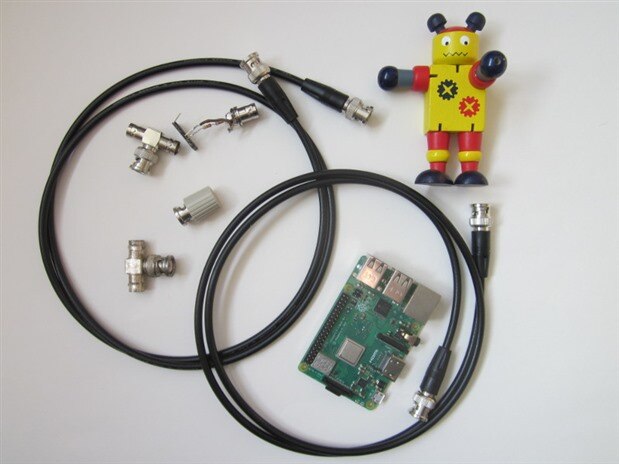

OK, what simple experiment can I do with this collection of items? A Raspberry Pi 3 Model B+, a
couple of 1m 50 ohm coax cables [RG58C cable], a 22R resistor, and a SIL connector.

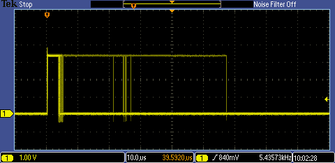

This is how the output looks with no coax connected to the BNC socket.
The Python program manages to take the pin high and then low again in about 4uS, though the width
is very variable (which we'd expect as interrupts aren't disabled). It is fine for what I want
here. I'm not interested in the pulse width itself: I'm going to be looking at the start of the
pulse and what happens over the first few tens of nanoseconds.

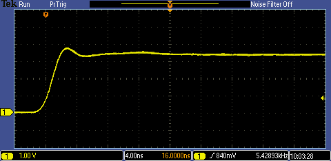

Here's the leading edge in more detail. I'm probing this without the probe's flying ground lead,
using the collar for the ground connection instead. Ideally, I'd use a connector or some handmade
'springy clips', but, being lazy, I'm just precariously holding the probe in place and trying to
operate the 'scope with the other hand. Don't worry, trust me, it'll work! There's a small amount
of ringing evident on the trace, but it's not too bad [this is all going to be less than perfect
because of the signal having to find it's way across the Pi board and through the connector,
before encountering the 22R, but it's good enough for my purposes here].
Now. What I'm going to do is I'm going to connect the two lengths of coax to the output, with a
'T' piece connecting the two together. BTW there's nothing significant about two cables and a 'T'
piece: I just wanted something a bit longer than a metre to work with. The T piece will have very
little effect: it maintains the 50 ohms impedance of the cable nicely through the junction and
the stub it adds is so short that I probably won't even be able to see the effect on the trace.
So I have a 2m length of coax on the output, with nothing at the other end. The far end is just
an open circuit.

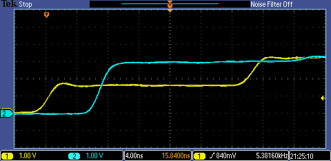

So, what does the signal look like when it reaches the other end? From all of the above, you
might be worrying that it's a mess, but it all works out right. At the far end, when the signal
reaches that point, the signal reflects and immediately doubles, so the waveform seen by anything
with a high impedance (like a CMOS gate input) will look very like the original signal coming
from the IO pin.
Here it is. The signal at the start of the line is yellow again, the signal at the other end is
blue. I did that by simply plugging the end of the BNC cable into the second channel connector,
so the termination is 1MEG and 11.5pF.

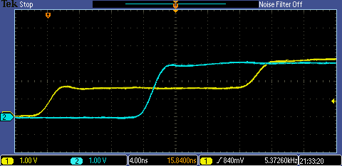

Um, except that's wrong. The signal is emerging before it should do. [It appears to be getting to
the end faster than a photon in free space could, which is going some! Hang on just a minute
whilst I run off and patent my faster-than-light gadget.] On second thoughts, the reason is
really that the two channels of the scope are only time-balanced if we have similar probes
attached to both channels. Here it is again with the cable output being probed by another 10x
probe, identical to the first.
Now the output is in the right place, halfway along. Whilst not perfect, the signal at the far
end isn't too bad given that it has travelled a couple of metres and the series termination at
the start is far from perfect anyway [ideally, the resistor would be right next to the processor
pin].

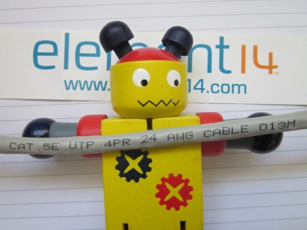

Update 24th March 2020
I found a short length of CAT-5E cable, 2.11m in length [no screen, just the four twisted pairs], so I thought I'd try the same test as I did with the 50R coax on a single pair in the cable.
The characteristic impedance is apparently 100R, so I've used a 68R series resistor for the termination. Here's how it looks at the sending end.
That works out to be a velocity factor of 63.7%, so a little slower than the coax.
Here's what emerges at the other end [blue trace].
It's not as nice as the coax: the probe connected at the end seems to be having more effect on the waveshape than what I saw with the coax.
