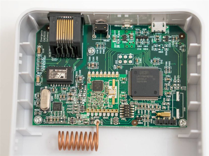

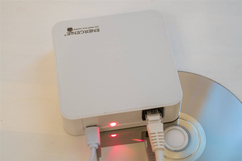

The gateway device which interfaces to all the rest of the Mi|Home ecosystem is really compact. It is only very slightly bigger than an ice hockey puck. There are just two ports on it. One is a USB connector for the 5V power supply (it comes with the Gateway) and the other is for the Ethernet cable to attach the gateway to the home router. One dual-colour LED and a pinhole reset switch completes the external features.
The entire thing is small and unobtrusive and runs cool, and can be hidden from view. The top cover can be unclipped to look inside. There is not a lot to go wrong here, it should provide many years of good service. The circuit consists of a fairly high-end ARM Cortex-M3 based microcontroller from NXP, an Ethernet interface and a very popular RF transceiver module from HopeRF. Good brand parts are used like the Wurth Ethernet transformers. The enclosure is of a sufficient size to allow the antenna to have space around it for good range.
What looks like a standard debug port is also present. Lots of great potential to use this as a low-cost board for other projects too!
Using the Gateway is pretty easy, it is plug-and-play. No configuration needed. You can take the code printed on the underside and apply it to the Mi|Home web portal once you have registered. For most users, there is no router configuration to do either. Just plug in the power supply and Ethernet connection and provided you have the code you’re ready to start using it.

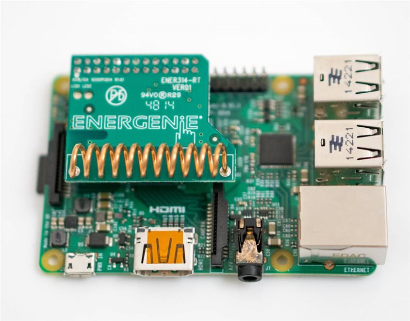

For those unwilling to connect to a cloud service there is an add-on board available for the Pi, which, with some coding, can be used to control the devices locally.

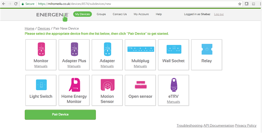

Using the Mi|Home Cloud Service and Mobile App

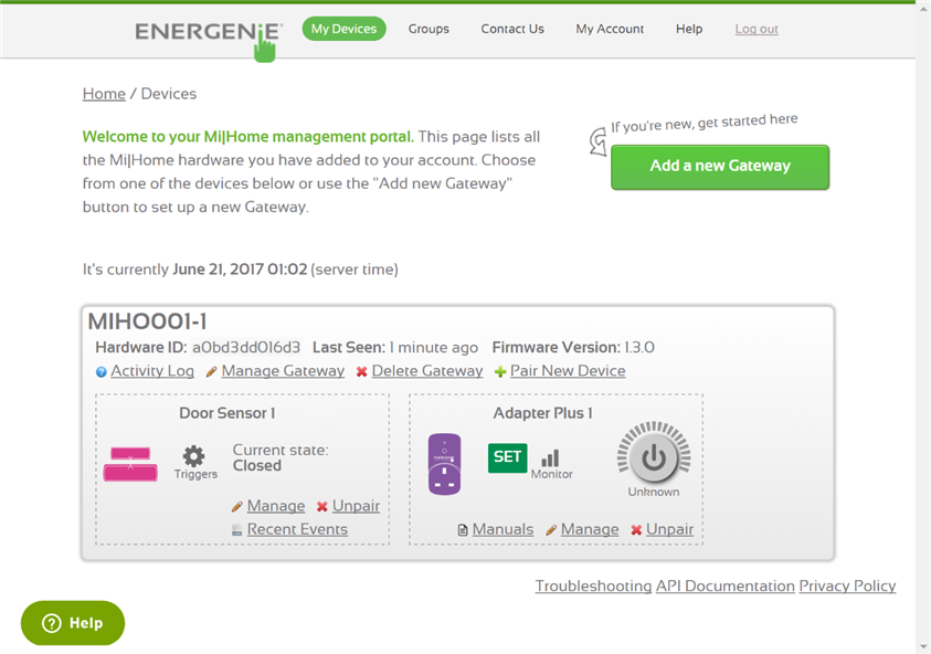

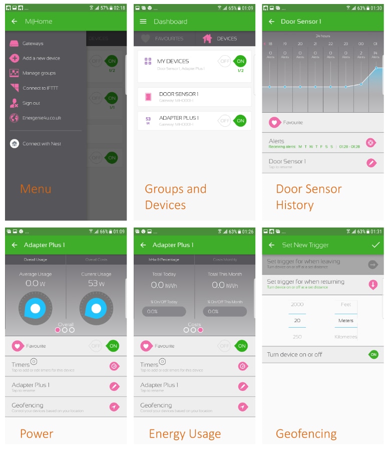

I browsed to the Energenie Mi|Home website and registered for free and entered the code printed on the back of the Mi|Home gateway, and it was immediately registered. It is all very intuitive and once the gateway is added you can give it a name and start adding additional devices by clicking on ‘Pair New Device’. As soon as you do that the web page shows the entire product range.
The color coding is roughly proportional to functionality. The basic products are blue and provide simple control in one direction. The pink items are monitoring products that gather information but do not have any controlling capability. The purple items are full-featured and offer both monitoring and control capabilities. This colour-coding matches the glossy card packaging of the devices too, so you can easily see the broad functionality that you are getting.
The product range can be configured in a consistent way. The procedure is to connect/plug in the device so that it is powered up, then hold a button down for 5 seconds until and LED flashes. Assuming that ‘Pair Devices’ and then ‘Start Pairing’ had been clicked in the web browser first, then the device will become attached and will appear in the Devices List; in the screenshot below I added a door sensor and a mains control adapter:
It is actually possible to do this from a mobile phone too. The pairing for the device can be done anywhere within radio coverage of the Mi|Home gateway using the Mi|Home app.
You can also assign custom friendly names to each device; this is handy when you have many devices connected, but also is useful for voice control by device name; see further below). The app is easy to use and during my testing I didn’t notice any bugs or crashes. There is also the ability to integrate with IFTTT which is a way to have rules such as “if the weather is cold the turn on the heating” however I’m not keen on IFTTT due to the need to have facebook/twitter for the free account in order to create your own applets. There are other ways of achieving such things and they will be explored in another blog post.
An interesting feature in the Mi|Home app is the ability to 'geofence'. This allows the system to control devices based on the location of the mobile phone. An example would be to turn on the heating if you’re approaching home.
In summary I thought the app was not bad, it is useful for checking up on the status of things in your home and controlling them of course. There are no fancy features like the ability to have a status widget on your mobile phone or to log data.
With the app installed, it was time to start pairing and exploring all the interesting devices!

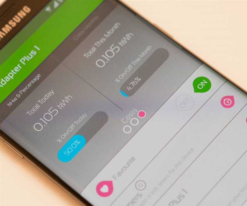

Energenie Mi|Home Adapter Plus

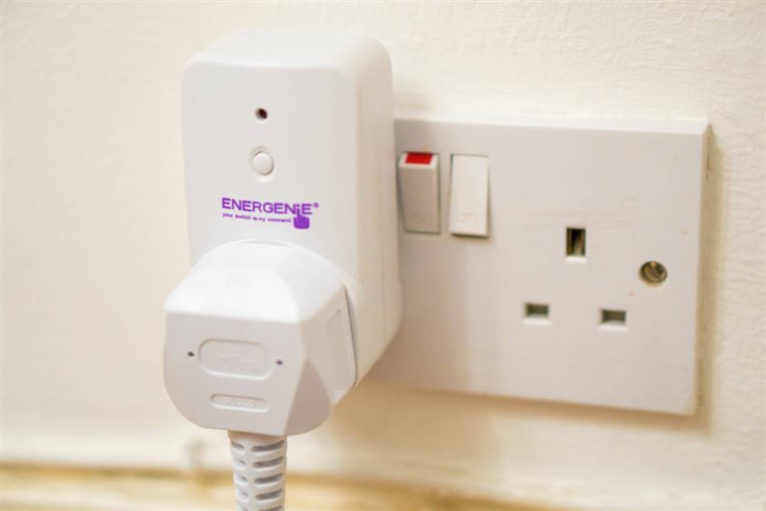

The Energenie Adapter Plus is a very cool advanced ‘smart plug’. I thought it was great. It has a number of features. There is a small button on it and an LED, and any connected equipment can be powered or unpowered by directly pressing the button on it. The status is sent back to the home gateway, so that the user can check via the web portal what the actual status of the Adapter Plus is. This product is within the purple range, i.e. more feature-rich and with control/monitoring capability. Furthermore the Adapter Plus can be used to measure power consumption. This is extremely useful even if you’re not interested in actual energy usage, because it can tell you if the appliance at the end of the cable is actually switched on or off by observing the power consumption. So, you can use it to tell if (say) a television itself is actually powered up or not.

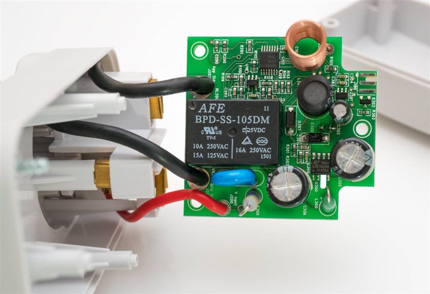

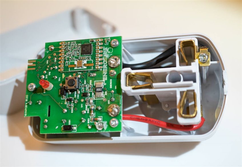

It was interesting to examine it in more detail, to see precisely how it functioned and how accurate it could be.
It has security screws and once they were removed, I was impressed at the quality of construction. The earth and neutral connections are direct from the mains plug side to the mains socket side of the product. The Live connection is switched of course, and all wires are crimped to the metal components of the plug/socket portion of the design. The PCB is made of fiberglass and there is a fair amount of circuitry. The radio transceiver module is a HopeRF board again, with a helix shaped antenna soldered perpendicular to the circuit board on the side hidden from view.
There is a 2 milliohm shunt resistor for measuring current. The other side of the board contains a nice DC-DC converter circuit. The AC mains input is rectified and directly stepped-down using the DC-DC converter. This type of design will run cool and in practice I could not observe any warmth of the device during operation. There is also a varistor for protecting the circuitry from excessive mains spikes, for hopefully many years of good service. A dedicated IC performs the energy measurement and communications protocol handling before passing the data to the HopeRF module for transmission. The dedicated IC from Sentec handles reactive loads (i.e. it can measure real power) and the datasheet states that power measurement accuracy is 2% or 2W, whichever is greater. Although not spectacular, this is a reasonable level of accuracy for such a device.
The mains is switched using a relay which has UL and TUV certificates. In summary I thought the design was good, I liked that it had some protection against spikes from mains input noise, the power consumption feature is really cool to see what devices are actually powered up, and a push-button switch to be able to turn devices on/off locally if desired.

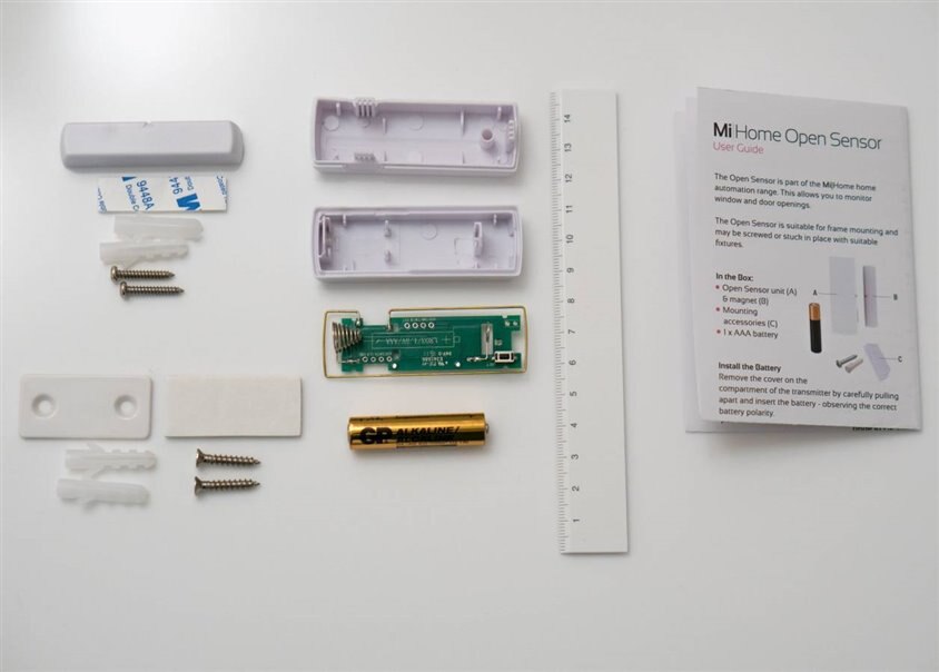

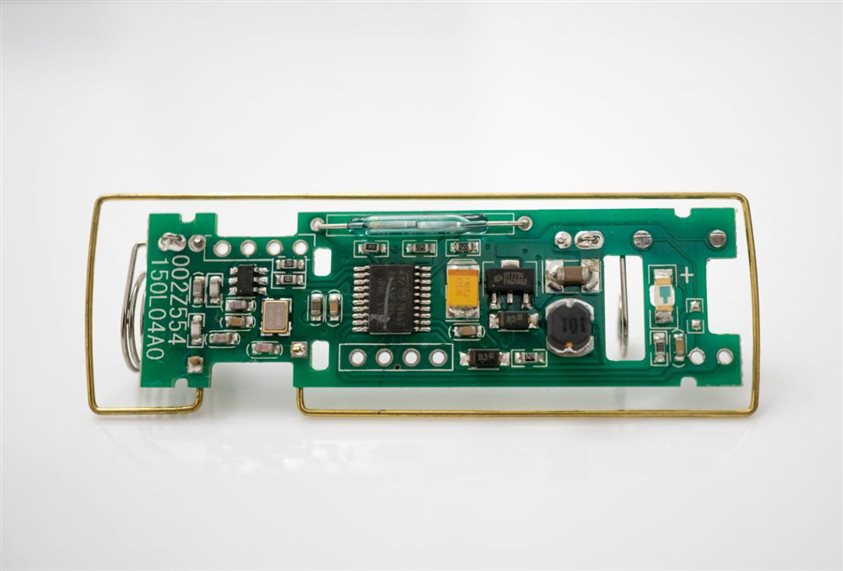

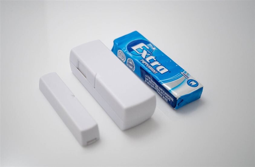

Energenie Mi|Home Open Sensor
The Open Sensor does exactly that, it reports when something like a door or window has been opened or closed. It is a small single AAA cell powered device. It has low power consumption, I measured 50uA (it periodically changes between about 40uA and 60uA), and current of course increases during radio transmission whenever an open or close event occurs. Based on this, Energenie’s estimation of 1-1.5 years battery life appears accurate. I liked that it uses a standard AAA cell because they are cheap to replace compared to the small 12V batteries that used to be common in wireless sensors in the past. The sensor has the typical two-part magnet and reed switch implementation.
The design is very nice; there in an internal 3V DC-DC step-up converter that presumably runs continuously, and a low-power microcontroller. As mentioned a reed switch and magnet performs the actual detection. The transmitter is a tiny 6-pin SOT-23 device, most likely another HopeRF part.
There is a very discreet faint LED that shines through the white plastic, and it is useful for confirming that the battery is functioning because it flashes briefly each time the door is opened or closed.
Inside the box there were lots of mounting bits and pieces for attaching to doors/windows, and a card instruction leaflet.

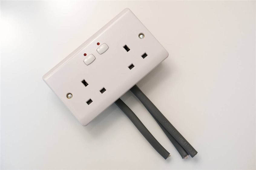

Energenie Mi|Home Double Socket

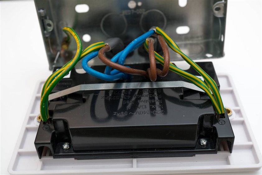

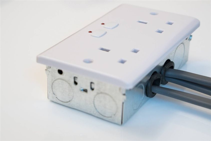

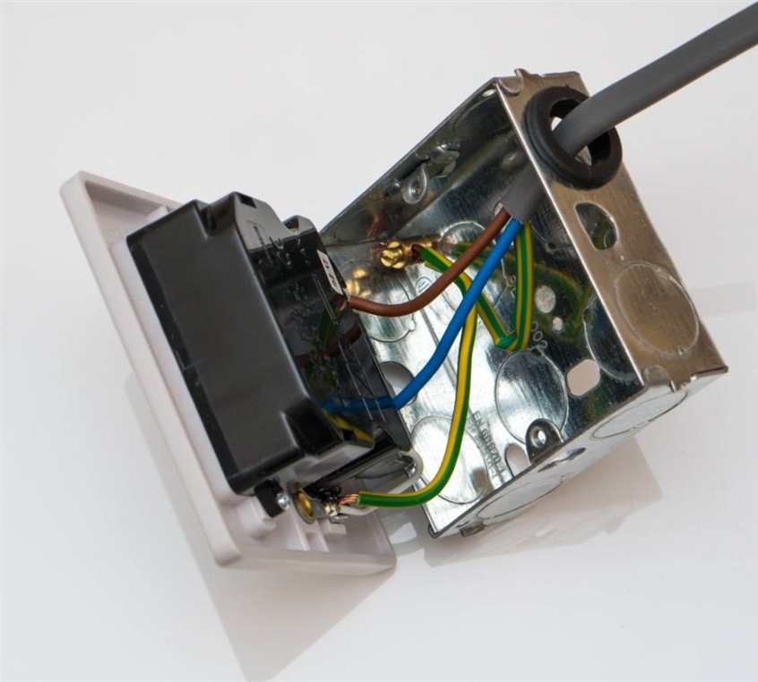

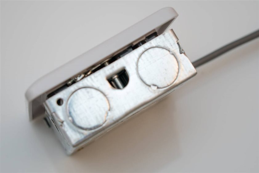

In the blue range (i.e. control, not monitoring capability), I tried out the Mi|Home mains wall socket. This product can be fitted into a new electrical installation, or retrofitted. Its connections are identical to any standard double socket, and I liked that it had two earth terminal connections which simplified installation.
The unit is quite deep, and it will be a real struggle to fit into a 25mm deep back box if there is more than one mains cable coming into the back box (more than one mains cable is common, since a ring mains will result in two cables into each box). However, a 25mm back box for ring mains is rare and homes should have deeper boxes usually. With a 35mm back box (as in these photos) there is no issue, and I tested with three mains cables; it just about fitted. With two mains cables it fits just fine.
Another approach for retrofitting is to leave the existing mains socket where it is, and fit the Mi|Home one alongside it as a spur connection. As a result, a 25mm back box is fine since the spur connection only has one mains cable. Also, if you didn’t want to go making too many holes in your wall, you could always fit it alongside to an existing mains outlet but in a surface mount box; that way you only need to plaster and repaint a very small area. This latter option should also result in better radio coverage so it would be worth considering if the Mi|Home gateway is positioned far away (or a second gateway could be purchased; multiple ones can be added in the Mi|Home solution).
So, to summarize, if you’re installing with a single cable, then a 25mm back box is ok, otherwise you will definitely need a 35mm back box minimum and it will be tight but feasible with three mains cables, so if you have the choice, go deeper.
In terms of aesthetics and the finish of the plastic I think it looks quite reasonable, no better or worse than typical home mains wall sockets. There are are also versions with brushed steel, or chrome or nickel finish if you need to match it to others in the home.

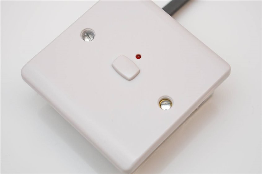

Energenie Mi|Home Light Switch
Another item in the blue range are the Mi|Home light switches. They are optionally available in the metal finishes just like the mains wall sockets.
It has a depth of about 22mm, and so it requires a 25mm depth back box at a minimum (usually the boxes are recessed by at least a few millimetres into the wall, so that will also help to provide sufficient clearance for the mains cable. The photos here shows a 25mm box.
If you’re replacing an existing light switch then the chances are that the back box will be more than 25mm deep, however I have seen very shallow back boxes (15mm) as was the case in one room at home, and these would not be suitable. It isn’t difficult to make any cavity deeper (no need to do that with a stud wall) and replace the back box of course.
What seems to be missing from the range currently are double light switches. This actually made it awkward to install in a couple of rooms, since I wanted individual control of the two lights in the room.

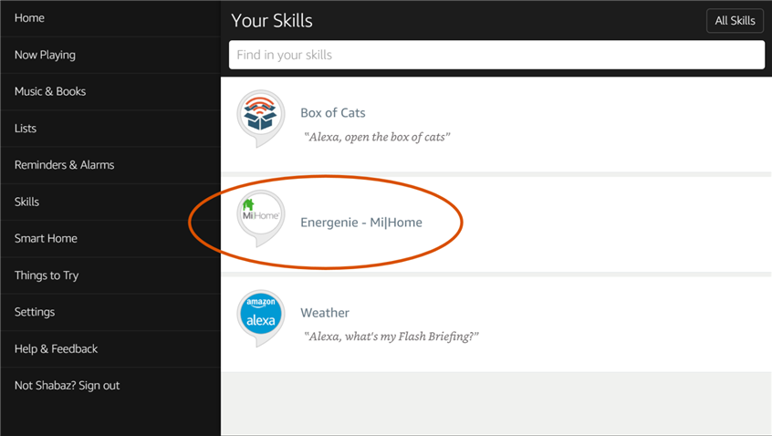

The setup is extremely easy; I signed into my Amazon Alexa account and searched for the Energenie ‘skill’ and enabled it.

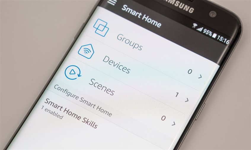

Next, by clicking on the Smart Home item on the menu on the left, a ‘Discover’ button appears. I pressed that and less than a minute later the Mi|Home devices appeared.
That’s it! Now the home can be controlled by speaking to Alexa. The devices can be named anything in the Mi|Home web portal or mobile phone app, so turning a device on is as simple as saying (for example if the device has been named ‘bedroom lamp’) “Alexa, turn on the bedroom lamp”.

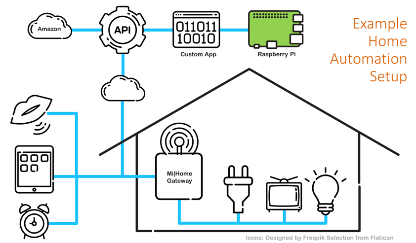

Application Programming Interface (API)
The Mi|Home cloud service has what is known as an Application Programming Interface (API). This offers control of your home programmatically. In other words, you can connect additional software and services to control the home. I did a basic ‘hello world’ type of test to confirm that I could connect using the API, but further use of the API will be explored in more detail in a subsequent blog post.
