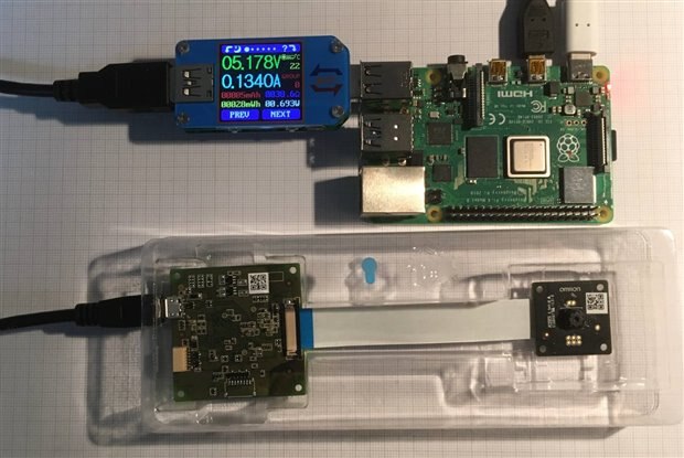

Let's first have a look at the hardware. Ralf has a interesting post on all hardware versions for Omron HVC technology: Omron HVC-P2 Roadtest - OKAO Vision Technology.
Mine is the HVC-P2 Camera and processor on separate boards. Communicates over serial UART. Here is a picture. Raspberry Pi on top, HVC-P2 connected to an USB2 port.
As you can see the power consumption (measured with board in action) is not very much for the challenging task the board performs.
When the HVC-P2 is connected to an usb port, a serial device is created. Below you see the list of tty devices before and after the unit is connected.
The units serial port is /dev/ttyACM0.

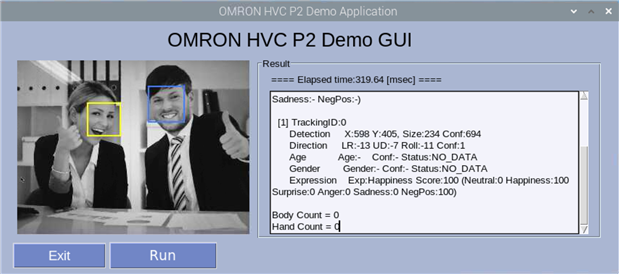

That was easy, less than an hour work. So I decided to play a bit more with the device, and make a simple graphical user interface on top of execution.py using PySimpleGUI.
I made a copy of execution.py to execution_gui.py and added a function to create a guide window:
def creategui():
    sg.ChangeLookAndFeel('BlueMono')
    frame_layout = [
                  [sg.T('Elapsed', size=(60, 1), key='-ELAPSED-')],
                  [sg.Multiline('', size=(60,12), autoscroll=True, key='-ML-')],
    # define the window layout
    layout = [[sg.Text('OMRON HVC P2 Demo GUI', size=(50, 1), justification='center', font='Helvetica 20')],
              [sg.Image(filename='', key='image'),
               sg.Frame('Result', frame_layout)],
              [sg.ReadButton('Exit', size=(10, 1), pad=((0, 0), 3), font='Helvetica 14'),
               sg.RButton('Pause', key='-RUN-PAUSE-', size=(10,1), font='Any 14')]]
    # create the window and show it without the plot
    window = sg.Window('OMRON HVC P2 Demo Application',
                       location=(400,200))
    #window.Layout(layout).Finalize()
    return window
Next the main loop is extended with code to handle the 'exit' and 'run' buttons and to process the tracking results. For now the camera image is displayed and the detected faces are annotated with a box. The rest of the information (gaze, gender, expression etc.) are just shown in a text window.
The boxes are yellow when the gender is not known, blue for men and pink for woman.

And here is the result:
I will add more functionality in the future.
