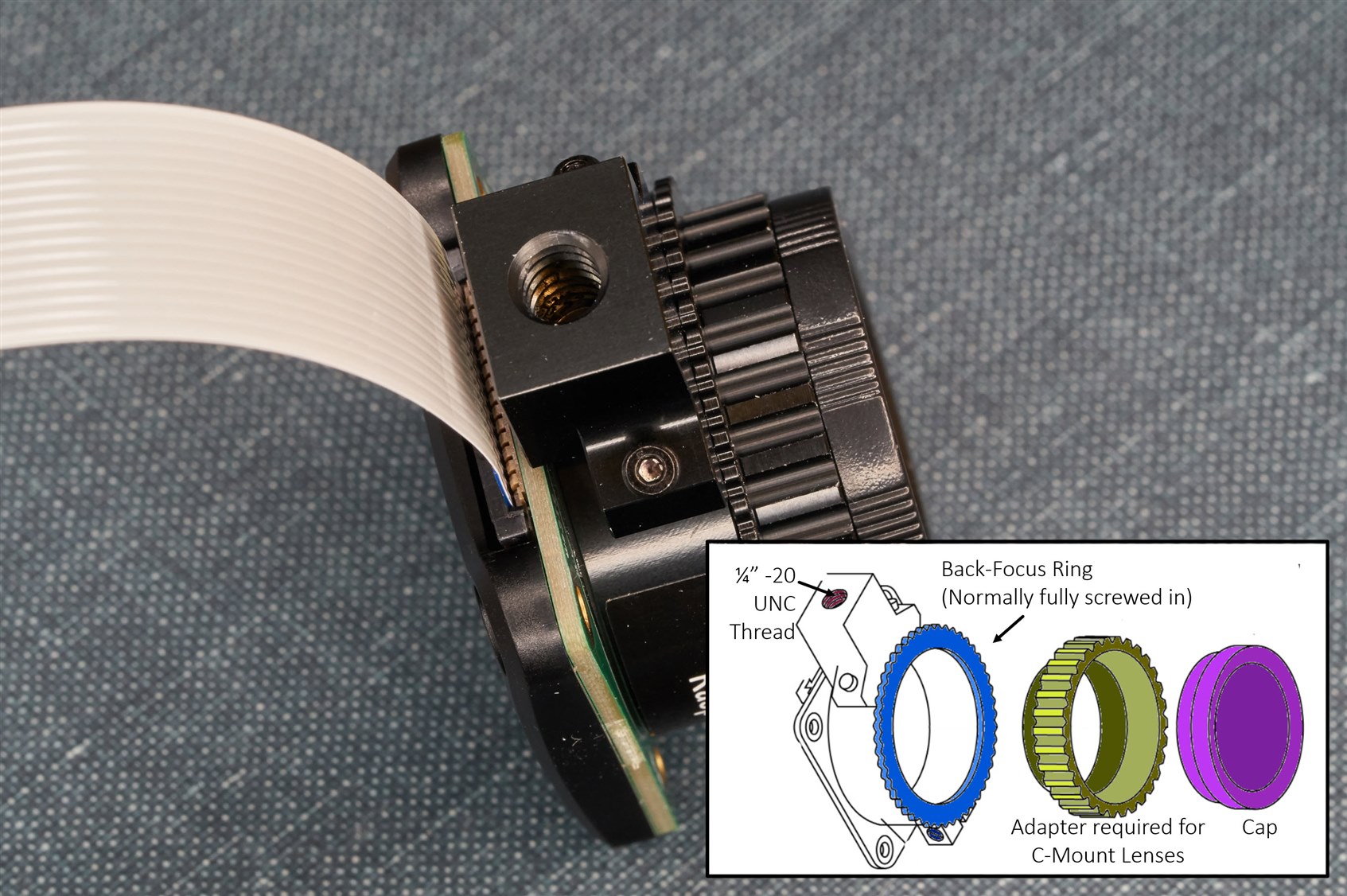

The photo below shows the various elements of the camera.
(Diagram source: The drawing is taken from the Raspberry Pi website)
The screw thread (indicated in the photo above) fits typical tripods, although the flat flex will get in the way a bit, so a bit of care is needed to be gentle when doing that.

Note that C-mount and CS-mount lenses have the same thread, but if you have a CS-mount lens, the adapter ring (that was indicated in one of the photos above) would need to be unscrewed so that the focal plane of the lens can reach the sensor.
