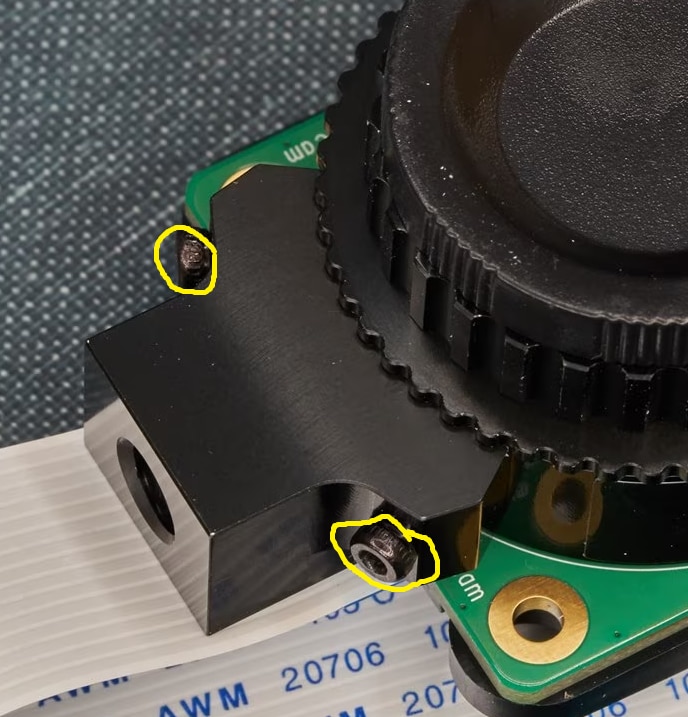

    I see that the tripod thread is screwed on the lens housing with two screws. If a smaller housing si needed, mayber it's possible to remove the tripod contraption, and make a different housing that uses those same screw positions?
