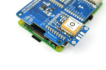

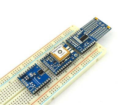

I work in a hardware startup "Modulowo" and I would like to propose a new, universal connector for development kits - ModulowoRegistered duoNECTTm. The connector provides the basic interfaces like UART, I2C, SPI, 1-Wire, a few I/O pins and ID (Identification) pin. The advantage of our connectors is possible to mount by traditional pin 2.54 mm or directly on the base plate thanks to castellated holes. Our solution is not only duoNECTTm connector, but also add-on modules - ExploreTm boards - and adapter for Raspberry Pi 2 or B +. The adapter has three duoNECTTm connectors, but it will be six modules can be connected. In addition, EEPROM memory and 12-bit Analog-to-Digital Converter (16-bit optional). A little more detail: http://blog.modulowo.com/en/modulowo-duonect-czyli-uniwersalne-zlacze-dla-modulow-elektronicznych/
Are our solution can be an interesting proposition? A few photos below:

    Referring to the LCD, it will offer a simple and inexpensive wireless solution via Bluetooth. So, LCD with encoder for control, do not need to be installed above Raspberry Pi.

    My experiance so far with the varied connector systems out there (Booster packs, Arduinos, Raspberry PI etc) is they all limit you to one or at best two add ons at a time
    In almost al cases I have worked on reciently I have wanted to do more
    like an LCD, Touch, ADC, DAC and maybe a few digital I/O, this is rarely available and stacking up into a tower is not the answer either. A stack that allows the driver for an LCD, ADC, DAC etc is one thing but to get a working prototype you need to be able to spread out things a little and have connections to numerious boards / devices at once
    I much prefer a set of I2C and SPI connections available through a set of 4  or 6 pin connectors and then a seperate set of Digital IO which could also be connected through I2C or SPI. This is what these buses where designed for SPI - "Serial Peripheral Interface" and I2C "Inter-Integrated Circuit"
    If your prototype needs to be mounted into a demo case / enclosure the boards need to be mountable (ADD HOLES FOR THIS), for instance having an LCD stuck onto an Arduino or PI but no means to have the LCD on a panel has a limited use, having it mountable with a short lead to the controller is far more useful. same goes for the sensors, convertors etc, they need to be able to be placed in an appropriate place, not sandwiched in a multilayer stach where heat and other factors affect performance

    We wanted mainly to the possibility of mounting add-on boards directly on the motherboard / adapter, so that was not created high "stack".
    I understand that, but you can still achieve that objective while maintaining compatibility. You can have had castellated connections that are still compatible with the MikroE layout.
    We also have something for the TI LaunchPad, but it's still not ready.
    MikroE have such a board for LaunchPads, they call it a Click Booster Pack. I'm guessing you have some more differentiators that perhaps were not clear so far, otherwise there looks like little difference between
    the two ranges except that MikroE's is larger/more established.
    Castellation isn't really important for prototypes surely? Besides, pins can be trimmed so that boards are within a few mm of each other, or removed (i.e. desoldered) totally for flush fitting
    if there was a strong requirement to minimise height in a prototype.

    Thanks for the suggestions. It's important to me. We wanted mainly to the possibility of mounting add-on boards directly on the motherboard / adapter, so that was not created high "stack". Furthermore, matching the signals to + 3.3V / + 5V voltage and the ability to quick replacement board to another.
