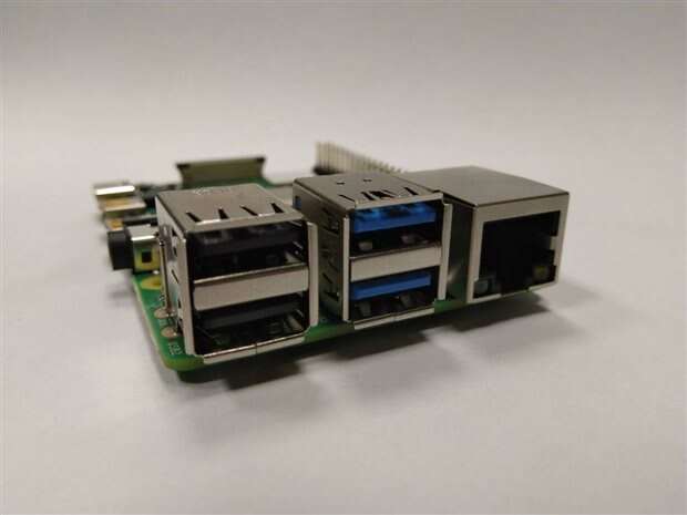

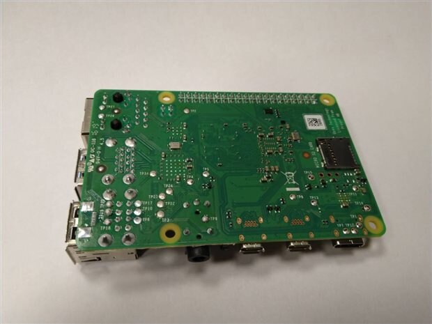

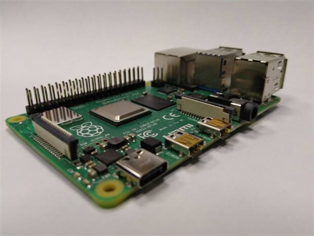

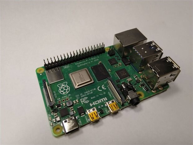

I know there are and will be many reviews, tests and benchmarks of the new Pi 4 on the internet, but I can’t resist writing a few sentences about the Pi itself.

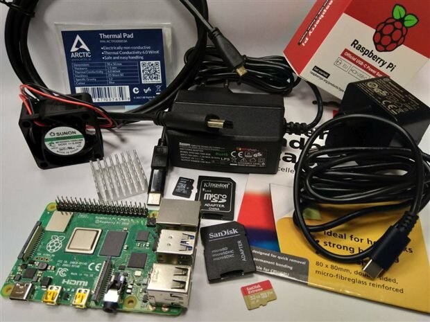

I receiver just the Pi, so I immediately had to buy the rest of the necessary stuff: power supply, SD card, microHDMI cable, cooling accessories etc.
Here comes the first difference – new power supply is connected via a USB-C connector and the specification says 3 Amps are needed (old supply used microUSB and supplied 2.5 Amps). I bought the original one and had no doubts it will work. I also tried a non-original microUSB adapter (which could supply up to 3 Amps) and a microUSB<>USB-C adapter. This setup also worked.
I found some older Kinston SDHC 8 GB Class 10 card at home. Later I decided to do some performance comparision. I chose microSD card according to this benchmark: https://www.jeffgeerling.com/blog/2019/raspberry-pi-microsd-card-performance-comparison-2019
One of the cheapest, but also most powerful cards was SanDisk Micro SDHC Extreme 32GB 100MB/s A1 UHS-I U3 V30. As it turned out later, there is a huge difference in SD cards performance!
After reading a few reviews, I already knew there is no point in putting the Pi into a solid enclosure (especially the original one), so I currently run a bare board. The idle temperature is about 55 Centigrade and gets to ca. 65 during non-intensive work. I haven’t applied a heat-sink yet, but I have one prepared for future use. And a 4 x 4 cm fan if it won’t be enough.

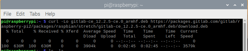

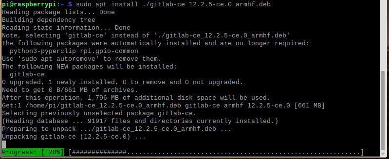

Step one downloads the package. Be prepared for a 630 MB download!
curl -Lo gitlab-ce_12.2.5-ce.0_armhf.deb https://packages.gitlab.com/gitlab/raspberry-pi2/packages/raspbian/stretch/gitlab-ce_12.2.5-ce.0_armhf.deb/download.deb
Now install the downloaded package:
sudo apt install ./gitlab-ce_12.2.5-ce.0_armhf.deb

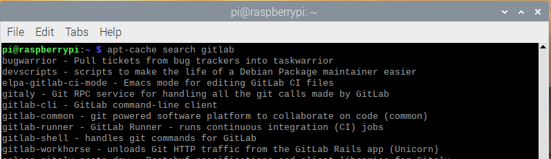

Note: in the beginning, if you search for a package using a keyword “gitlab” in Raspbian, you get a few community built packages, but not the official “gitlab-ce” package as described above!

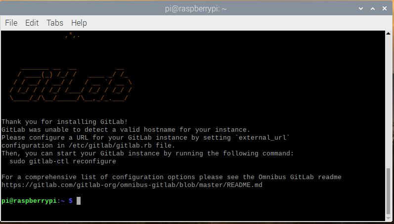

Now let’s get back to a gitlab-ce package installation. The installation took almost 2 minutes (10 minutes with an older card!) and as you can see in the previous screenshot, consumed almost 1800 MB.

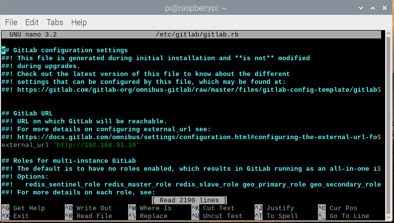

As suggested at the end of the installation, it is necessary to set an IP of the Pi to the external_url parameter in the configuration file. I put my local IP of the Pi there (don't delete the http:// ).
sudo nano /etc/gitlab/gitlab.rb

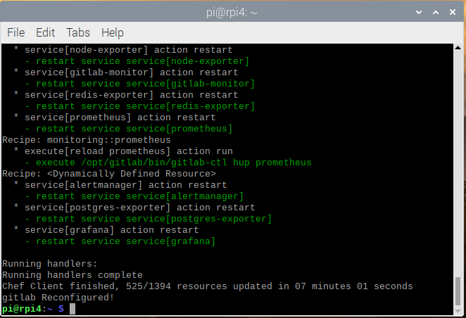

I skipped the recommended Pi-specific changes (creating swap, reducing the number of concurrent processes, optionally creating ZRAM swap) and started a recofiguration.
sudo gitlab-ctl reconfigure
The reconfiguration took 7 minutes.
By the way, it took 27 minutes image with the old SD card and threw some Grafana error.

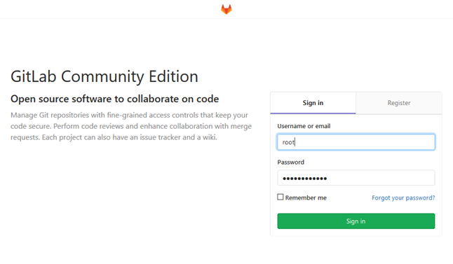

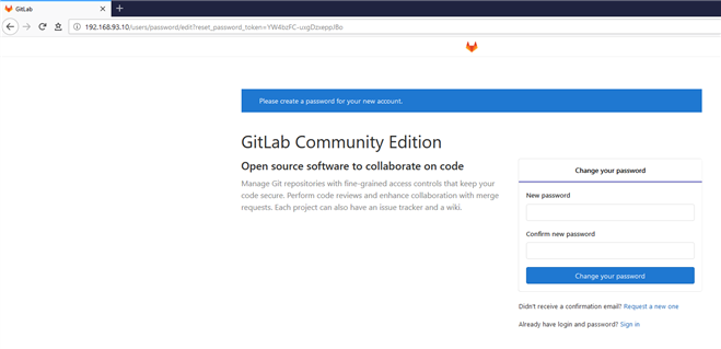

Either way, the server seems to be running. When I pointed my computer browser to Pi’s IP, it showed the default password reset dialog. The installation is complete!
After setting a new password, the login / registration page appears. I signed in with the root account and freshly reset password.

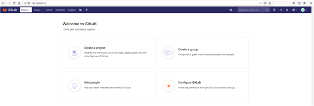

Here comes the default page for the administrator:
