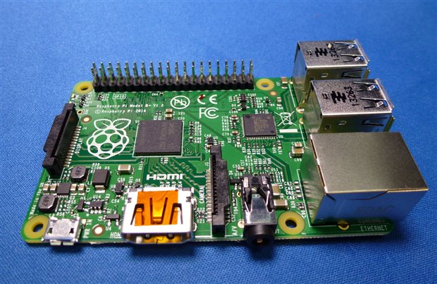

PI+  Full Frontal image

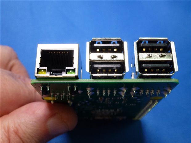

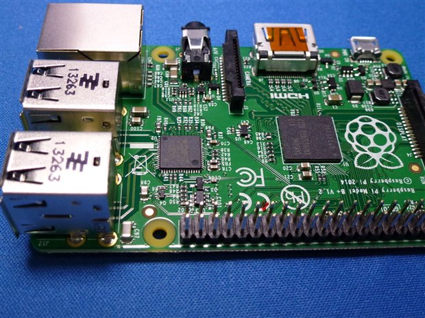

B+ Network (now with Blinkin' Lights) and the all important 4 USB ports
New 4 port USB Variant of the original 2 port device, Composite Phono has gone to be replaced with a 4 pole AV combo on the other side

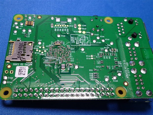

The Rear has been tided up and the full sized SDcard is replaced with a nice metal  micro SD push push device!

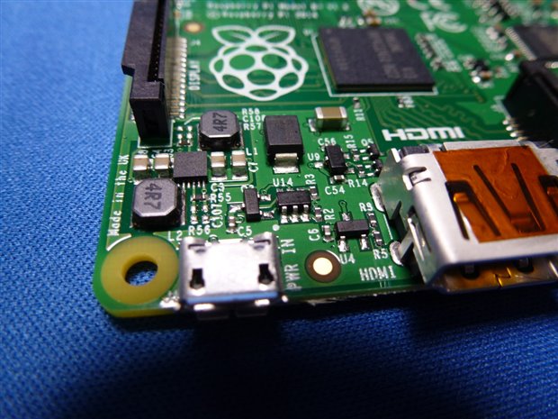

The Micro USB power connector is now on the same side as the HDMI and the Linear regulators replaced by this Switch mode.
Expect lower supply currents and hopefully reliability !!

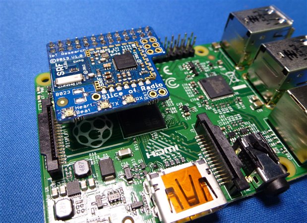

Small CISECO Radio board fits easily no problems

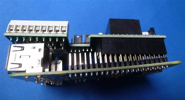

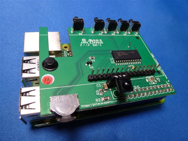

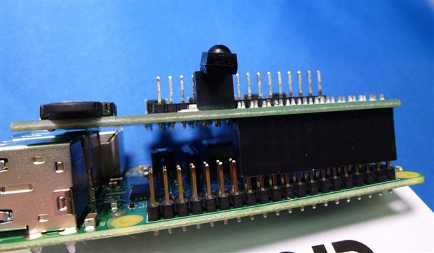

Unfortunately a no go with The PI Face Control and Display

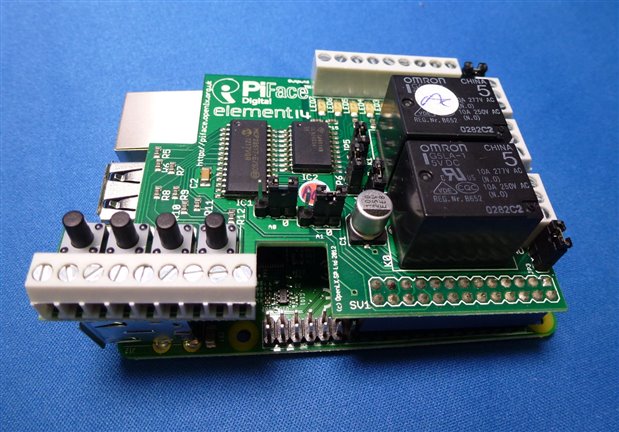

Same for the Pi Face Digital

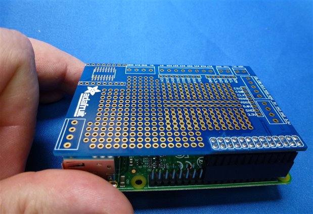

Adafruit's Prototyping board stands higher and thus is free of the board underneath and fits fine

Overall the physical layout changes are a great improvement  having connectors on only two sides will aid case designers and integrators alike. Large boards do foul the connectors some redesign is required for these (maybe a physical lift upwards??)
