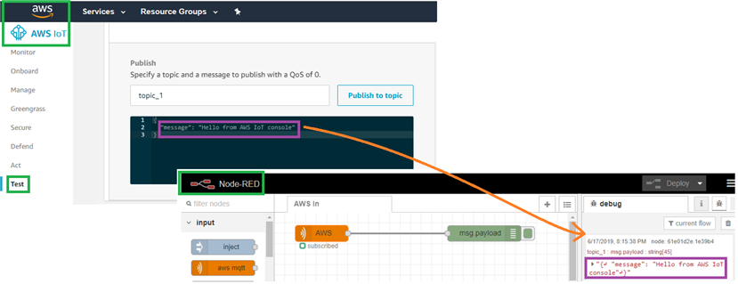

image: action capture of AWS IoT Core's MQTT Test page shooting a message to the Node-RED running on YOUR! Raspberry Pi

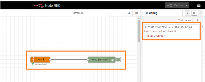

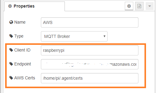

I'm again using the test flow from my Harting Mica blog. Only the certificate directory name, endpoint and client id are different:
After Deploying the flow, use the  IoT Core Test MQTT page to shoot a message to topic_1.
Yes. Success. Enjoy.

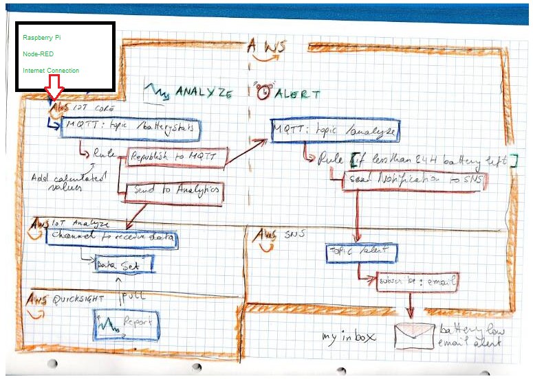

Need inspiration? To see what you can do with your (sensor?) data once it arrived at AWS, check: Manage Arduino MKR WIFI 1010 Battery Life in the Cloud - AWS, Graphs and Alerts.
