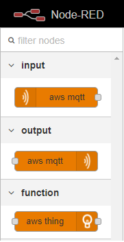

The Node-RED container installed on the Harting Mica is ready for AWS connections. It has three nodes that interact with Amazon:
The two first blocks interact with the AWS IoT Core MQTT service. They are very similar to the Node-RED MQTT blocks.
The input node subscribes to an MQTT topic, the output node publishes to a topic. These two nodes are covered in this blog post.
The third node, "aws thing" is a block that allows you to talk to an AWS thing shadow. This allows you to get / set status of a device even when it's offline. I'm not covering that block here.

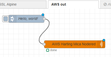

Open the Node-RED editor on your Mica, and create a new flow.
Place these 2 blocks and link them together:
  • an input inject node
  • an output aws mqtt node
Double-click on the inject node, and
  • set payload to {}JSON
    select the ... button to open the JSON editor and enter
        "name": "Hello, world!"
  • leave Topic empty
  • Set the Name to Hello, world!..
Confirm by clicking the Done button

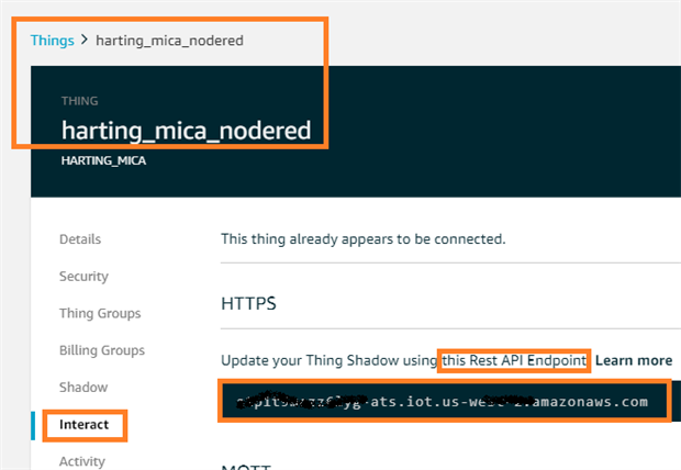

  • End point is your Thing's end point that you can find on IoT Core. Can be found by selecting your thing and clicking on Interact.

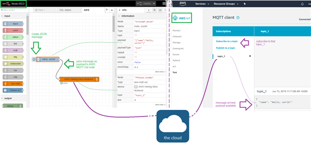

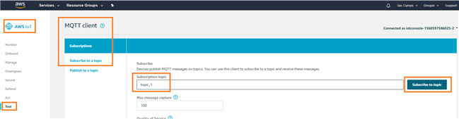

Don't deploy yet. First open IoT Core's MQTT test page.
Keep this window open. The message from the Mica will be shown here (if you have done everything right image ).

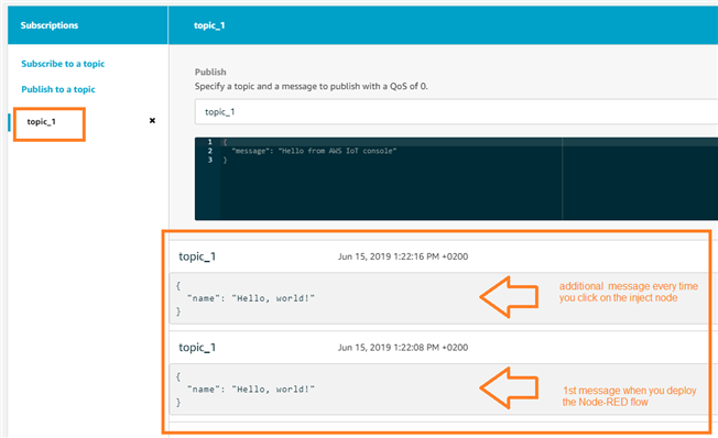

Then deploy your Node-RED flow. Check back on the IoT Core test page:
You did it! Click on the inject node, and the Node-RED flow will send another message.

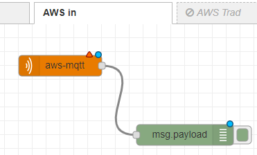

  • an input aws mqtt node
  • a debug node.
Double-click on the aws mqtt node, and
  • select the same Device you created in the outbound flow. We're using the same certificates and endpoint.
    You will be reusing this configuration each time you use an AWS node in your projects.
  • Set Topic to topic_2.
No need to configure the debug node.

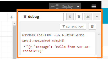

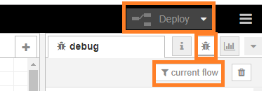

Deploy, then open the debug view:
The message coming from the IoT Cloud will be show in this debug window when we perform the next step.

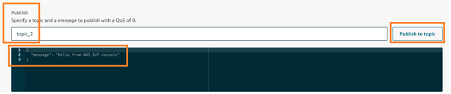

Go to that IoT Core's MQTT test page again. It should still be open from testing the outbound flow.
Enter topic_2, and press the Publish button:
Go back to your Node-RED flow and check the debug view:
Celebrate.

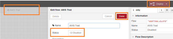

info: if you use the AWS Free Tier, I advice that you disable the Node-RED flows that use the AWS blocks.
You disable a flow by double-clicking on its tab, then set the status to Disabled.
Then click the Done button and - after you did this for all AWS related flows - click Deploy.
This will prevent that there's interaction between your Mica and AWS whenever the Mica is powered on.
