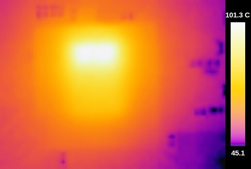

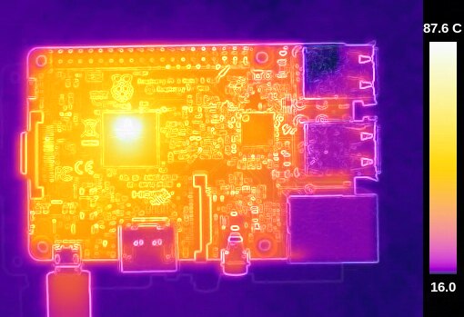

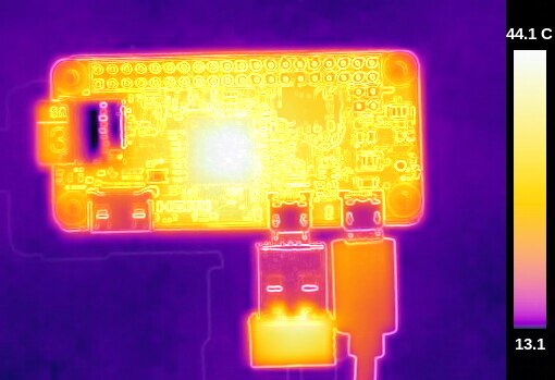

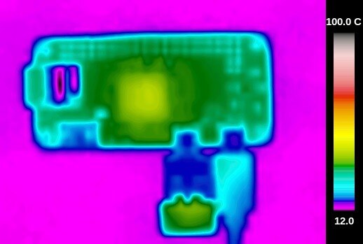

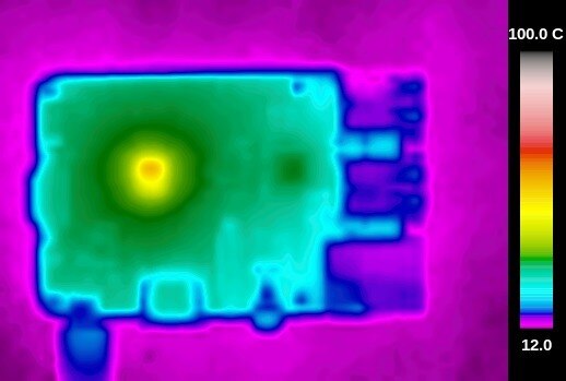

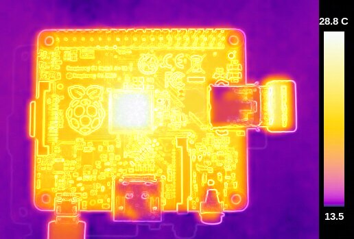

Thanks to Gareth Halfacree, whom took a series of photographs of the Raspberry Pi processor under heavy load, I think. Note there's no load on the GPU in these photographs. You can see how potentially hot each processor chip of the Raspberry Pi get. These are at stock processing speeds with no overclock and using sysbench to push the CPU.

Raspberry Pi 1 Model A+: 13.5degC to 28.8degC
Raspberry Pi Zero: 13.1degC to 44.1degC

Raspberry Pi 3 Model B: 16degC to 87.6degC
Raspberry Pi 3 Model B Close up: 45.1degC to 101.3degC

Raspberry Pi Zero: Normalised Temperature View

Raspberry Pi 2 Model B: Normalised Temperature View
Raspberry Pi 3 Model B: Normalised Temperature View

    DAB over 10 years ago
    That is some serious power emission.
    I would add a heat sink and a fan.  I would definitely not put it into one of those tiny RPi shells.
