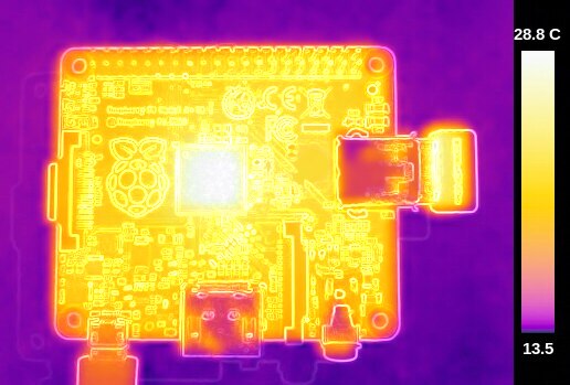

Thanks to Gareth Halfacree, whom took a series of photographs of the Raspberry Pi processor under heavy load, I think. Note there's no load on the GPU in these photographs. You can see how potentially hot each processor chip of the Raspberry Pi get. These are at stock processing speeds with no overclock and using sysbench to push the CPU.
element14 does sell Raspberry Pi HeatsinksRaspberry Pi Heatsinks
{gallery} Raspberry Pi Operating Temperatures Individual Scaling
Raspberry Pi 1 Model A+: 13.5degC to 28.8degC
Raspberry Pi Zero: 13.1degC to 44.1degC
Raspberry Pi 1 Model B+: 14.9degC to 32.5degC
Raspberry Pi 2 Model B: 12.4degC to 49.4degC
Raspberry Pi 3 Model B: 16degC to 87.6degC
Raspberry Pi 3 Model B Close up: 45.1degC to 101.3degC

    Hi Clem, It will be guesswork, because not all characteristics are know, but this online tool is useful: Calculating heat sinks Usually I plug in approximate values if they are not known (there are some…

    Christopher Stanton wrote: HAT add on boards will likely also be affected due to vertical clearance, or lack of. yes that's a problem, maybe something like this is better : MPC151525T - AMEC THERMASOL…
    shabaz over 10 years ago in reply to bwelsby +2
    That's actually really good. Those ceramic heatsinks are (literally) cool : ) I actually have one here for another project, but unfortunately 22x22mm : ( will see if it fits. ( MPC222225T - AMEC THERMASOL…

    Thanks for this,  I was just about to 3D print a slim case but now I think I will make room for a heatsink with good ventilation slots too image .

    What do you think about this:  BGA-STD-090 - ABL HEATSINKS - Heat Sink, For Ball Grid Array, Standard, BGA, 10 °C/W, 10 mm, 40 mm, 23.9 mm | Farnell el…
    It is larger than the BCM chip, and guesstimates suggest it might keep the junction temperature below 120 deg C for ambient of up to 40 deg C if around 4 watts is being dissipated there. This is for passive cooling, and this wouldn't require a fan unless higher ambient is expected.
    I liked that it is very cheap : ) and comes with the thermal tape. Should perform far better than the tiny heatsinks that come bundled with enclosures. Height is 10mm, I don't know if that breaks HATs from being usable or not.
    BUT, I don't know if it could clash with other components, since it is larger than the chip, and the BCM.. chip looks very low profile : ( Also I might not trust this unless I cover with additional tape the exposed part of the underside of the heatsink.

    Time for a heat sink. Did I read they throttle the processing of the SOC down when over 87 degree automatically?
