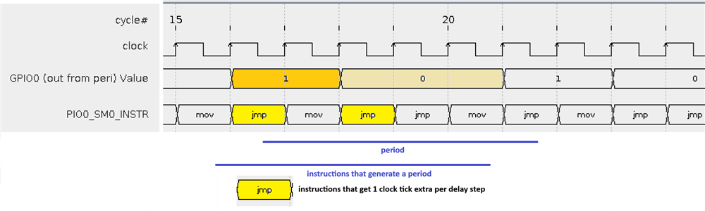

Understand the delay
In the PIO design, you can pass a delay to the PIO's isr register.
The design will then add delay * clock ticks to each halve period.
image: clock stretching mechanism explained
Without a clock divider, that adds 2 * 40 ns per count.
Let's say we set a delay of 5000 (and this delay is applied to both halves of the pulse).
period = 40 ns + 2 * 5000 ns = 10040 ns.
Step frequency is then approx 100 kHz. Although the resolution is fantasic - each delay step just adds 80 ns - the frequency is still way too high.
The delay is a 32 bit unsigned int, so you can really umph down the clock, with very precise resolution.
But for common designs, it's impractical.
Find a reasonable PIO clock and its minimum delay setting

    Jan Cumps over 1 year ago in reply to Jan Cumps
    (Hz)
    Jan Cumps over 1 year ago in reply to DAB
    > FYI, while you can drive the stepper motor at about 900 steps/seconds, you probably should not. They will overheat.
    Yes, But once I switch to micro-stepping, 900 MHz isn't outlandish anymore
