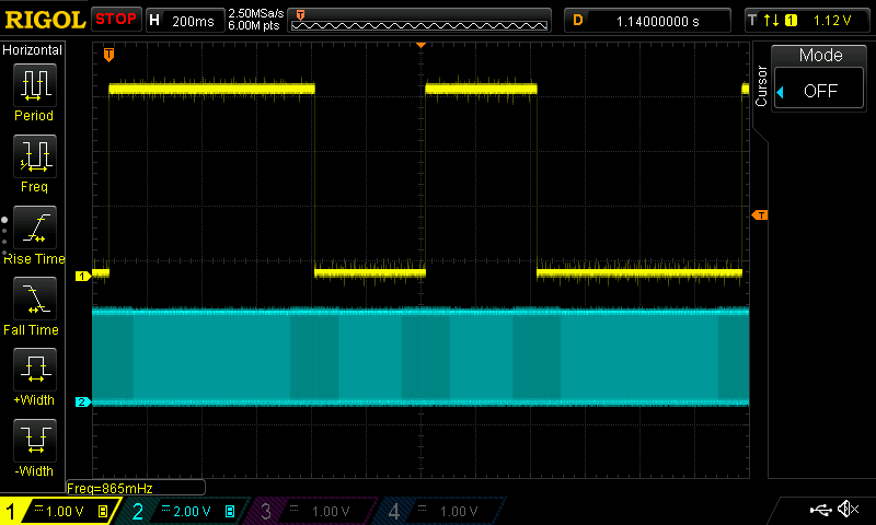

The oscilloscope capture of DIR (yellow) and STEP (blue) shows the behaviour at a direction change:
the black line before the last quarter of the image above is a 1ms pause I intentionally put there in my test code, to get a hint when a batch starts
zoom in to a direction change with slow-down before and after. The firmware defines how many steps both part of the ramp last.

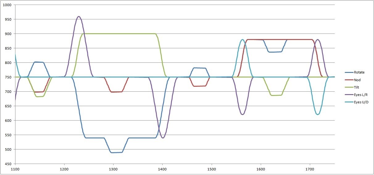

    Ramping is a great approach to moving steppers.  It also a useful approach of working with servos.  I have created some projects around using servos in animatronic devices.  Some of these devices have a significant amount of mass connected to them and benefit greatly from soft starting/stopping.  Here is a captured trace of some multiple axis movements that use ramping start/stops, with fixed rate movements to create smooth motions:
