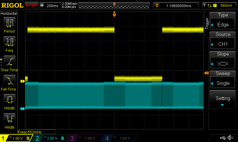

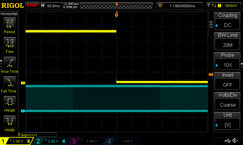

The oscilloscope capture of DIR (yellow) and STEP (blue) shows the behaviour at a direction change:
the black line before the last quarter of the image above is a 1ms pause I intentionally put there in my test code, to get a hint when a batch starts
zoom in to a direction change with slow-down before and after. The firmware defines how many steps both part of the ramp last.

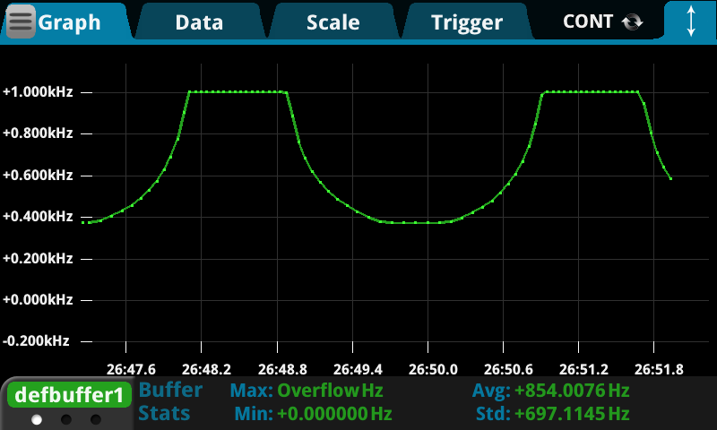

    First attempt for a more trapezoidal(ish) ramp: https://youtu.be/AyNQrvEplDw This (very early) attempt takes core (non-PIO) processor time. How do you ramp, as a library user? {{400 * microstep_x…
    Jan Cumps over 1 year ago in reply to Jan Cumps
            {{400 * microstep_x, true}, 7000, 2600},
            {{8000 * microstep_x, true}, 2600, 2600},
            {{400 * microstep_x, true}, 2600, 7000}
    You tell it the amount of steps, start delay and end delay.
    If start and end is the same, the library hands of everything to the PIO.
    If they are different, the core calculates the ramp delay (naive attempt Slight smile) after each step, then sets the next delay and takes the next step.
    It's a continuous ramp, but absolutely not linear / trapezoidal at this moment.
