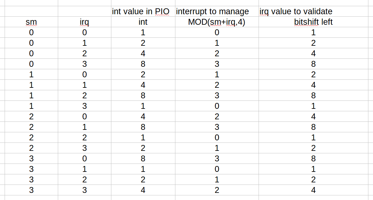

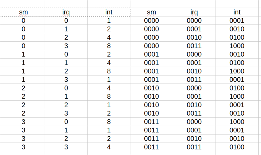

Dealing with PIO relative interrupts
Because the interrupt mechanism is somewhat confusing, I 've created helper functions that make me deal with that:
    // sm	irq	int	MOD SFT	sm	    irq	    int     MOD     SFT
    // 0	0	1	0	1	0000	0000	0001	0000	0001
    // 0	1	2	1	2	0000	0001	0010	0001	0010
    // 0	2	4	2	4	0000	0010	0100	0010	0100
    // 0	3	8	3	8	0000	0011	1000	0011	1000
    // 1	0	2	1	2	0001	0000	0010	0001	0010
    // 1	1	4	2	4	0001	0001	0100	0010	0100
    // 1	2	8	3	8	0001	0010	1000	0011	1000
    // 1	3	1	0	1	0001	0011	0001	0000	0001
    // 2	0	4	2	4	0010	0000	0100	0010	0100
    // 2	1	8	3	8	0010	0001	1000	0011	1000
    // 2	2	1	0	1	0010	0010	0001	0000	0001
    // 2	3	2	1	2	0010	0011	0010	0001	0010
    // 3	0	8	3	8	0011	0000	1000	0011	1000
    // 3	1	1	0	1	0011	0001	0001	0000	0001
    // 3	2	2	1	2	0011	0010	0010	0001	0010
    // 3	3	4	2	4	0011	0011	0100	0010	0100
// 10 (REL): the state machine ID (0…3) is added to the IRQ flag index, by way of
// modulo-4 addition on the two LSBs
inline uint relative_interrupt(const uint32_t ir, const uint sm) {
    uint32_t retval = ir & 0x03; // last 2 bits
    retval += sm; // add relative value (is sm)
    retval = retval % 4; // mod 4
    return retval;
inline pio_interrupt_source interrupt_source(const pio_interrupt_source is, const uint32_t ir) {
    return static_cast<pio_interrupt_source>(std::to_underlying(is) + ir);
uint sm_from_interrupt(const uint32_t irq_val, const uint32_t ir) {
    uint i;
    for (i = 0; i < 4; i++) {
        if (irq_val == 1 << relative_interrupt(ir, i)) {
            break;
    return i;

    got the riddle solved:
    1. the interrupt that I have to manage, in pio_set_irq0_source_enabled(), pio_interrupt_get() and pio_interrupt_clear(), is the MOD4 (sm+irq).
      for pio_set_irq0_source_enabled(), I have to add the base value of interrupt 0 to it, pis_interrupt0.
    2. for checking what state machine fired that interrupt, I have to check the bitshift left of MOD4 (sm+irq)
    This took some serious debugging to figure out.
    Jan Cumps over 1 year ago
    The explanation of relative IRQ is a bit fuzzy. I've created a table with what the PIO actually throws (int) when choosing state machine (sm) 0 - 3 and IRQ 0 - 3
    SDK:
