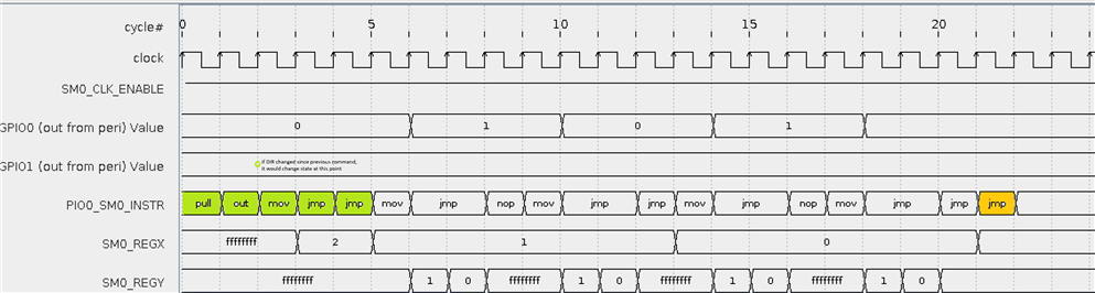

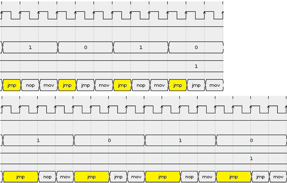

Here is how the pulse stretching works. The top trace is with no delay. Each half cycle takes 3 clock ticks. 6 clock ticks per full pulse period.
In the second trace, the delay was set to 1. The two half pulses now take an extra clock tick: 4 each, 8 ticks per full period. This effectively lowers the pulse train frequency, and thus slows the stepper motor down.
This is the tail of a command. The PIO has generated the amount of steps that were requested. X register has counted down to 0, and the flow stops, until a new command is sent by the ARM controller:
In later versions of this project I removed the nop instruction. It was there to have a nice symmetrical pulse train with 50% duty cycle.
But a stepper driver doesn't need that. It's removed, and that's one more code position that's available for other code in the same PIO.
In total, it now uses 11 lines (even if you use 4 motors on the same PIO). That leaves 21 instructions free for other designs.
The impact of removing this line is that a full pulse now takes 1 PIO clock tick less. But with typical delay settings in the mid to high 4000 range (and each delay eating 2 clock ticks), this is neglectable. In the end, we'll have 50.0xx% duty cycle instead of 50.00000%.
If you want exact 50%, you could add a delay of 1 to this line - making the amount of clock ticks for both halves of a pulse exactly the same:
mov y, isr side 1 [1]

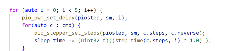

in main(), I  just added a loop to slow down from requested speed in 4 steps
   std::array<command, 6> cmd{{
        {200 * microstep_multiplier, true},
        {200 * microstep_multiplier, false},
        {400 * microstep_multiplier, false},
        {250 * microstep_multiplier, true},
        {350 * microstep_multiplier, true}}
    uint32_t sleep_time = 0U;
        wakeup_drv8711 w; // wake up the stepper driver
        sleep_ms(1); // see datasheet
        for (auto i = 0; i < 5; i++) {
            pio_pwm_set_delay(piostep, sm, i);
            for(auto c : cmd) {
                pio_stepper_set_steps(piostep, sm, c.steps, c.reverse);
                sleep_time += step_time(c.steps, i);
            sleep_ms(sleep_time + 500); // give enough time to complete the action
The granularity is still rough. With these slow signals (850 Hz as fastest that my motor can handle in full-step mode), each delay adds 2 extra ticks. One tick is added to each half of the pulse. It's a lot. Making it more granular is something for a next exercise ...
Here is a full sequence, where I set the direction to 1, 2 steps, and a delay of 1. First 5 instructions are fetching the command, dir and delay. Then it's a loop, executed twice.
The last instruction wraps up after we're done, and lets the state machine fetch the next command.

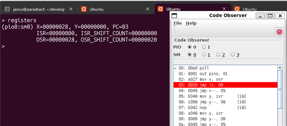

    Jan Cumps over 1 year ago in reply to Jan Cumps
    stepping through the code, and checking if scratch register X has the count of steps:

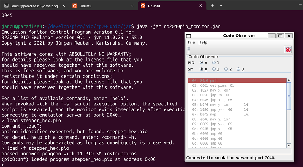

    It's not possible to debug a PIO, but there's a nice emulator: https://rp2040pio-docs.readthedocs.io/en/latest/index.html
    That one allows you to step and watch registers, FIFOs, and simulate in and out (either data or pins)
    Here, it's loaded with my stepper design, running on WSL ubuntu:
