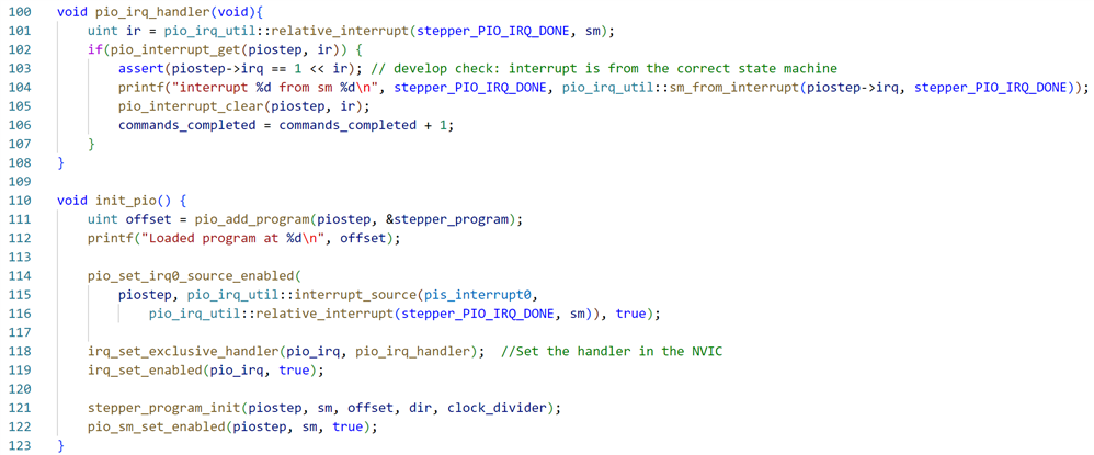

Create a handler, and register it
const auto piostep = pio1;
const uint pio_irq = PIO1_IRQ_0;
const uint sm = 0U;
volatile uint commands_completed = 0U;
void pio_irq_handler(void){
    uint ir = pio_irq_util::relative_interrupt(stepper_PIO_IRQ_DONE, sm);
    if(pio_interrupt_get(piostep, ir)) {
        assert(piostep->irq == 1 << ir); // develop check: interrupt is from the correct state machine
        printf("interrupt from sm %d\n", pio_irq_util::sm_from_interrupt(piostep->irq, stepper_PIO_IRQ_DONE));
        pio_interrupt_clear(piostep, ir);
        commands_completed = commands_completed + 1;
void init_pio() {
    uint offset = pio_add_program(piostep, &stepper_program);
    printf("Loaded program at %d\n", offset);
    pio_set_irq0_source_enabled(
        piostep, pio_irq_util::interrupt_source(pis_interrupt0,
            pio_irq_util::relative_interrupt(stepper_PIO_IRQ_DONE, sm)), true);
    irq_set_exclusive_handler(pio_irq, pio_irq_handler);  //Set the handler in the NVIC
    irq_set_enabled(pio_irq, true);
    stepper_program_init(piostep, sm, offset, dir, clock_divider);
    pio_sm_set_enabled(piostep, sm, true);
At this moment, we have the mechanism. Each time the PIO is finished rotating the stepper, the interrupt will increment commands_completed. We can use that in our logic:

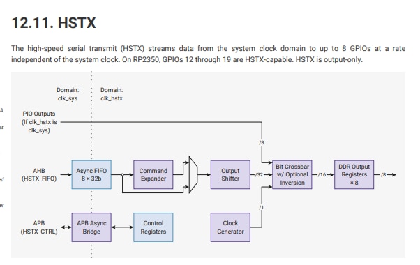

    scottiebabe over 1 year ago in reply to Jan Cumps
    That's fast! On the RP2350 the HSTX peripheral runs on a separate clock domain, so its possible to really push it.

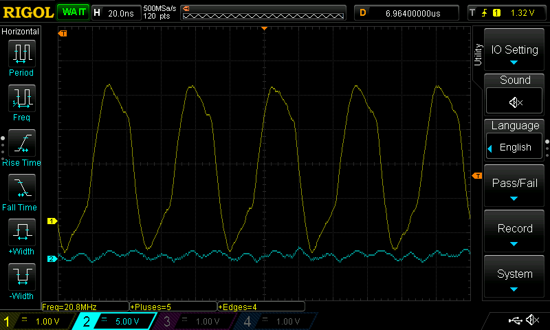

    Jan Cumps over 1 year ago
    Frequency of stepper motor pulses is 100s of Hz max, maybe a few kHz for a specialised  motor in micro-steps. I use a clock divider and a programmable delay to get the pulses to a manageable range.
    But if you wonder: what's the maximum pulse speed of this design on a Pico 1 (scottiebabe , not overclocked!)?
    20MHz - definitely fast enough for anything stepper related for the next decades.
