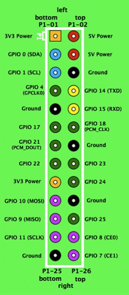

From the eLinux wiki, the GPIO header pinout show the I2C lines are on GPIO 0 (SDA) and GPIO 1 (SCL):

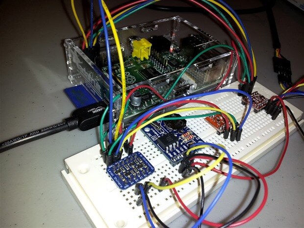

SDA is the Serial Data line, and SCL is the Serial Clock line.  Here is a photo of the RTC board connected via the logic level shifter to the Pi:
(From Left to Right: Adafruit 4-channel I2C-safe logic level converter, Adafruit DS1307 RTC board, Adafruit 8-channel logic level converter [unused], SparkFun logic level converter board [connected to FTDI cable for serial console])

3V3 Power
Red
LVHVRed5V*
GroundGreenGNDGNDBlackGND*
GPIO 0
(SDA)
YellowA3B3YellowSDA
GPIO 1
(SCL)
BlueA4B4BlueSCL
*NOTE: The 5V FTDI cable provides 5V power to the DS1307.  The DS1307 "5V" pin is connected to "VCC" on the 5V FTDI cable, and the DS1307 "GND" pin is connected to "GND" on the 5V FTDI cable.  Alternatively, the DS1307 could instead be powered by the 5V pin on the Pi's GPIO header.

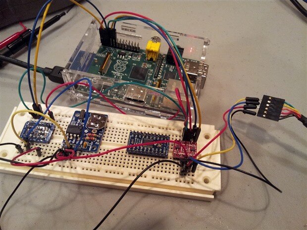

Here's a close up of the wiring:
(From Left to Right: Adafruit 4-channel I2C-safe logic level converter, Adafruit DS1307 RTC board, TMP102 temperature senor [more info in a future post], SparkFun logic level converter board [connected to FTDI cable for serial console])

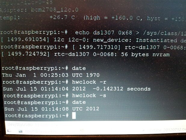

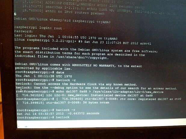

I'll now turn my attention to the software side now that the wiring is done.  bootc.net a terrific resource for I2C on Pi.  First, download the bootc.net Debian Wheezy image which includes v3.2 of the Linux kernel and I2C drviers.  Boot the Pi from that image and execute these simple commands from I2C and the Raspberry Pi (as root):
Register the DS1307 RTC chip with the I2C address of 0x68:
echo ds1307 0x68 > /sys/class/i2c-adapter/i2c-0/new_device
View the current date & time stored in the RTC:
hwclock -r
Set the Linux system time to the value in the RTC:
hwclock -s
Here's screenshots of the process:
These commands could be added to a startup script so that the Pi retrieves the current date/time from the RTC while booting up.
