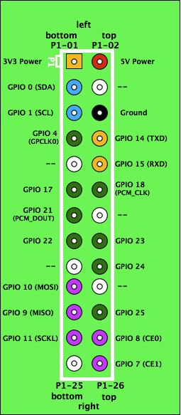

The serial console is a convenient way to interact with the Raspberry Pi when a display isn't handy.  From the pinout on the eLinux wiki, I can see that the serial port (aka UART) on the Pi is on GPIO Pin 14 (TX) and GPIO Pin 15 (RX):

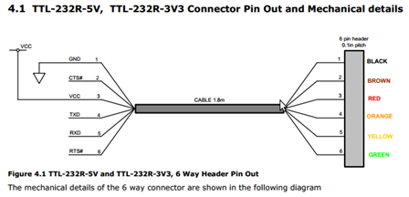

Here is the pinout for my TTL-232R-5V cable (datasheet):

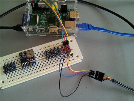

Here's how I wired it all up:
Raspberry Pi Pin
Jumper Wire
Logic Level Converter:
LV side (3.3V)
HV side (5V)
Jumper Wire
FTDI
cable
3V3 PowerRedLVHVRed
Red
(VCC)
GroundGreenGNDGNDGreen
Black
(GND)
TXD
(GPIO 14)
YellowTX1TX0Yellow
Yellow
(RXD)
RXD
(GPIO 15)
BlueRX0RX1Blue
Orange
(TXD)
Warning: make sure the Pi is turned off and FTDI cable unplugged from the PC before starting to wire up the above connections
Note: TXD (transmit) on the Pi needs to talk to RXD (receive) on FTDI cable, and TXD on the FTDI needs to talk to RXD on the Pi.  Otherwise, it would just be a straight-through connection, and communication wouldn't be possible.

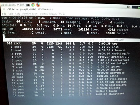

In gtkterm, I selected Configuration->Port and set the Port to /dev/ttyUSB0 and Baud to 115200.  The rest of the defaults are ok (8 bits, stopbits 1, flow control and parity: none).  After clicking OK, I pressed the Enter key a few times and the Pi prompted for username.  I was able to log in and then use the shell as I normally would.  Here is the utility top running:
