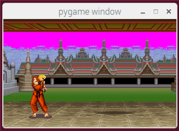

The 30-second video here shows the result of the few lines of code on the pi:

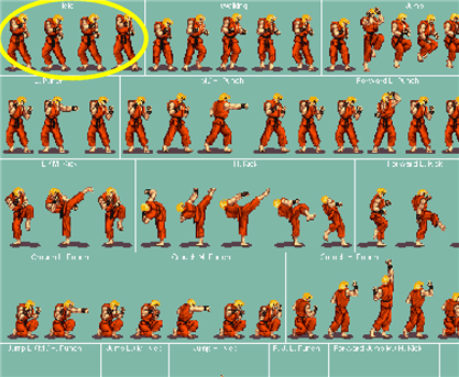

In the case of this project, the aim will be to animate a character from Street Fighter, Ken. From the website mentioned earlier, a .gif file was downloaded that contained all the animation steps that this character can take in the actual game. (Don’t download the image reproduced below, it is a low-res copy; use the one from the website link earlier). For this project, the four frames of animation that are circled in yellow are used; these represent the ‘idle’ movement of Ken, when he is ready to fight and he is just getting ready to kick or punch. In the video game, these four frames of animation are repeated while he waits to attack or to be attacked.

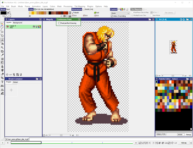

Some image manipulation software is needed to cut the larger image into the four desired frames which will become the sprite for Ken idling on the spot. Something like Microsoft Paint could be used, or some open source software. For those serious about creating games, a low-cost tool popular among 2D graphics artists is called Pro Motion by Jan Zimmermann.

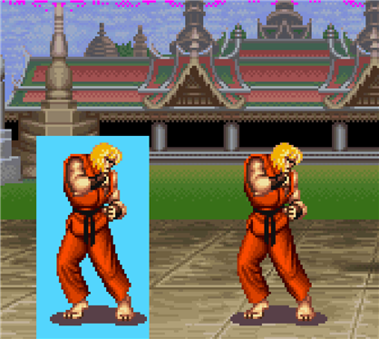

Sprites would be an ugly solution if they had to have a rectangular colored block (see the first Ken in the image below). Sprites are useful when they can be used in front of a background image as shown with the second Ken in the image below.
This trick is achieved by assigning one color in the image file to be a ‘transparent color’. Whenever the computer sees pixels in that color, it will skip it and thus the background will continue to be visible there. Not all image formats support the capability of containing a transparent color. If you’re saving sprites, use GIF or PNG format (I used .gif format for this project).

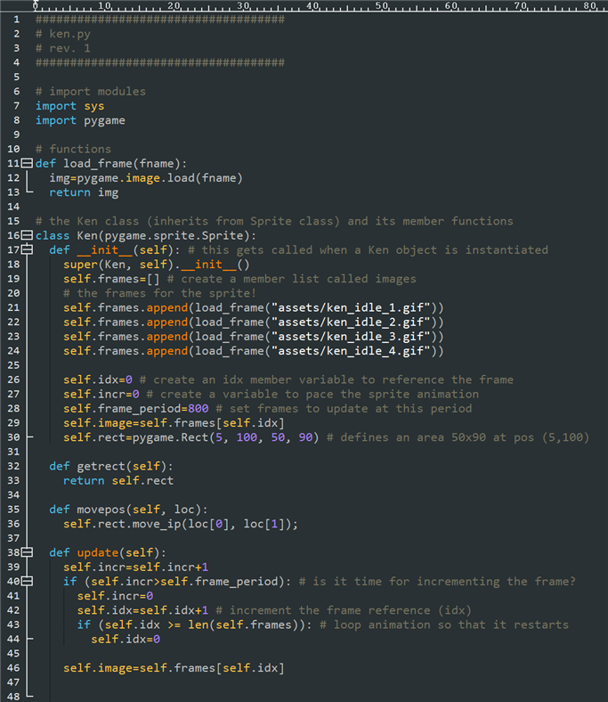

Here is the code for Ken, this is in the ken.py file:
If we try to examine it, we can see some generic stuff like comments and modules being imported, but then the interesting area would appear to be from line 16 onwards, where it says class Ken. From line 21 it can be seen that the animation frames are loaded from the .gif files in the assets folder. Further below (line 28) there is a value 800, and it is a value that determines how fast the animation is to occur. A large number slows down the animation. The following line after than has some numbers which are related to the sprite size, and the location where it is desired to place Ken. The .gif files are of size 50x90 pixels, and Ken is initially placed at co-ordinate (5,100). The co-ordinates are referenced from the top-left. The origin (0,0) is the top-left part of the screen, and the top-left of Ken’s sprite is placed close to the left side of the screen, and 100 pixels down. In other words, he will be placed in his corner of the fighting area.
There are several lines of code that begin with the text def. These are functions. For example, there is a function called getrect on line 32. It allows anyone calling that function to retrieve the rectangle information (the location on the screen where the sprite is to be placed, and the width and height of the sprite).
The word self is used a lot too. This is because Ken is not a person yet. In the ken.py file Ken is a class or a description of a potential object that could be created, meaning that in theory we can create as many Kens as we wish from it, although we will only create one. Each Ken could have its own position on the screen, and self refers to the reference of any real Ken that is created (it all makes more sense as you see where Ken is instantiated later).
To use this code, somewhere you’d type something like
real_ken=Ken()
Until that is executed, real Ken doesn’t exist in computer memory. The computer knows how Ken should look like from the class, and how he should move when he is idling on the spot, but no memory has been used to create a real Ken and store his location. If you wanted to create another Ken, then you could type:
another_ken=Ken()
With the current code it would mean that the second Ken would be initially placed in the same location, so you’d then have to move him.

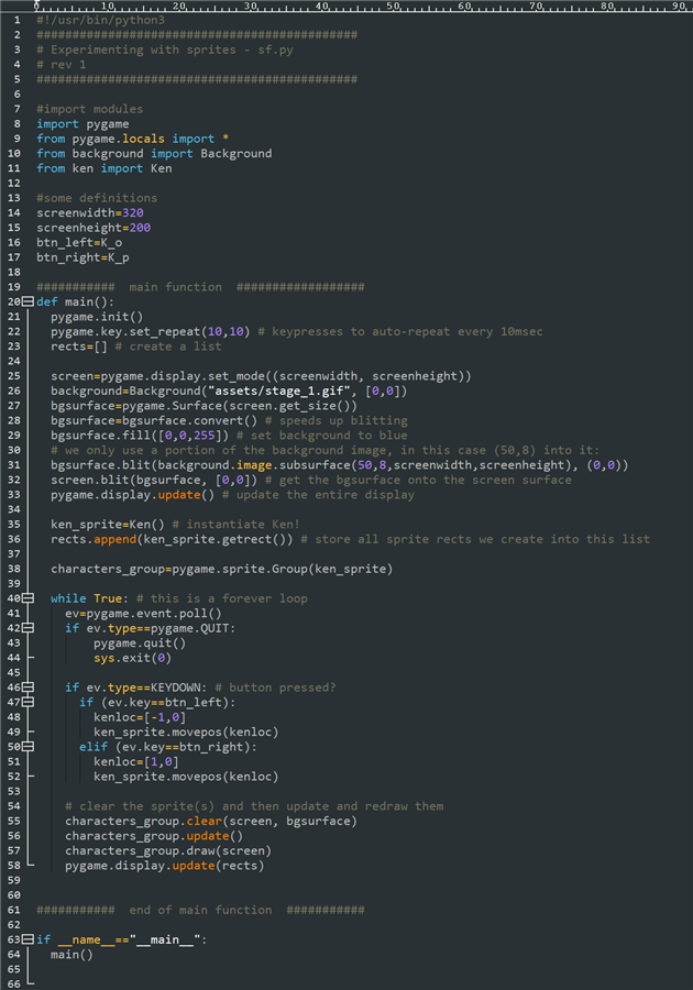

For this project, the main file was called sf.py and the contents are shown here:
If we examine it, one interesting thing is that the very first line looks unusual. The hash and exclamation point (#!) are a special combination that the operating system (e.g. Linux in the case of the Pi – for more information, see some of the earlier Get Started Coding blog posts) can recognize and make life easier for program execution. The first line in this manner is used to specify what program can run the code. In this case, since we’re using the Python programming language, the first line can be used to specify this. To run the code the user can just type
./sf.py
The operating system will automatically examine the first line, and know that the rest of the code will be executed by the software called /usr/bin/python3.
Line 11 shows how the main code can know about the additional files of code. It specifies that the file called ken (the suffix is implied to be .py) contains a class called Ken (for the same of convention, the class names will begin with an uppercase character).
Incidentally the line just above that (line 10) specifies that there is another file called background.py. This file contains a class called Background that will be responsible for creating the (you've guessed it) background. It is not an interesting file, the code is just a few lines and is not shown in this blog post but is of course in the code bundle downloadable for this project and can be viewed if desired.
From line 20 onwards the main function is defined. Line 21 initializes a body of code (also known as a library) called pygame. This library contains many helper functions to place sprites on the screen and all game-related tasks.
Lines 25 to 32 are responsible for drawing the stage background for the game. It uses a graphics file called stage_1.gif for that. Were the fighters to play an additional scene, then a stage_2.gif would also be needed.
Some more terminology is used in this part of the code that might not make immediate sense, but is related to the games engine (pygame) and to the computer graphics world. The term surface for pygame refers basically to images. It is possible to create a surface variable or object, and place an image (e.g. from a .gif file) on it, and then place it on the screen surface. You could create several surfaces in memory, and choose which one to copy onto the screen surface. The act of copying a surface onto another is called blitting in the games graphics world. In our case we are copying the image identically, but sometimes blitting is done in a way that if there is already something on the target surface, the colour of the source can change or invert. A good example of this is a cursor. Although the cursor is usually white, if the surface is already white then you want the cursor to be black otherwise you’d never see the cursor. If the surface is half white and half (say) red, then you might want the cursor (if it is blitted onto that surface at a position on top of these colors) to be partially black, and (say) partially yellow for good contrast against the red.
The heart of the game control begins from line 40. This a loop that checks to see what button is pressed (the variables btn_left and btn_right on lines 47 and 50 were defined on lines 16 and 17  to be keyboard buttons O and P and are used to move Ken left and right), and redraw Ken. The update function on line 58 is in the ken.py file of course, and it animates the next frame every 800 cycles (if you recall, this was defined in ken.py in line 28).
When a button is pressed, the position of the rectangle for the sprite is adjusted by 1 pixel by calling a function for Ken called movepos (line 49 and 52 of sf.py); the function is in ken.py on line 35. When the sprite is next redrawn, it uses the updated rectangle position.
If you’ve played Street Fighter then you’ll notice that Ken has a walk when he moves. This would be a different animation to the ‘idle’ animation. It is an exercise for the reader to implement this. To achieve it, one way would be to load more than 4 frames of animation in the code in ken.py, and then manipulate the idx variable in such a way that only the frames relevant for ‘idle’ are played out repeatedly when he is idling, and then change the value of idx to be a higher value in the range of the ‘walk’ frames of animation when the left/right keyboard button is pressed.

With not much code it is possible to achieve animation very close to the original arcade game, for the character Ken in his idle ‘pre-fight’ position, and accept keyboard input to make the character move.
