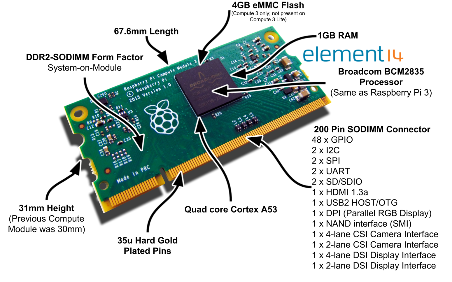

The Raspberry Pi Compute Module 3 & Compute Module 3 Lite
The original Compute module was built around the BCM2835 processor, which was also found on the RPi B+. Although the Raspberry Pi SBC has seen a couple of iterations since then, this is the first update to the Compute platform that's been released (nope, there's no Compute Module 2 -- you didn't miss something!).
It contains the BCM2837 process, the same as the Raspberry Pi 3, and its RAM has been doubled to 1GB. The Compute Module 3, just like its predecessor, has 4GB of eMMC flash memory in lieu of needing an SD card for the OS and storage. Though if you're wanting to slim things down, the Compute Module 3 Lite dispenses with the eMMC flash memory, and exposes the pins via the edge connector instead.

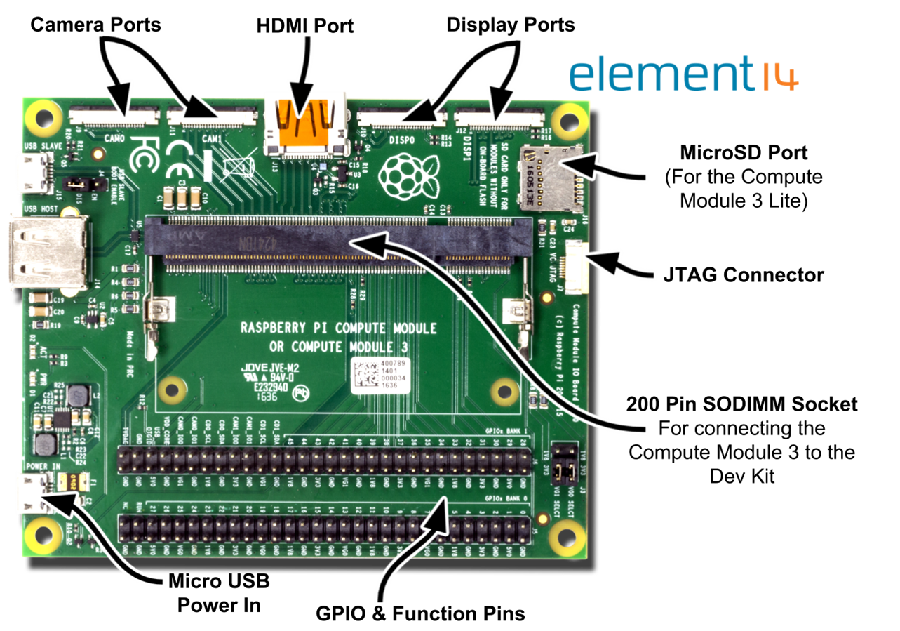

Raspberry Pi Compute Module 3 Development Kit
As with the original Compute Module, there's an IO breakout board available that's very similar to its older brother. One of the primary purposes of the Compute Module itself is for prototyping, and this board allows you to prepare your Compute Module 3 for that function.
It offers easy pin access to all those many, many, lovely GPIOs, and now includes a microSD port for the Compute Module 3 Lite (on account of it not having the built-in eMMC flash memory).

    Just received my Compute Module 3 DEV kit, yesterday from MCMElectronics. I was having issue finding new release of Raspian-Jessie that would fit on 4gb emmc....I decided to setup CM3L with 32gb SD with Full version of Jessie with Pixel 1-11-17. After updates are done, I'll retry to load Jessie-Lite onto the emmc. As with all my projects, I want to build this into a Robot. Wished it had a larger emmc....or at least wifi on the DEV IO board
