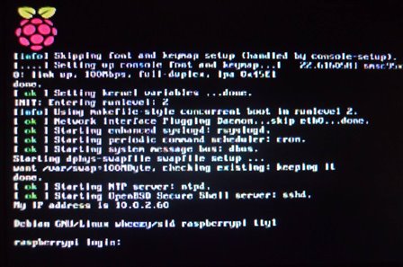

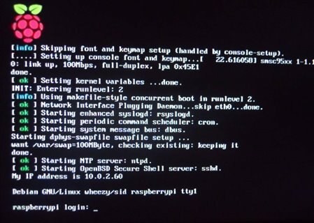

    I tested the Rpi with a 7" TFT LCD TV/Monitor, I didn't find the way to tweak the NTSC signal, I'd agree that the TV/Monitor is not a great thing, but the text from the Rpi is practically unreadable.
    A Picture is worth a thousand words ...
    Is two, two thousand ? Next picture is from a 21" HD Monitor via the composite video input
    I've to admit that I'm not using a high quality video cable, and there is some noise on the signal, there is flickering on the colors and text looks like if the pixel clock had a lot of jitter.

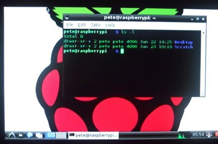

    OK, lets make it three thousand then ... after startx
    Not bad, but with the noise moving the pixels and flickering on the colors, you may be able to survive in text mode but for graphic mode I think the best way is to go with the HDMI interface.
    Signal quality will probably be better with a better cable (I'm using a standard 3xRCA AV cable).
