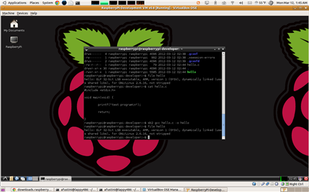

4) I happily clicked the Start button and the VM booted.  It is an Ubuntu system running LXDE.  To do a quick test of the cross-compliation, I typed up a quick C program and compiled it for the ARM target:
And that's all I've done so far.  I'm thankful that Russell put in the hard work to make it easier for everyone else.  He mentioned that he will release updates as just tarballs, so folks will be spared having to do the massive download again.  I'm very curious to see if some clever people get emulation working in the VM, so that the executables could be tested out.  I also think this VM could be useful once I eventually get a Pi and want to take advantage of my laptop's Intel horsepower to compile additional software I may need.
