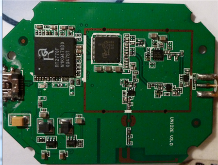

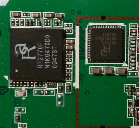

    Hello Everyone,
    I have not got this (http://www.jaycar.com.au/productView.asp?ID=YN8306) Wireless card to work yet.  But I have opened up the device and taken these pics:
    From these images, (I think) The wireless model is the RT2770F.  Can someoneconfirm this please?  If so, Then I have the wrong drivers on the RPi (RT2870) so this could be an easy fix.

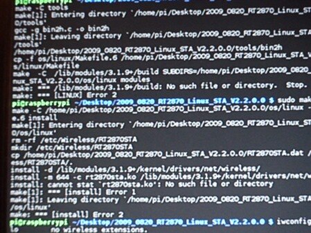

    Did a bit of research and found out that the RT2770F uses the same drivers as RT2780.  Also, I read the website that was posted by Neill but the RPi did not want to install firmware-b43-installer. image
    But,  From that website I think I discovered how to (attempt to) install the drivers that came with the device.  When I tried:
    The following error messages came-up:
    Can anyone shed-some-light on what is wrong?  Why can't I just use the supplied drivers?  Why won't firmware-b43 install?

    Can someone please see what is wrong with the .tar.bz2 file that came with the device (and gave the above failures).  Can someone play around with these files and see if you can find the problem. I can not post the files here but you can download them from: here or here .
  • wallarug
    wallarug over 14 years ago in reply to wallarug
    I am reading the Makefile and the readme file that came with the device.  Can someone please explain what I have to do? (based on what the readme file is telling me.)

    I don't understand the step that says: " define the linux kernel source include file path LINUX_SRC" .
    Can someone help me please?
