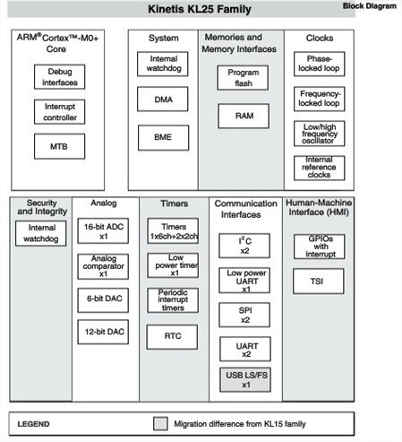

Well, this area is about to be given an interesting shakeup, courtesy of yet another ARM licensee, Freescale.  Their Kinetis KL25Z Freedom Board is now on pre-order at Element 14:
  • http://www.element14.com/community/community/knode/dev_platforms_kits/element14_dev_kits/kinetis_kl2_freedom_board
  • http://uk.farnell.com/freescale-semiconductor/kl25z128vlk/board-kinetis-l-series-kl25z/dp/2115294?COM=freedompage_knode ,
and you really can't go wrong at its board price of £8.10 + Arduino header form factor . image
Admittedly the Kinetis KL25Z's KL2 microcontroller is a Cortex-M0 which is the little brother of the Cortex-M3, but for hardware interfacing that will often be more than ample and is still a huge step up from the 8-bit AVR.  What's more, it's highly likely to undercut the price of Arduino's about-to-be-released Arduino Due, so things may get quite interesting in this market niche.
[Added note:  the Kinetis KL25Z board uses  uses a Cortex-M0+, not M0  -- see post 16, http://www.element14.com/community/message/54650#54650 ]
For expanding the Pi (and the BeagleBone too) into the Arduino niche, the Kinetis KL25Z looks extremely good to me. Admittedly, it won't provide anything like the power of an STM32F4-Discovery board which uses a Cortex-M4  http://uk.farnell.com/stmicroelectronics/stm32f4discovery/board-eval-stm32f4-discovery/dp/2009276?Ntt=STM32F4-Discovery , and at £9.96 from Farnell this Discovery is the very clear price-performance leader.  However, the Kinetis KL25Z has the Arduino form factor, and that may make all the difference.  YMMV !!
Very interesting times ahead! image

    Freescale KL25Z freedom board embeds a Kinetis KL25 32-bit MCU based on the new ARM Cortex-M0+ core.
    Based on ARM informations, Cortex-M0+ should be more energy efficient (MIPS/mA), fastest I/O and peripheral access and extended system-level capabilities compared to previous Cortex-M0 core version.
    Of course each solution has its own strenghs ...
    Freescale Freedom board includes an additional component (from Kinetis-K family) to manage the debug and the programming of the KL25 M0+ MCU.
    Which means that no additionnal hardware tool is needed to evaluate and develop on this board and makes the price really competitive for a complete hardware development tool solution.
    Additional comment concerning embedded debugger as it is based on the OpenSDA new standard supporting SWD and JTAG interfaces, in addition debugger also includes a mass-storage bootloader, so users can just copy-paste precompile hex files demo examples from their explorer and reset the board to program the KL25 without any software set-up is required.
    Board is compatible with Arduino shields and KL25 is also open to classical ARM Ecosystem (IDE and Firmware Sofware suppliers)
    In addition, Freescale offer for FREE its own IDE CodeWarrior (with code-size limitations up to 128KB) , Processor Expert to automate initialization and low-level peripheral driver source code generation and MQX-Lite (RTOS and Stacks).
