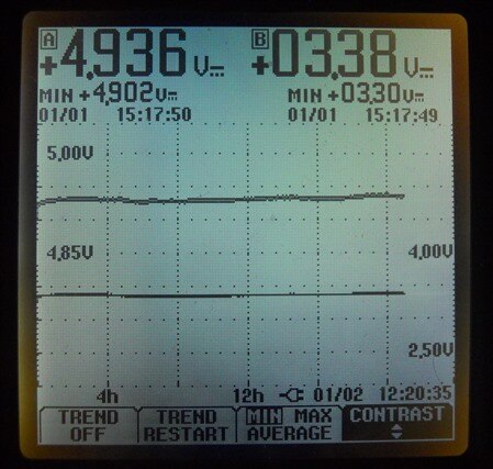

I think I found another problem I didn't notice before.
I have the R-pi hooked up in the prototyping gig I described on another thread (http://www.element14.com/community/thread/18981?tstart=0),
currently no keyboard, HDMI monitor, just network and access to console via the serial port.
I've been running a trend plot monitoring the +5V feed to the R-pi and the output of the 3.3V on board regulator. I noticed that gradually
the voltage out of the regulator has increased from 3.30V to almost 3.39V, it is actually not doing much, just responding to ping packtes
(flood mode) I'm sending from another machine and serving the serial console I use once in a while to run procinfo and network stats.

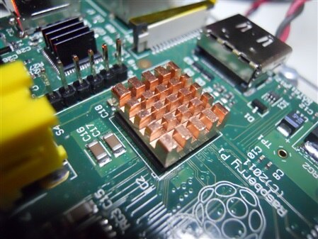

I guess the voltage increase is probably not noticeable when there is more load and current draw, the only thing I can think of is self
heating of the LDO. I just placed one of the little heatsinks I've got for the LAN9512 on the LDO and seems that output voltage is starting
to slowly drop. I'll keep this configuration to see if with the heatsink the voltage keeps droping.

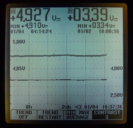

    Still can't explain it but something is going on, over a period of 40 hours the output of RG2 has been increasing from 3.34V to 3.39V,
    temperature shows now 44.2C and trending up. This is without the heatsink.
    I'm tempted to replace the part and see what happens.
    -J

    You have looked for instability (HF oscillations) with your scope? These issues can be down to (input /) output capacitors. Maybe reflow the solder on these components as well as the regulator. Looking at the trace your 5V line seems to be trending upwards as well?
    I assume that you have double checked your readings against another measuring device? Or against another piece of kit with a similar regulator. Its just that the 3.34V start value is out of spec to start with.
    For the cost of these things if you are comfortable doing the job then what's to lose. Looks as though its easy to get at as well.

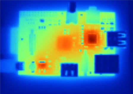

    This thermal image taken by "Remy" from Spain shows really where the heat is, if you follow the orange haze you can see how heat is being conducted by the board and not just staying around the hot components.
    I wonder how many Raspberry Pi's will get "cooked" when people start to put them in cases.

    Interesting image, where was that posted?  Any more info, like the temperature of the LAN9512 at the time?
  • jamodio
    jamodio over 13 years ago in reply to morgaine
    The original post is in spanish. Here is the link ...
    http://www.geektopia.es/es/technology/2012/06/22/articulos/se-calienta-el-ordenador-raspberry-pi-estudio-de-sus-temperaturas-en-funcionamiento.html
    -J

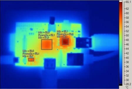

    That's a really good series of tests made by Remy, and I'll paste one of the images from the article here because it includes the temperature scale on its right-hand side:
    This is Remy's thermal image captured with a Fluke Ti35 during H.264 video and AC3 audio playback at 1080p and with Ethernet connected, which yielded the highest temperature recorded, peaking at 65.1C.  It's the first numeric evidence I've seen of the blisteringly high temperature that I've noted (but not measured) on my LAN9512 device.
    It would be very interesting to get Foundation engineers' comments on these figures, as so far I think Gert has only commented on subjective observations of "very hot" or finger tests.  Is anyone here not banned yet, and dares post Remy's temperature-labelled image in a hardware thread over there?
