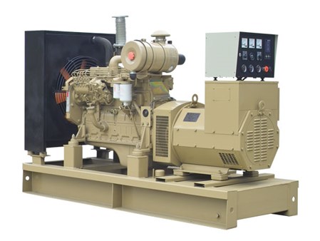

  • jamodio
    jamodio over 14 years ago
    After testing many of the cheap-o USB got tired and got one of this to power the Pi
    Still trying to figure how to solder the 10mm thick cables onto the micro USB connector .... No USB power limitations for me !!!
    -J
  • SFCAirborne
    SFCAirborne over 14 years ago
    LOL what is that 10 or 20KW, That's enoungh to power everyones Pi.
