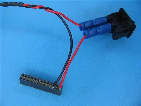

Hi all,
I've recently received my Raspberry PI B type board and I'm starting working on it.
Since I'd like to use it in some embedded application I'm wandering if it is possible to power it through a different connector than the micro USB one.
Is the 5V present on GPIO connector usable to power the unit?
I tried to have a look at the schematics but, unfortunatelly, the supplied link does not work.
Thank you in advance
Bye
Maurizio
  • morgaine
    morgaine over 14 years ago
    You're in luck, Maurizio.  The Pi can be powered through pins 2 and 4 on the P1 header, and this provides better voltage regulation than powering through the micro-USB socket with its F3 polyfuse.  Be careful though, since it's so easy to damage the hardware by accidentally touching adjacent 3.3V pins.

    2 & 4 are both 5v currently, but only 2 is officially documented (if you can find Eben's blog post and even that changed a couple of days later), GND goes to pin 6.
    I'm using these SSW-115-01-T-DSSW-115-01-T-D with various things soldered on to make it less likely to short flying leads to some other pin.
    Something like MULTICOMP - 2226A-03 - CRIMP HOUSING, 1 ROW, 3 WAY MULTICOMP - 2226A-03 - CRIMP HOUSING, 1 ROW, 3 WAY is also suitable, problem is the required crimp tool costs more than the Pi !

    Example of how I get power into a Pi

    e14 Contributor over 14 years ago in reply to maudil
    Just for your info... I notice the folks who've already sent a pi to 'space' (40km in weather ballon) had robustly soldered wires going into TP1 and TP2.
    http://www.daveakerman.com/?p=592
    "....  I used special thermal adhesive to glue heatsinks to the USB/ETH chip and to the 3.3V regulator. Both get warm but not hot normally, and I feared that at 1% atmosphere (so less convection) they’d possibly get too hot. You can also see 2 wires carrying 5V directly to the Pi – soldered joints are more reliable than using a connector."
