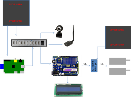

    Ok, here is my idea:
    Using some of the set-up features that @aonsquared used with his Robot/Rover thing.
    Using a 5 volt supply to power the Raspberry Pi and the Powered hub.
    The Raspberry Pi will send commands to the Ardunio Eleven (which I still have to get), which will control the Two Motors through a H-bridge and PWM.
    That camera will be powered through the 10 port hub, along with the Ardunio and the W/LAN dongle.
    The Motors will be powered though a 12 volt supply (8 AA batteries).
    All the commands will be sent through an Ad-Hoc Network to a Laptop running Windows 7 Pro 64 bit.  I think that I will use by Joystick to move the Motors but I don't know how that is going to work as @aonsquared used a PS3 controller instead. (Saitek ST90 is the Joystick).
    The LCD display will have the IP address so that I know exactly what it is whenever.
    The Raspberry Pi will host a live webcam feed though an old Logitec Camera I have lying around.
    One question is: Will PWM work on the motors through the Ardunio if I have the 12 volts going directly into the H-bridge Chip?
    What do you think?

    yvanttt over 13 years ago
    Yes it can be done.
    Look at this chip the L298, it can accept input voltage for the motor up to 46 volts. The logic side is at 5 votls so it is safe for your Arduino.
    You can drive up to 2 amps per output.
    This chips can 2 motors or you can connect the outputs in parallel to double the current.
    The datasheet even has some  circuits examples to try.
    http://www.datasheetcatalog.org/datasheet2/2/052daje928cw7pc0uqs1ipyryppy.pdf
