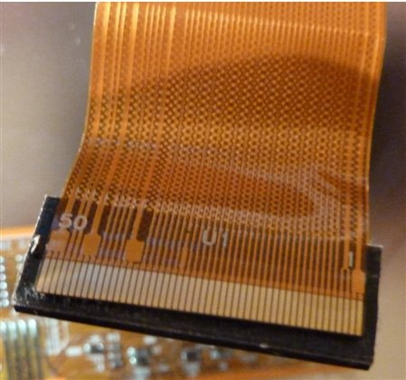

I took apart a TomTom GPS the other day and stole the 4 Inch Display out of it along with a GPS module and SD card reader.
Specs of Dispaly:
     Touch Screen
     480x272 resolution

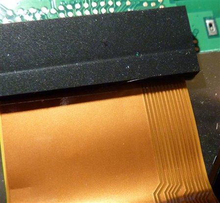

      50 pin connector (see below)
Can someone help me find a way that I can use this with my Raspberry Pi?  If someone could please find a datasheet first, that would be much appreciated.

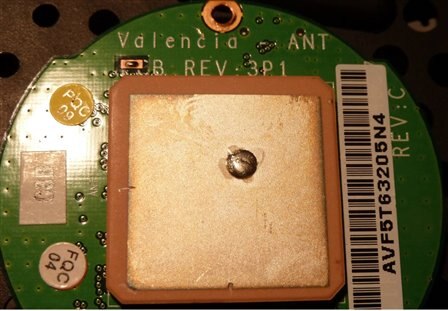

Specs of GPS module are not know except for the NAME: Valencia ANT PCB REV:3P1 (see below)

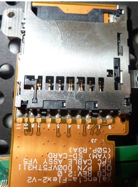

Specs of SD card Reader - only pictures. (see below)
Connector:
Reader:
I don't know if any of the above could be used / is useful with the Raspberry Pi but I thought I would see what people thought.

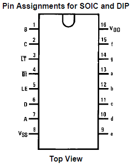

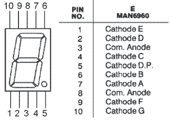

    Adding to the list of Devices that I can't use is an IC 7 Segment display Decoder (http://www.jaycar.com.au/products_uploaded/ZC4511.pdf).  I can wire the corresponding letters to the corresponding segments but I don't understand what some of the pins are:
    1. LE
    2. LT
    3. BT
    On the Display itself, it has a pin marked Dp which I guess is the backlight.  Where does this go on the IC?
    And it is a Common Cathode Display (I checked).
    Thanks in advance.

    The CD4511 data sheet describes ~LT, ~Bl, and LE in text and in the truth table.  ~LT is "Lamp Test" and when low turns on all segments.  ~LT has priority over all other inputs.  ~Bl is "Blanking" and when low turns all segments off, assuming ~LT is high = inactive.  ~Bl is used to blank the display to save power or can control brightness using pulse width modulation, i.e., with a variable duty cycle.  It has priority over LE.  LE is "Latch Enable" and when high stores the DCBA input that was present when LE rose from 0 to 1.  If LE = 0, the latch is transparent and segments a-g follow DCBA.  If LE = 1, the CD4511 ignores the DCBA inputs and displays the stored DCBA value.  LE is useful if you want to drive multiple digits from RasPi's limited GPIO signals since you can share the DCBA signals and provide a separate LE for each digit.
    CD4511 a-g outputs are active high and need to be used with a common cathode LED array.
    The decimal point DP is not controlled by the CD4511 and if used must be driven with other circuits.

    The CD4511 (according to your link to Fairchild Semi data sheet) is a CMOS part with CMOS input voltages.  VSS is ground.  VDD is the supply, which can be anywhere from 3V to 15V.  In your case you probably want to use +3.3V for VDD.  The reason is that CMOS input voltage thresholds for logic 1 (high) and logic 0 (low) vary with the supply voltage, i.e., anything below 30% of VDD is logic 0 and anything above 70% of VDD is logic 1.  Input voltages in the middle are not valid and may cause the CMOS part to use excessive power.  While you can drive a 5V CMOS input from RasPi's 3.3V GPIO outputs without damaging anything, it's not a good idea because 70% of 5.0V is 3.5V so the highest voltage RasPi can produce is not a valid logic 1.
    Another thing with CMOS inputs is that you must connect them to a valid logic 1 or 0 -- do not leave them floating.  In your case, pull up the ~LT and ~Bl signals with a 4.7K or 10K Ohm resistor (safest), or tie them directly to VDD (should work, but I prefer the resistor).
    If you only want to drive a single digit, tie LE to 0 = GND.  This will cause segments a-g to follow BCD code DCBA continuously.  Just drive DCBA with your RasPi and the CD4511 will happily display the digit.
    If you want to drive multiple digits, tie each digit's LE to a RasPi GPIO and tie all the DCBA signals together.  Then have your software set DCBA to the value for a digit and toggle its LE from low to high to update one digit at a time.
    RasPi's 3.3V GPIO pin is limited to 50 mA.  This is enough to drive 16 LED segments if each is 3 mA.  The CD4511 itself uses far less than 1 mA.  If you want more segments or have higher currents, you'll need to add a separate voltage regulator to generate VDD from 5V.  A quick-and-dirty one is to use a silicon diode plus a pull-down resistor (1K is good), which will drop 0.6 to 0.7V resulting in VDD = 4.3 to 4.4V.  This will give you a CMOS input threshold of 3.08V or lower, which will allow RasPi to talk to the CD4511.
    The common LED cathodes all go to ground.  Each LED anode needs it own resistor between the CD4511 output and the LED array input.  To calculate the resistor value, first figure out how much current each LED needs (typically 3 mA for modern high-efficiency LEDs, or 10-20 mA for the 1970s vintage LEDs I have in my parts cabinet).  The voltage drop across an LED depends on its color, typically 1.6V for red, 2.1V for yellow, or 2.4V for green.  You can measure these with a multimeter.  According to the CD4511 data sheet, each output pulls up to about VDD-0.7V at 3 mA.  So the voltage drop across the resistor for a yellow LED is about VDD-0.7V-2.1V = VDD-2.8V.  So for VDD=3.3V, you have a 0.5V drop across the resistor.  At 3mA, you need a 500mV/3mA = 160 Ohm resistor.
    If the decimal point LED is 3 mA, you can drive it from RasPi through a resistor.  RasPi probably pulls up to 3.0V, so with a yellow LED the drop across the resistor is 3.0V-2.1V = 0.9V.  At 3 mA you need a 900mV/3mA = 300 Ohm resistor.
