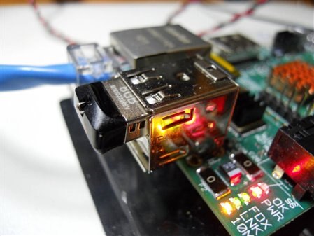

hi everyone, first post
i would like to run my pi as a linux, everywhere i look i'm being told to download onto an SD card but does anyone know if it would work if i download it straight to USB?
i always thought USB was faster than SD card

    Yes you can run it off USB and yes USB is faster. But then you have a thumb drive sticking out the side of your Pi and taking up one of the USB slots. SD is seen as a more practicle option in this case.
  • jamodio
    jamodio over 13 years ago in reply to Former Member
    I'm getting a pair of these to test, it won't stick out.
    http://www.amazon.com/SanDisk-Cruzer-Flash-Drive-SDCZ33-016G-B35/dp/B005FYNSZA
    I'll let you know if they work.
  • jamodio
    jamodio over 13 years ago in reply to jamodio
    The little USB drives arrived yesterday, just had a chance to test one of them (8GB) ...
    As you can see it is very small and does not stick out too much.

    No problems doing fdisk and creating an ext4 file system, I'll copy the root fs and see what happens ...
    I'll also test the 16GB version later.

    Everthing seems to be working fine with the SanDisk USB drive (8GB) mounted as root and an old 256MB microSD card I used for just the boot partition.

    I'm expecting some of the microSD-SD adapters from Adafruit, with that one and the boot on the microSD almost nothing will be sticking out on the sides of the board (remember that I'm powering the Rpi directly from the P1 connector.)
