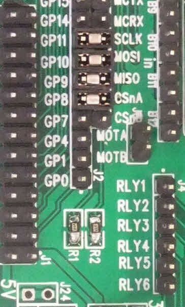

Well this is amusing.. Whilst attempting to solder one of the grains of sand in the kit,  I've managed to burn a couple of surfacemount pads on the board  image.  It's on one of the resistors,  I think I had the iron way to hot.
I was wondering ( hoping )  if anyone could advise on a way to fix it..

    A photo would help show the situation, but generally you can fix this sort of thing by adding thin wires to replace any destroyed traces.  Usually the best wire is solid AWG 30 with kynar insulation, which old timers still refer to as "wire-wrap wire".

    It's the R1 pads, both of them, rather than the view above,, I have two brown marks where the pads used to be..
    I have invested in a decent iron since..lol
    I'll try and pick up some of the AWG30 and have a go at a repair.

    According to the Gertboard schematic from rev 1.0 of the Gertboard User Manual, R1 and R2 are both pull-ups to +3.3V.  So I think you can just connect the labeled ends of R1 and R2 using a short non-insulated jumper wire.  For the other end of R1, you could scrape the solder resist off the diagonal trace and solder a short bare wire to the exposed trace.  You'll need a sharp X-acto knife or equivalent and stop scraping as soon as you see metal.  Then pre-tin the trace by heating it up with your soldering iron while melting solder onto the trace.  This makes it much easier to solder the actual wire to R1.  Be careful not to short to the copper fill beside the trace.
    You could also make the repair on the back side of the board, soldering one end of R1 to the through-hole pin it's supposed to pull up (J11 pin 4) and solder an insulated wire to +3.3V (J7 pin 2) from the other end of R1.

    just a thought.....  could I use a standard 10K resistor in place of the SMT one?

    ash068 wrote:
    just a thought.....  could I use a standard [axial] 10K resistor in place of the SMT one?
    Sure, totally.  1/8 watt is a good size for a 10K pull-up to 3.3V, though it doesn't hurt to go larger.  You can strip the insulation off some spare wire and put it over the resistor axial leads.  You'll want to put it on the back side of the Gertboard.
