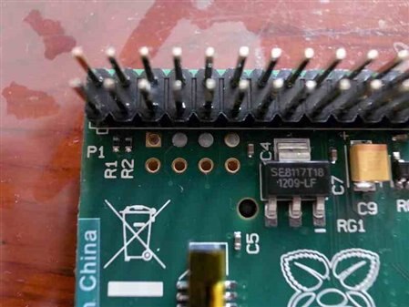

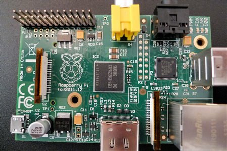

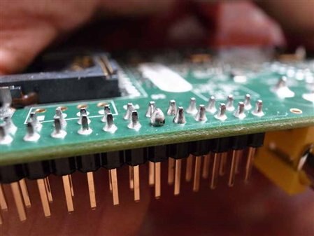

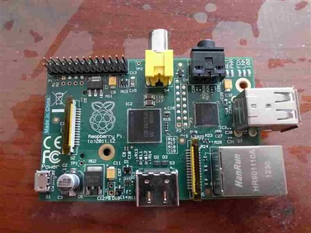

I received raspberry pi rev B 512MB Made in China last week,unlike the neat board made in the UK and I feel quite disappoint about it,
this is mine
and below is how it looks
the pcb was remarked as Made In China
And this! the p5 pin holes was filled with solder, which will make me a lot of trouble soldering pins
And so as the jtag pins...
Look this,a big tin ball on pin...I cannot imagine how they made it...
the same solder work on the usb ports
Just some complain,  I will not be pleasure to receive such a junk.

    If it wasn't for the fact it is an official board I'd have thought from those pictures it was a knock off.  Mind you I deal with power supplies for a commercial LCD monitors and the soldering work on them is often shoddy.
    They could at least have cleaned the board.

    On top of your findings add that it seems to be populated with knock off cheaper components like the voltage regulators that on the prototype boars and the ones produced in the UK are from ON Semiconductor, on the ones made in China are from some Chinese knock off company.
    Also the detail of a piece of pcb cut to be put on top with the silk screen saying "Made in China" looks really ugly.

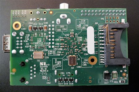

    Just a quick note for people expecting theirs from RS.
    My 512MB RS one came today, a long time arriving, but on-time based on their original estimate.
    It shipped in a plastic reusable storage case, which was nice of them, plus a 1-sheet quick-start guide.
    I've compared with a 256MB 'with 2 holes' version from Farnell and a 256MB 'forgot holes' version (original) from Tandy.
    I'm guessing the wave solder screen includes the JTAG/test pins, but that is ok (I don't think anyone will have a
    JTAG device that works with Broadcom). Or maybe different factories have different methods for the connectors, etc.
    To summarize, they seem ok. The Farnell one did arrive quickly, but the RS one is fine too.
    Pics of the RS one below.

    I got mine in the purple box from RS
    Ordered in August. Look exactly like zidane ma's (first pictures) with the soldered holes image
    Are the soldered holes normal?
