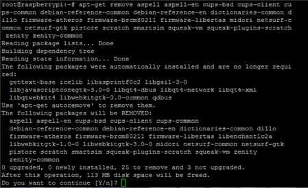

I just re-image my 2GB SD card which I have been using for ages and have re-imaged and installed all the software that I require before, has just produces an error message durring 'apt-get install program1...program32' (fill in the spaces) that I have NO SPACE ON SD CARD.
I have never seen this before with previous images.  Can anyone tell me what is new on the SD card that would be taking up all that precious free space? (new from OCT image?)
The apt-get install about is for 225mb of stuff that I use.  I have never had a problem installing all of that and then un-installing programs I don't need from there.  I remeber on the first image back in May/June, there was 311Mb of free space without un-installing or installing any programs... what has happened?

    I think they added the pishop program. It might be worth removing that (if I am right).
    Some of the log files can also take a lot of space. You might check the /var/log folder. Just don't delete any of those files, simply make their length zero. (Some stuff is having problems if the log files don't exist anymore.)
    Their probably is other bloatware. It might be worth to have a list of all things that can be removed safely.

    I am compiling a list of software to un-install...

    Here we go... I have tested this command:
    apt-get remove aspell aspell-en cups-bsd cups-client cups-common debian-reference-common debian-reference-en dictionaries-common dillo firmware-atheros firmware-brcm80211 firmware-libertas midori netsurf-common netsurf-gtk pistore scratch smartsim squeak-vm squeak-plugins-scratch zenity zenity-common
    Which has removed all of these programs.
    with minimal issues (so far).  As above, this saves an initial 113 MB.  I will tell you want autoremove does in due course.
    EDIT:
    EDIT 2:
    Here is results from apt-get autoremove:
    Total space save thus far: 113MB + 44.4MB = 157.4MB  image

    Just FYI per file properties,
    2012-10-28 raspbian image 1939865600 bytes
    2012-12-16 raspbian image 1939865600 bytes
    After first installing it on a 2 GB SD card I have always used at least 4 GB cards since then  (this is what is suggested on the RPF downloads page)
    after also experiencing problems using apt-get. The ~ 198 MB left over on a 2 GB install is cutting it way too close if you plan to do any expansion
    of the base setup at all.
